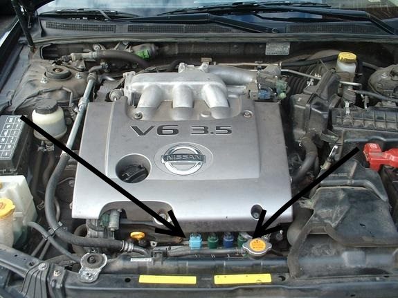

Can someone tell me if the rear motor mount come optional with electronic on 2003 GLE auto? I just check and I do not see any wire coming out of the rear mount but that front has a wire harness coming out. I thought both are electronic control.
Can someone verify that the rear mount support to be wired and maybe the last owner replace it with a regular mount?
TIA

The connector is in the front of the car where the connectors are for the rear o2 sensors etc

Only the front mount is electric. I would look into a motor mount test to see if its bad.

^^^ what he said. The 2000 & 01 had 2 electric mounts and the 2002 & 03 only had one.

I can see the front mount going to a brown connector, can't see the rear one.
The rear do come with electric, not sure if that an option.
This make more sense.
