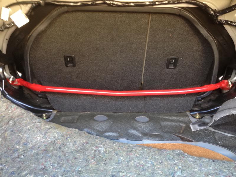

I saw the ultra racing RTSB. They mount to the gussets instead of directly to the suspension mount plate. You want to mount it directly to the suspension mount plates to trasnfer the load effectevely. Even then this RTSB didn't do anything, especially when you already have RSB. Save your money IMO.
I made my own from scrap metals.
