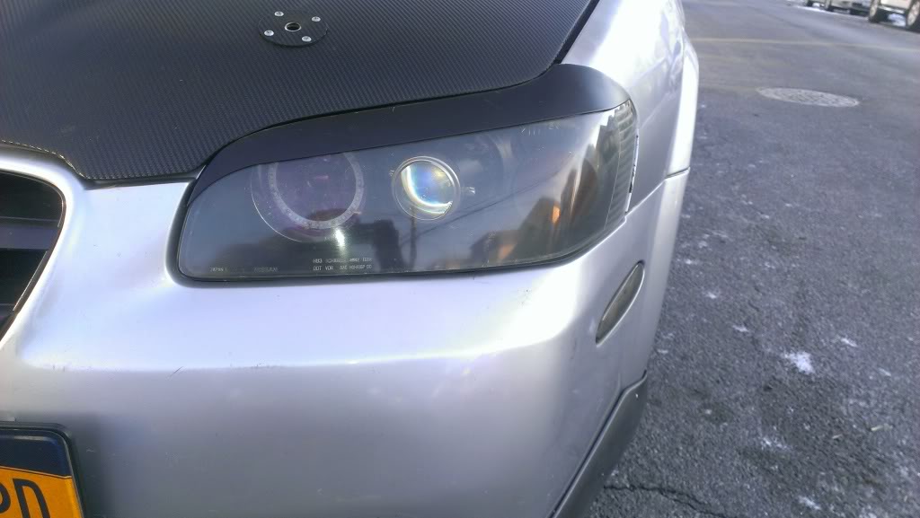

Theretrofitsource.com is where i got my stuff
