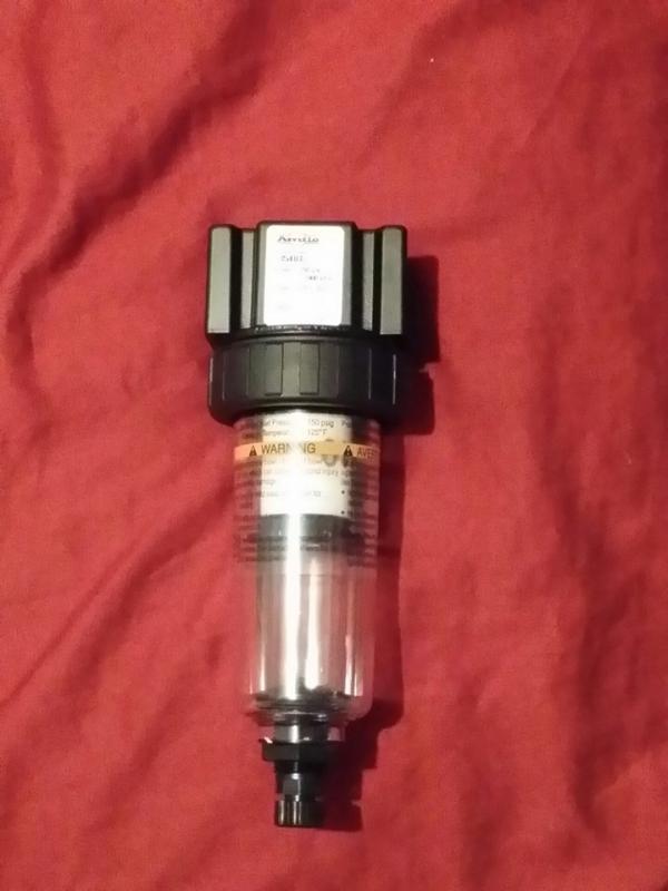

This one is my temp one for now, I really don't want one of those fancy ones
Fittings are on, just waiting to change my plugs.

Wow. Mine would have to be emptied twice a week if I used something that small. That's in using it on the left/front valve cover. Yup, should probably do a compression test next time I'm messing around the bay.
A test I did on Maine was to just put a couple breather filters on the valve covers. Both oil saturated in roughly a months time. One on front valve cover was dripping oil. I could also smell the oil. Definately going for TWO catch cans myself.
