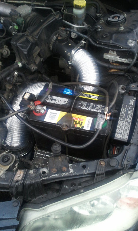

your mom is gonna be pissed when she finds out what you did to her dryer.
B*tch.
