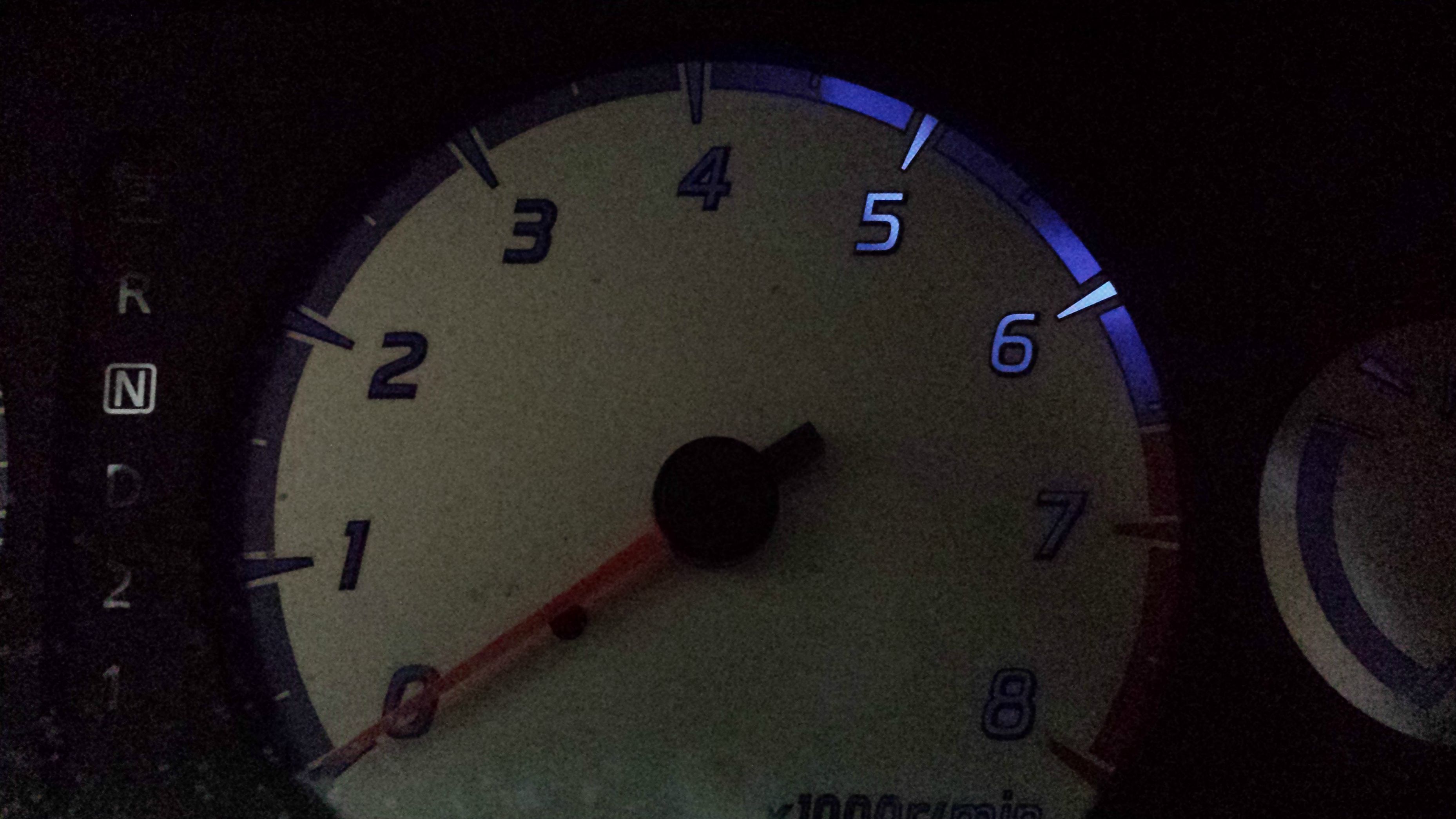

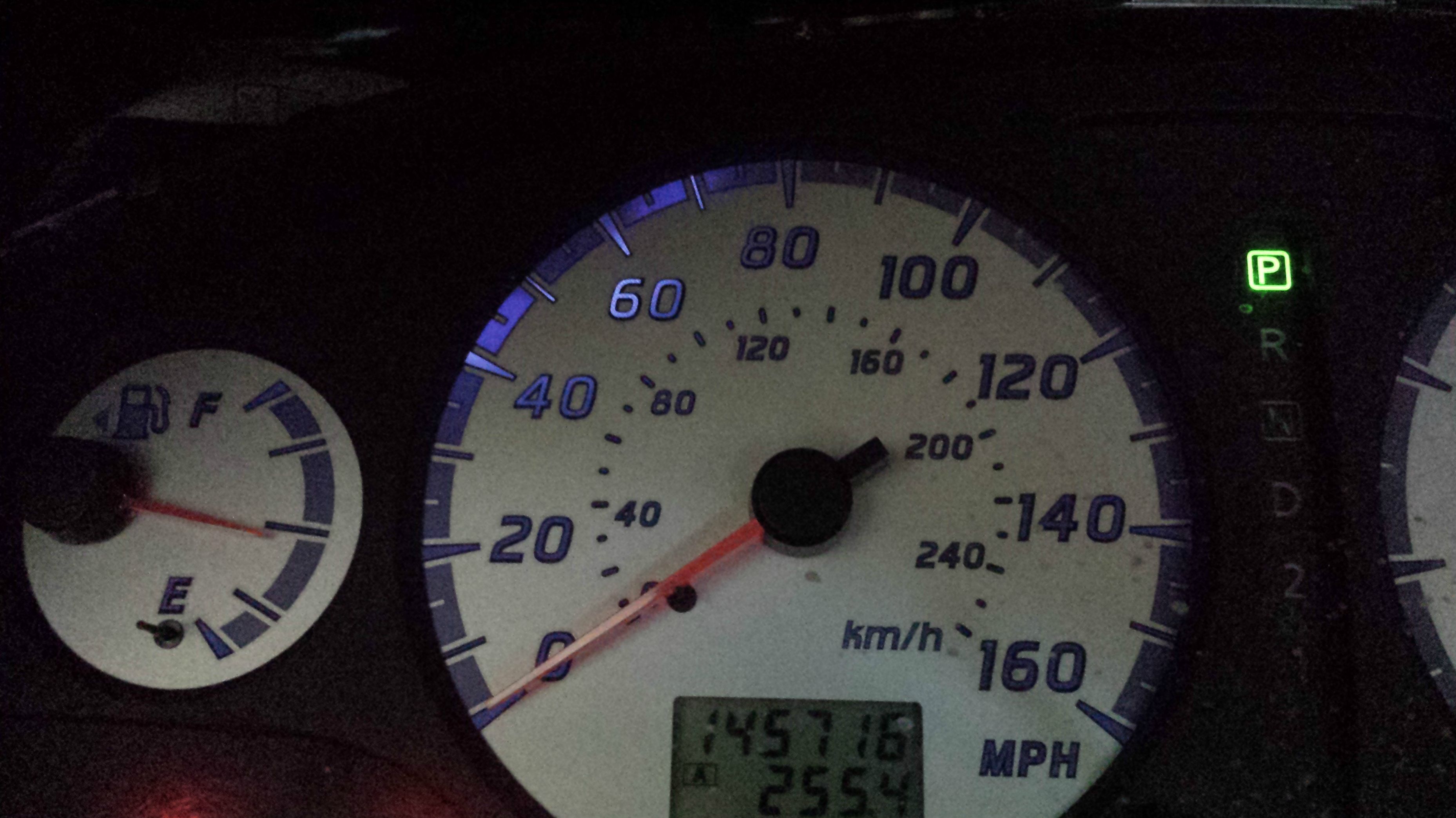

How to fix? I got new LED's and installed them. They're pretty dim, just a bit bluer than before. They are brighter in other areas but this problem was also present with the stock bulbs, theyre a lot more pronounced now. It looks like the bulbs are off in some areas but they arent.

welcome to hotspots!
The way to minimize them is to get better quality, brighter LEDs that have 360* directionality, or to get custom LEDs made..member "Shinjiduo" makes custom sets for that gen maxima I still believe.

I can help you out. The reality is you either need multidirectional LEDs or 360 degree emission LEDs. 360 Degree LEDs are better because they operate exactly the same as the incandescent bulbs that were there to start. However, multi-directional LEDs are easier to find. Some examples of my work-
