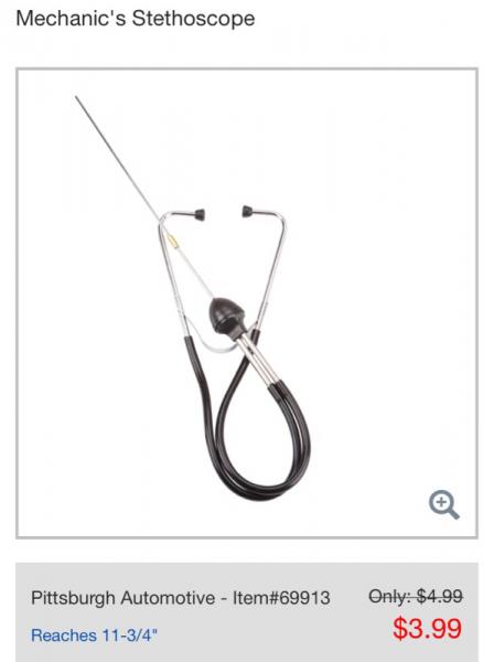

How about alternator whine as a possible suspect as well. Sometimes they make strange sounds on their way to the scrap heap. Also, I've mentioned this before in other threads but this item here has saved me from numerous headaches locating strange noises. Get one and you'll save 90% of all guesswork. Harbor Freight : mechanics stethoscope $3.99
