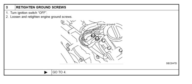

Old Oct 27, 2014 | 07:55 PM
george__'s Avatar
Posts: 4,230
From: Earth

Old Oct 27, 2014 | 08:47 PM
Aviation005's Avatar
Joined: May 2011
Posts: 211
Thank you. Got an eBay mass airflow sensor coming.. Hope it works.
