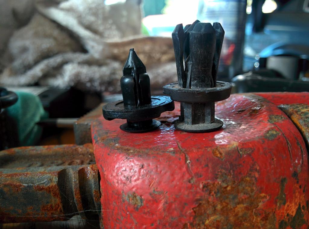

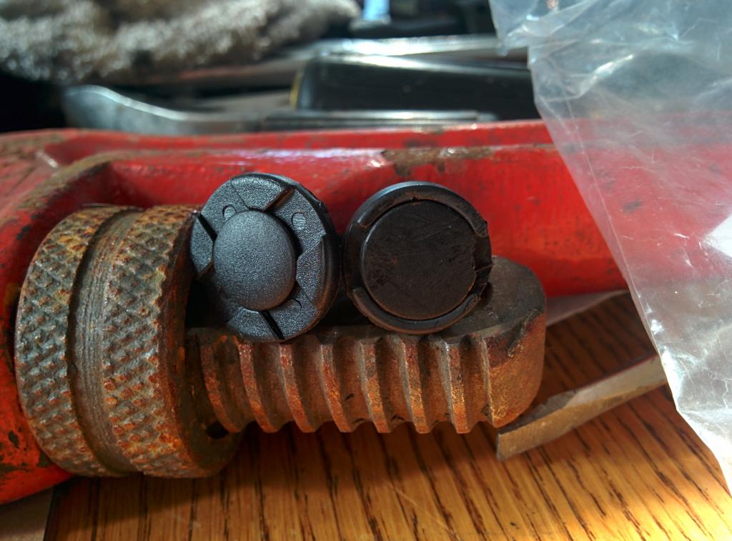

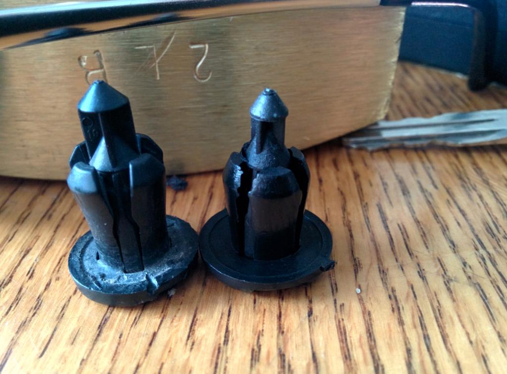

I ordered these.
Are you guys suuuuure that's the correct size?
I just got these but they sent me the wrong size...
Even if they were the right size they still seem too small..
But at least they fit my snorkel so that's a plus.

Oh I thought you ment the splash shields in the wheel well. The ones you looking for are the splash shields for the motor. That's a different size. Check out the link above those will fit.

that 1mm really makes a difference.
Trying to use that 7mm in a 8mm hole is like a hotdog down a hallway.
The stock ones are more like 19mm long, not 12mm like the ones in the link.
weird.
http://www.ebay.com/itm/25-High-Qual...73d99f&vxp=mtr
These look like the ticket right here.

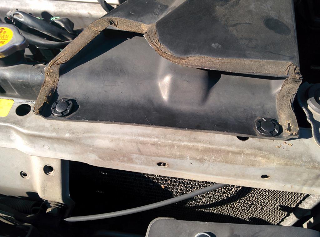

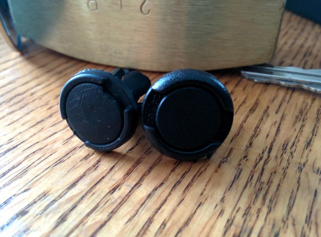

Actually the size is 10mm hole x 13mm stem.
For future searches because I'm pretty sure this is the only post about the size.
5bux for 40 on prime.. can't beat that.
Stock are 15mm stem it seams so there's a tiny bit amount of play, but these are perfect.
Clips the plastic sheets down tight. If I had a choice 10x13 is the perfect size.
