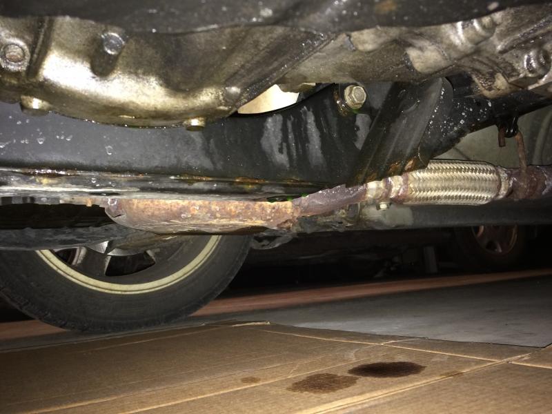

I have been searching for a similar problem to the one I am currently experiecing, but have not been able to find the exact same circumstance. I have read that people commonly have coolant leaking by the oil pan, most commonly meain the water pump seals are bad.
I am finding my leak to be on the other side of the cross member from the oil pan (between the cross member and tranny). I am unable to track the leak very far because it is very congested by there. The coolant is hitting the drive shaft and is dripping from thereto the cross member, and tranny.
I have attached a picture, taken from in front of the driver wheel.

Is your radiator leaking?
hose leaking?
water pump seal?
radiator cap?

I was unable to find any leaks in the radiator, cap or the hoses. I will inspect the water pump better tonight but upon initial observation it did not appear to be leaking.

Check the hard lines going to the block over by the intake. Maybe the gasket has failed.

get a pressure tester. my first guess is that it is oil cooler related.

Hooked up a pressure tester and found the leak. The water outlet gasket was leaking coolant.
