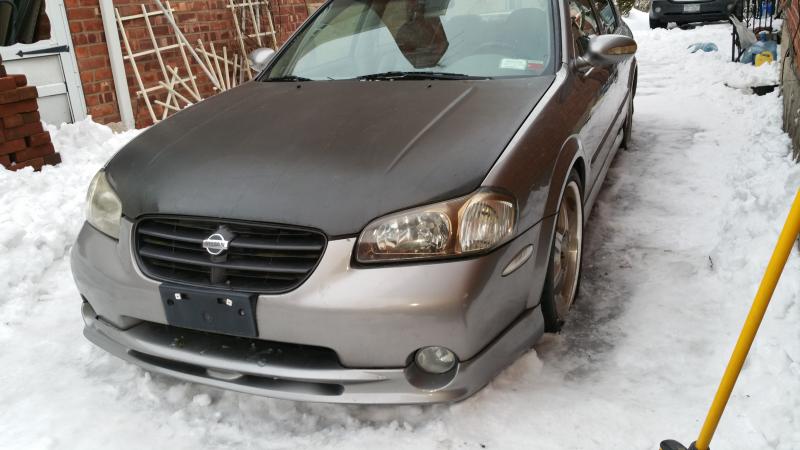

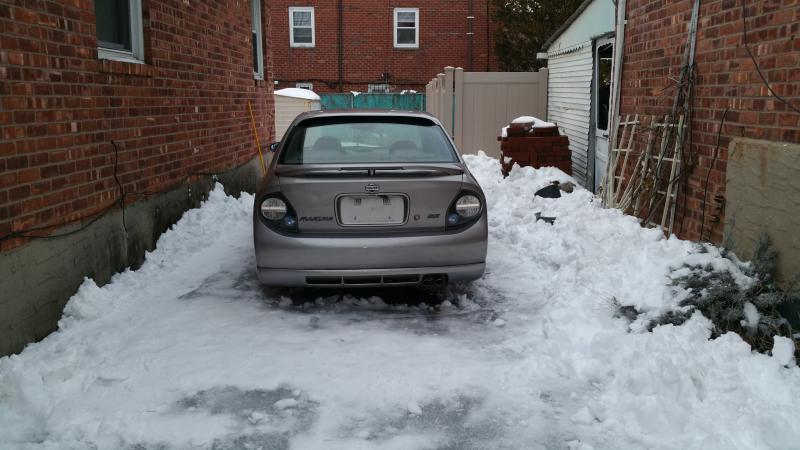

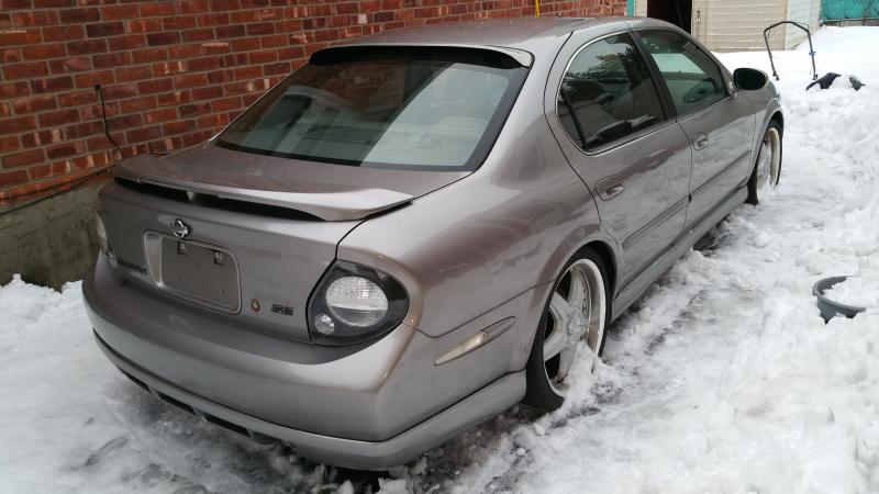

I wanted to keep everyone updated, so if somewhere down the line someone might be in my same position. Replaced the battery and the car started up fine. I will be giving it a tune up, and will replace the clutch along with a Luk flywheel part number:LFW266. I will be installing a Son XAV-68bt unit using a Metra 95-7516G dashkit and a Pac Reom Mis2, in order to maintain stock sound. Could anyone tell me if something about all this is conflicting? I'm pretty sure i found the right parts i need. Here are some pics of my soon to be new daily.The car has a carbon fiber hood, the pics dont show it lol
P.s i need your opinion, should I remove the rear lip kit? Idk if it seems to ricey.
Attached Thumbnails Maxima has been sitting for 2 years.-20150307_173344.jpg   Maxima has been sitting for 2 years.-20150307_173335.jpg   Maxima has been sitting for 2 years.-20150307_173312.jpg   Maxima has been sitting for 2 years.-20150307_173250.jpg
Old Mar 12, 2015 | 03:21 PM
Child_uv_KoRn's Avatar
Bad *** Newb
Posts: 4,975
nix the tails, too, and replace with the black '00 ones.
Old Mar 12, 2015 | 03:35 PM
Carguy1709's Avatar
Joined: Aug 2014
Posts: 73
From: Brampton Ontario, Canada
Change the tails to the 2000 se, like mentioned above^^. Tint the windows if its legal in your state, change the rims and itll look good, rear lip isnt to bad i have the same one 😜! Good Luck
