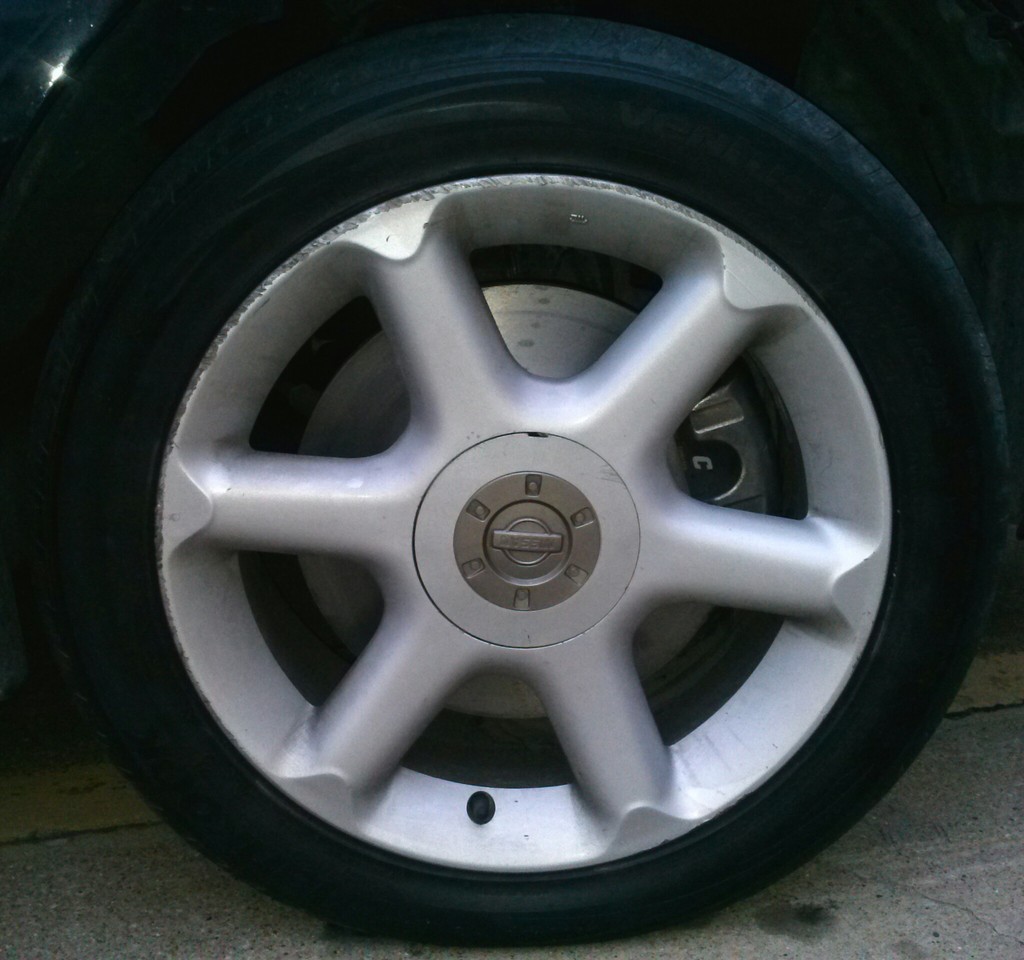

Size:  147.0 KBName:  CAM00653-1_zpsummek8of.jpg
