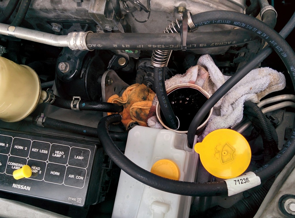

Pumping in action.

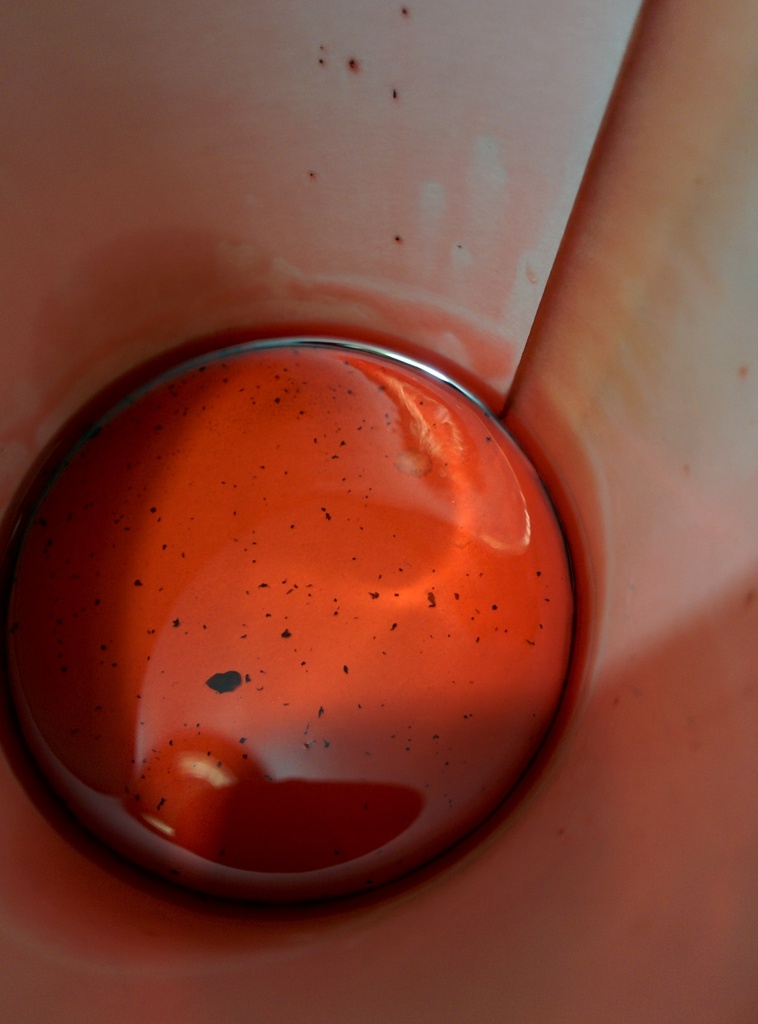

Plastic flakes.
In my opinion they are from the black plastic splash guard in the tank that
is breaking down slowly.

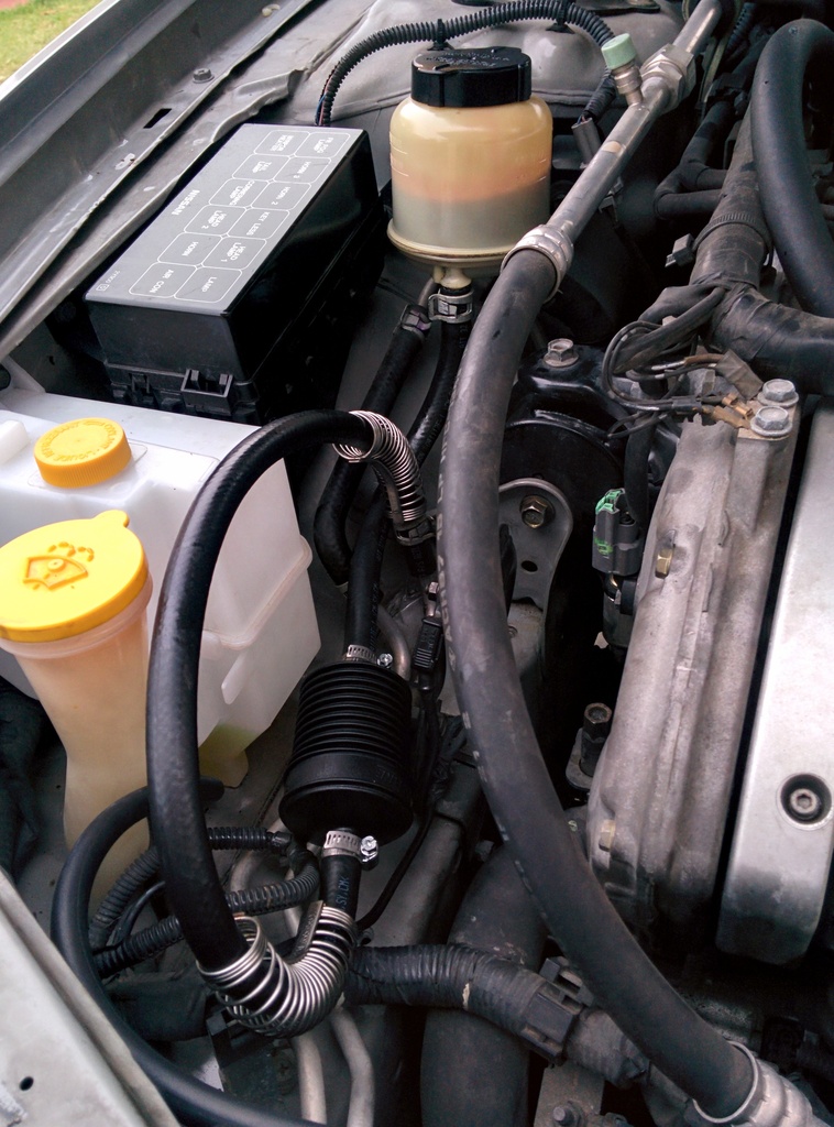

Put a filter magnafine on it to catch those plastic pieces.
Takes about 1.5 qts of amsoil. Lovely lovely amsoil.

Have the front up on jacks.
With the engine off just turn the wheel lock 2 lock really fast
All the fluid will pump out just like that real quick.
Hook it back up, put in like 1qt, and turn the wheel to suck it all down.
then you push it out again and should be flushed with new stuff.

Ok, but which hose did you disconnect?
I assume the fluid will "pump out" through the disconnected hose - you did not use a turkey baster, right?

Empty the tank first it's like a 1/2 qt.
Smallest line going to the tank. Just disconnect the hose from the hardline and use a 3/8th hose on that. Look at the pic.
Turkey baster is not a good tool to use.
It'll take a long time and make a mess.
http://www.harborfreight.com/multi-u...ump-66418.html
Cheap, sucked it out in acouple of pumps.

SquidBeak's Avatar
Joined: Jan 2002
Posts: 235
What are those strain relief springs that you used?
> They're Gates Unicoils
