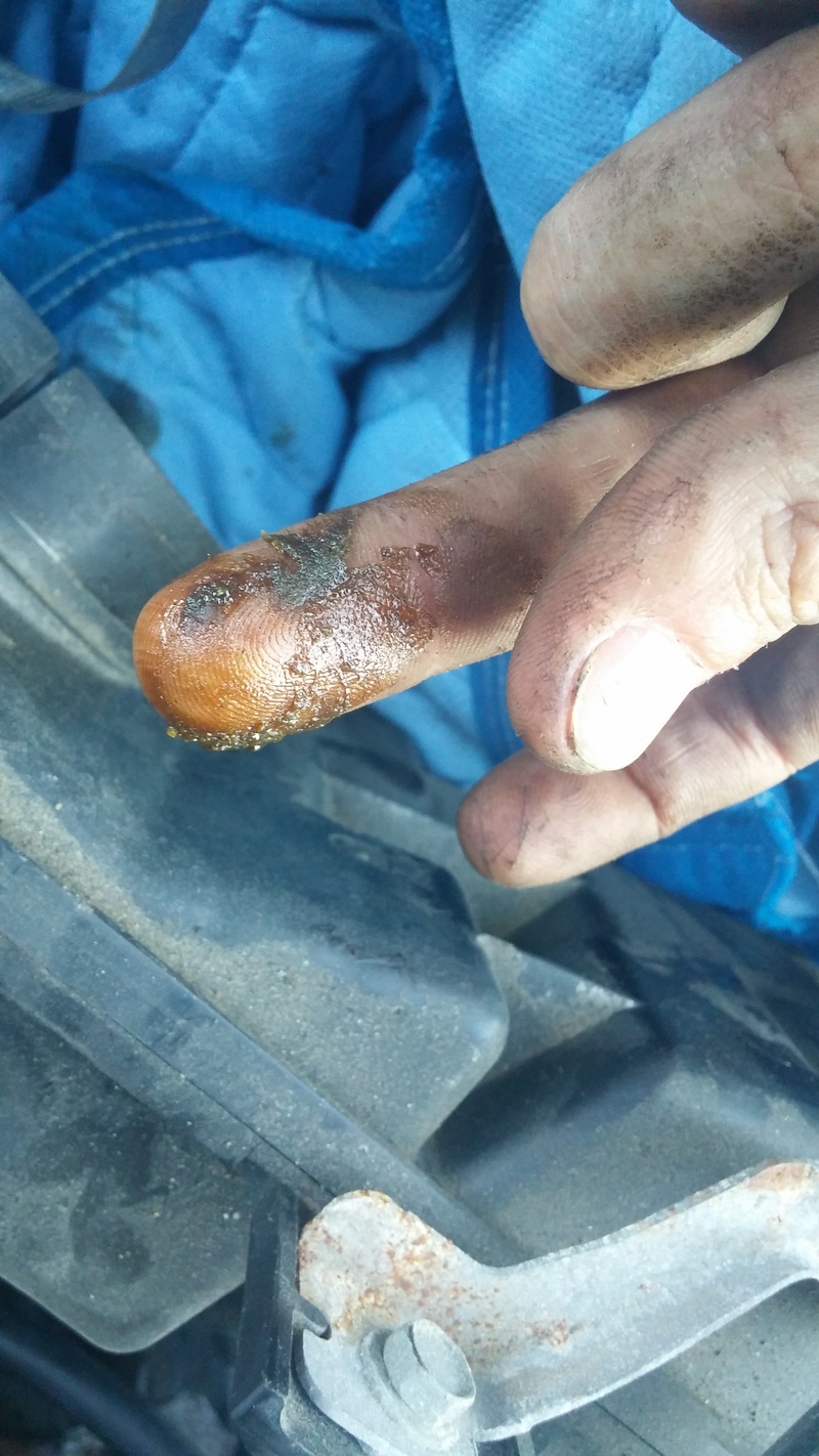

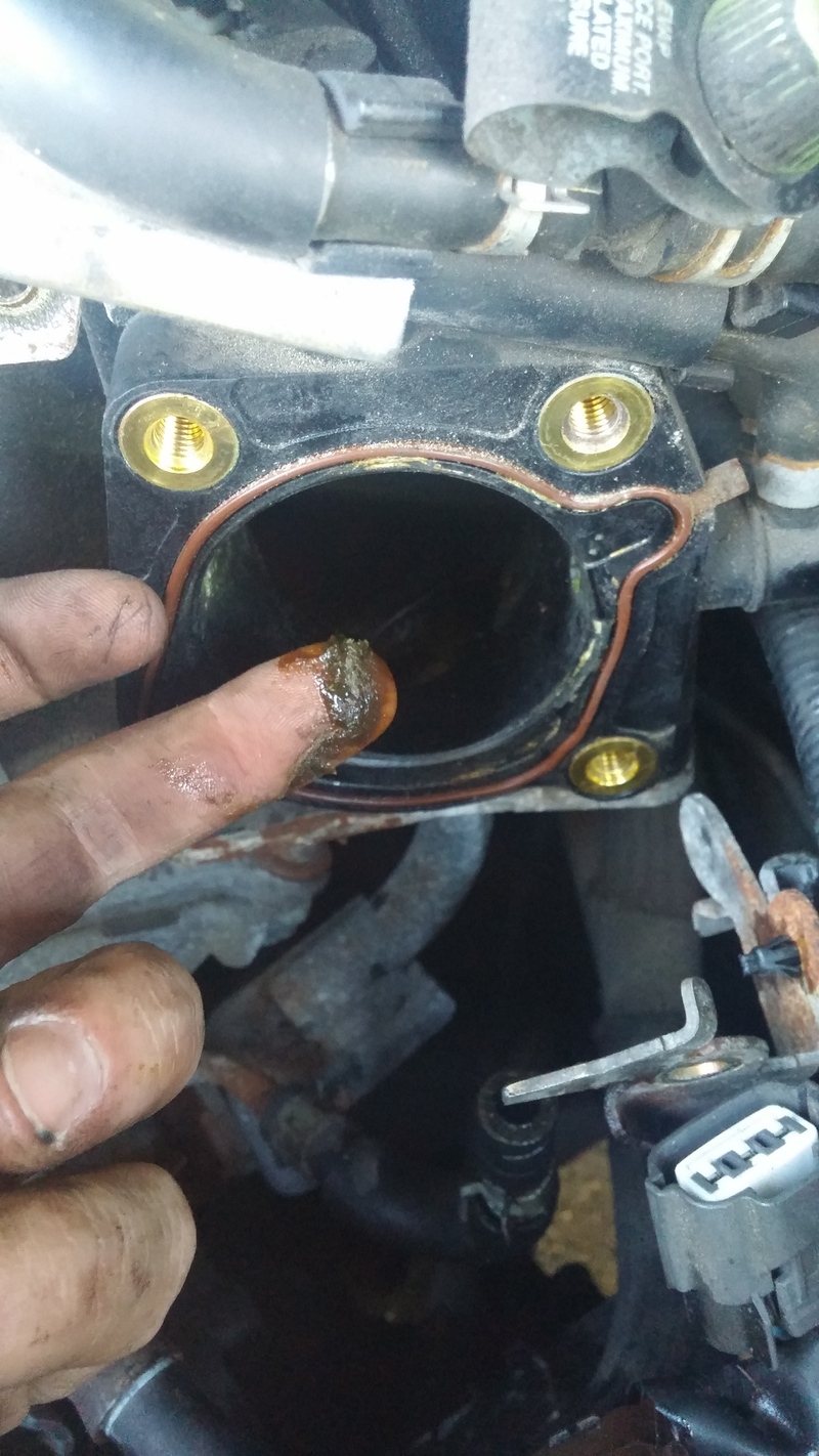

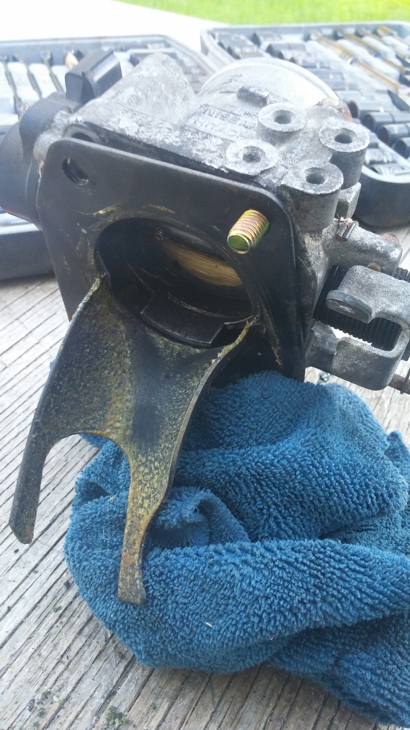

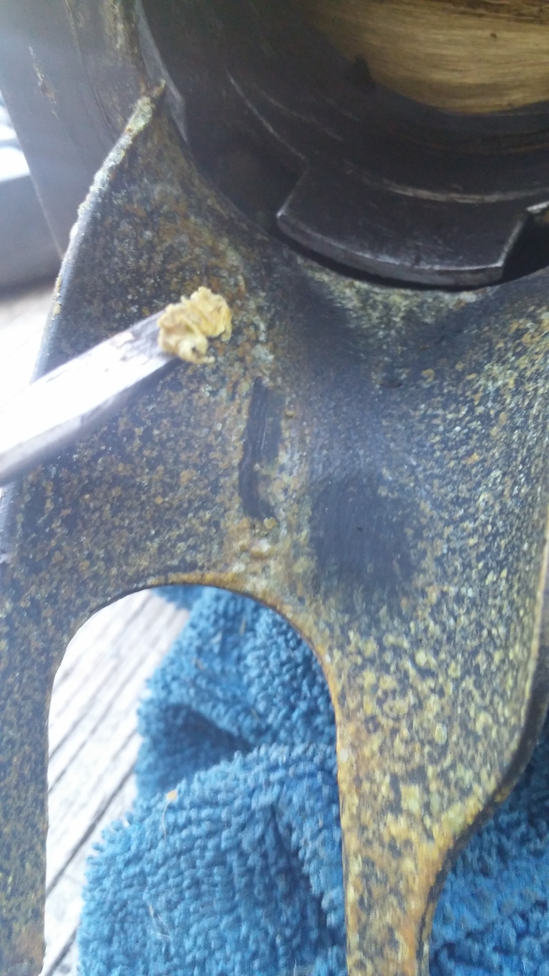

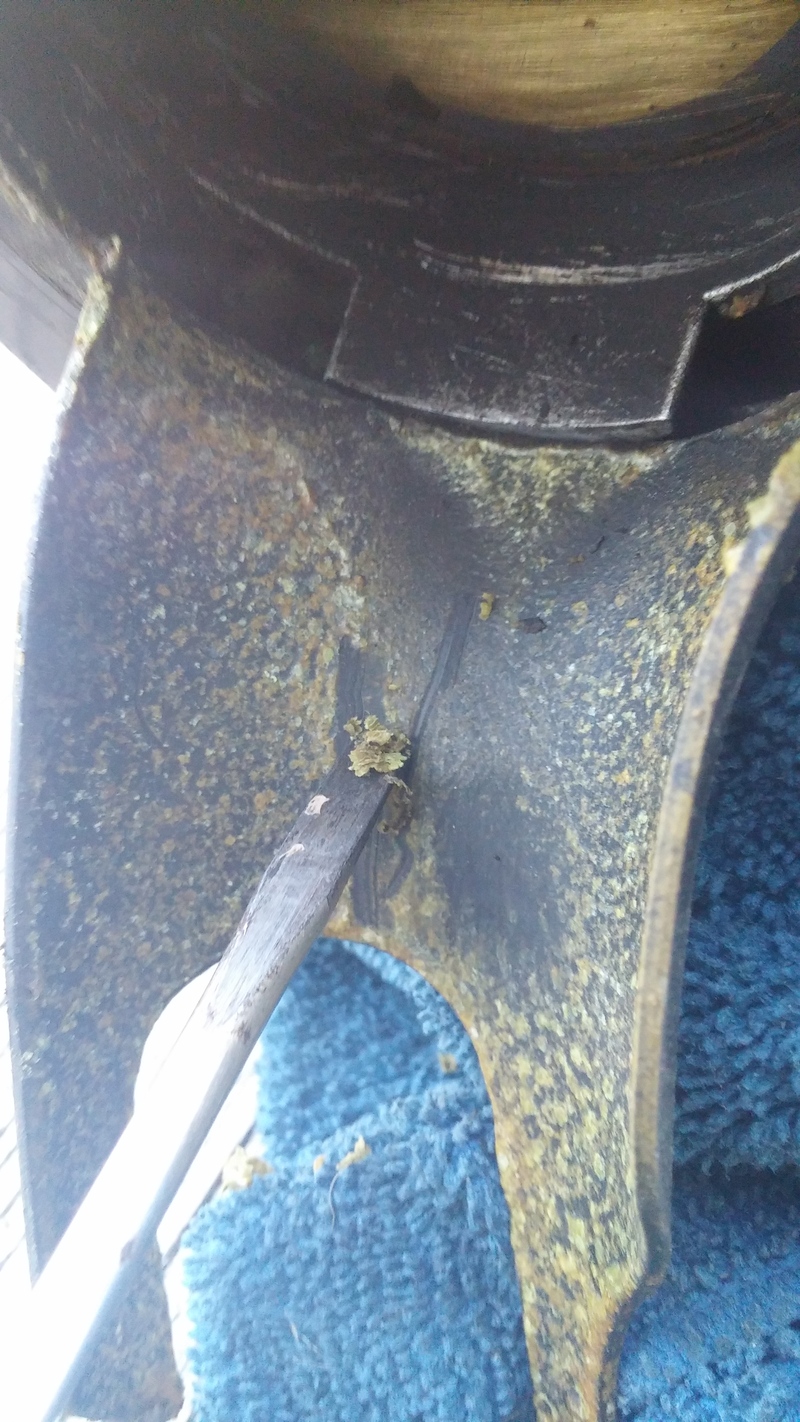

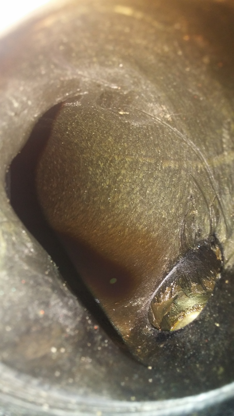

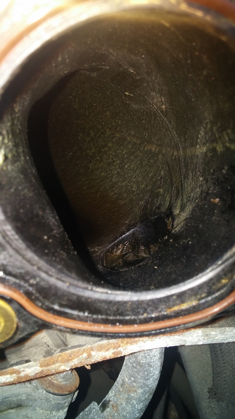

lol, so i checked out what i could with the iacv as you suggested. it looked ok, i tested the ohms and got 23 across the pins. I plugged it in and cycled the key to test plundger movement, which also looked ok.. I do not have a p0505 code. do you figure i should just replace it anyway?
on a side note, just past the throttle body i found a lot of wax / grease? what could that be?
