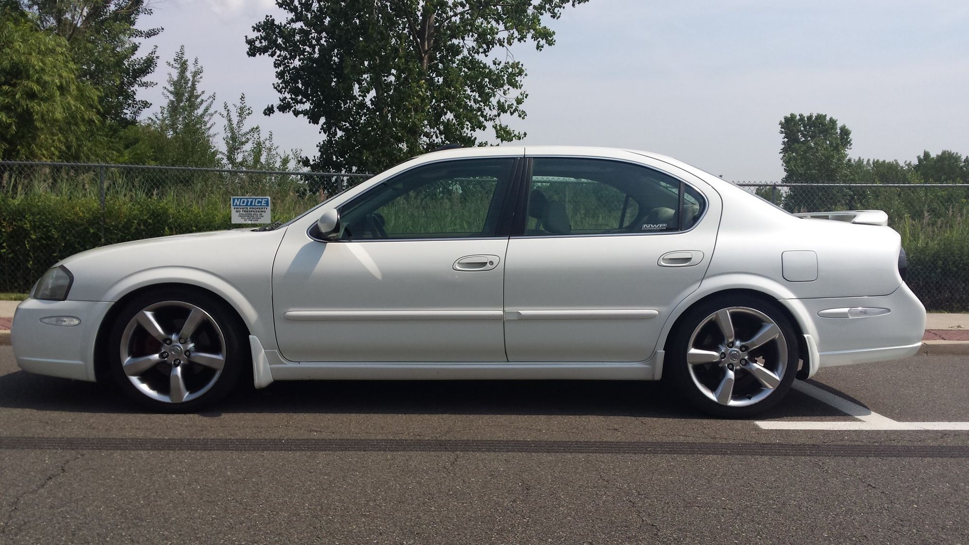

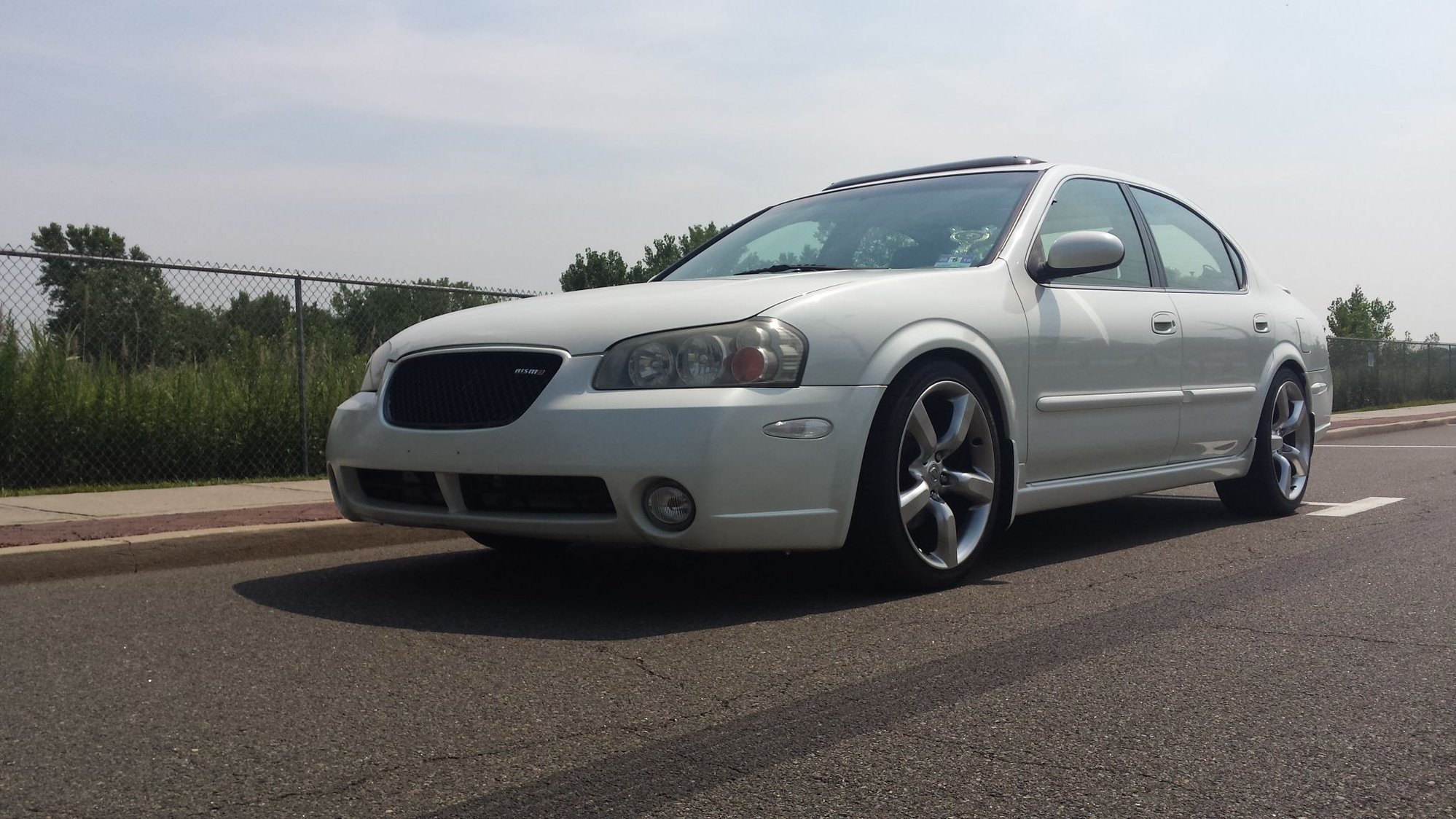

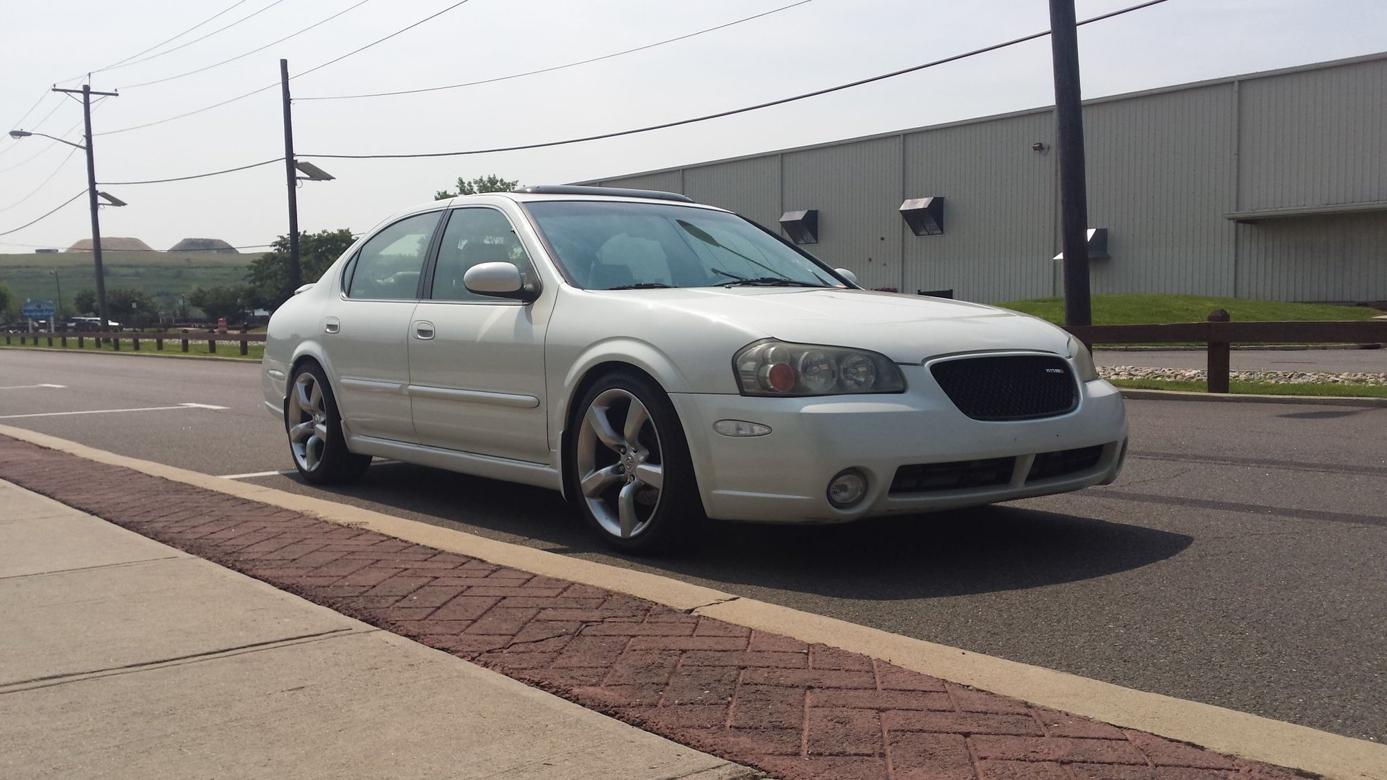

Jul 10, 2015 | 05:18 PM
So I ended up putting the 225 tires on the front, buying 235s for the rear, and putting on 15mm rear spacers. Also dropped the front a tad more than it already was...
Drove it a few days like that and the rear tires would hit on bigger bumps....
Well, I had to get that nasty rust repaired around the rear wheel wells, so I figured let me do that first then see about fender rolling...
So I explained my situation to the body shop, and they fixed the rust and also fabbed up the new metal pieces around the wheels to have a nice, smooth (not sharp) lipless rear wheel well... so today I drove it home (and drove it hard to ensure the wheels were clearing)... and it seems fine...
I'll take pics tomorrow after washing...
Jul 13, 2015 | 05:41 AM
Jul 13, 2015 | 05:50 AM
