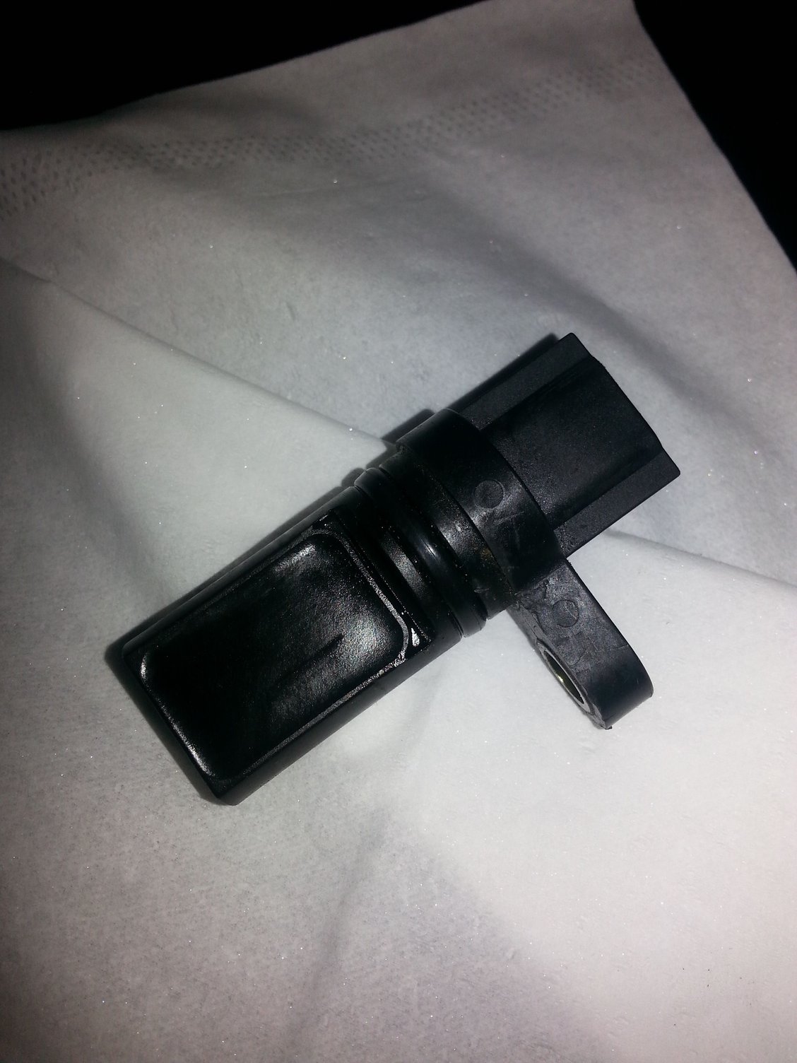

Here's some pictures of my Camshaft sensor bank 1, Does it look bad?

Please, search. The IVT solenoid is dirty. It's a common issue.

Seafoam does not cause ill effect on anything to the car. However that code you have, depends on which cam sensor since you have two of them, one in the front and the second one, gonna be a pain to find it in the rear side of the engine, if I remember seeing it, on the driver side of the rear side. I could be wrong.

The title implies to most of us anyway that the IGN timing is off, which really isn't a problem or your problem, just lack of power. Your issue is with the IVT.
Did you ever try removing and cleaning the sensors?

Yup, I took off the plenum and cleaned the bank 1 and bank 2 IVT soleniods.
My cam sensors had a lil' bit of sludge on them not much tho.
But I got my power back and no check engine light.
