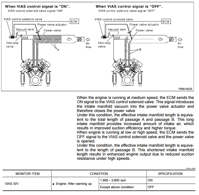

Originally Posted by foodmanry
Sounds like a bad power valve. It is a valve for the variable intake. They are made of plastic and sometimes the end point that connects it to the solenoid breaks off. When this happens the solenoid activates to open the long runners in the intake (I think around 3500 RPM) for more top end power. But if it's broken the valve never opens and stays on the short runner intake.
You can check this by removing the power valve solenoid assembly. Be careful as those Phillips screws are very very soft. I changed mine over to Allen wrench screws.
Close. The VIAS is always open unless the engine is between 1800 and 3600 RPM. Here's some info from the FSM:

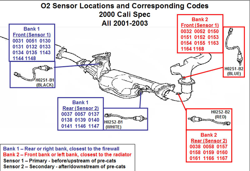

Old Oct 28, 2015 | 08:50 PM
george__'s Avatar
Posts: 4,230
From: Earth
o2 sensor is rear one so doesn't affect A/F ratio
