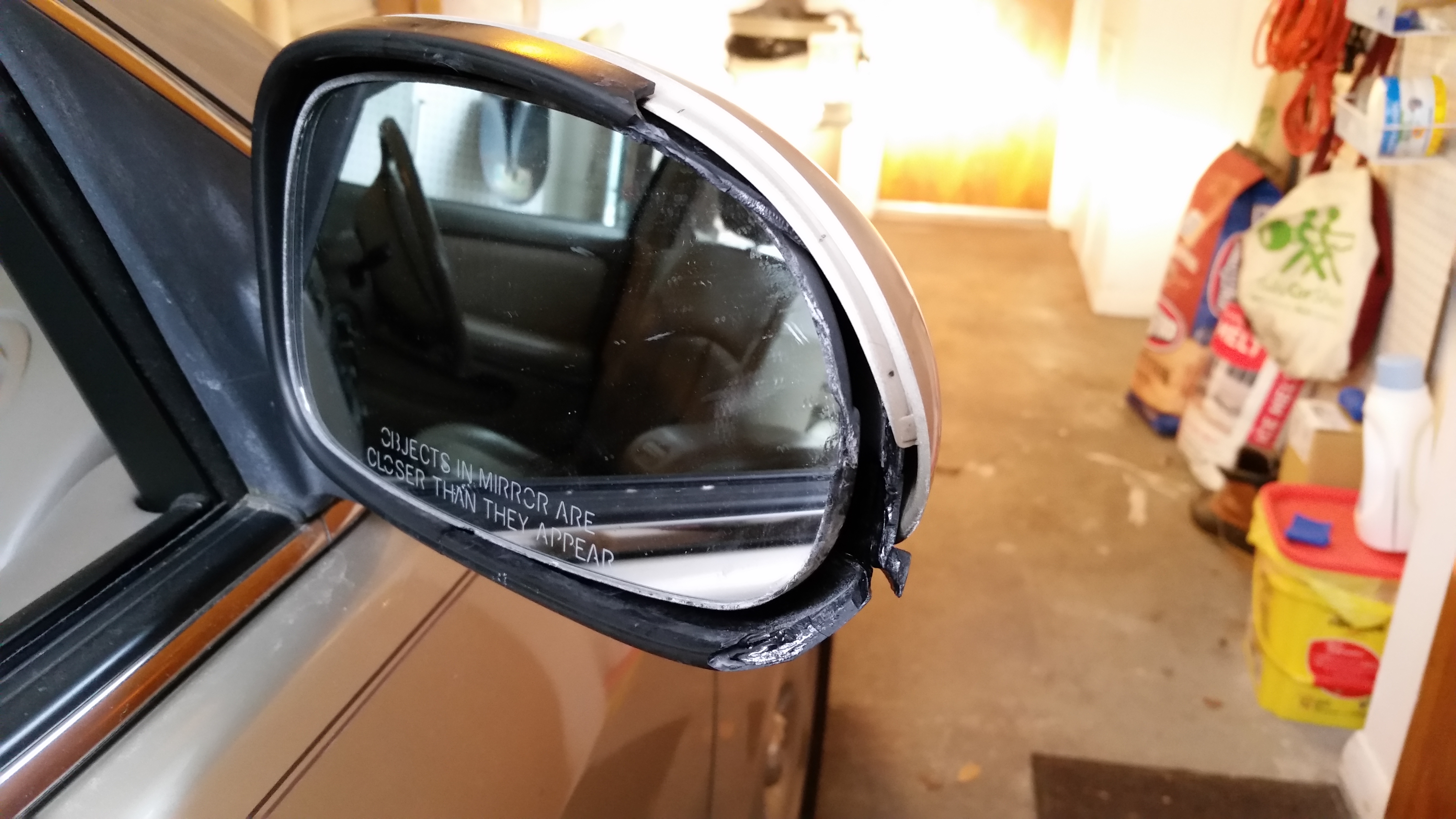

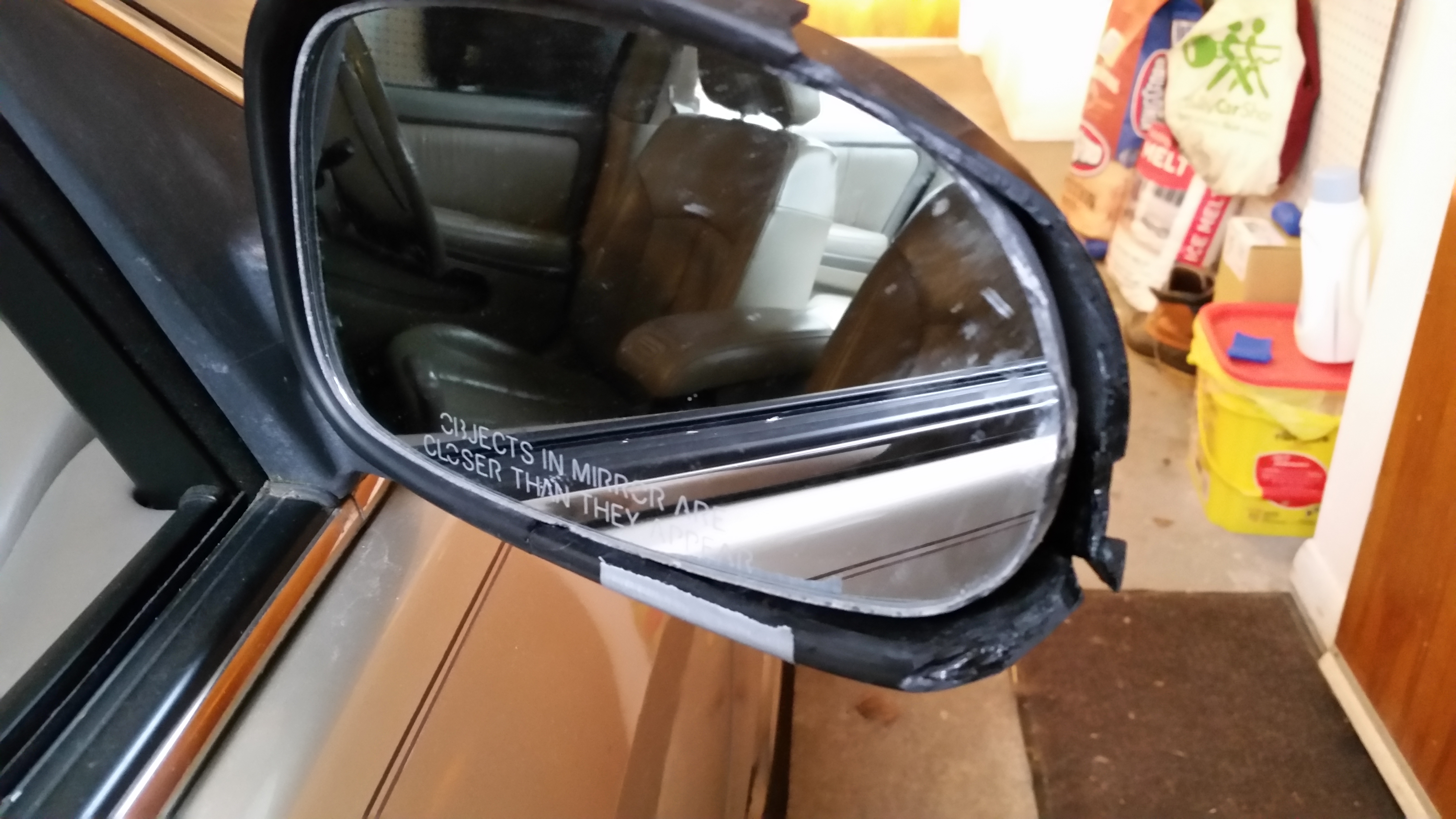

Dumb me was backing out of my garage and I clipped the black plastic housing of the mirror on the side of the garage
Fortunately the mirror swiveled back a bit preventing it from being totally destroyed. But, the black plastic housing broke in a few places and I was not able to super glue all the pieces back together, but did the best I could. The mirror operates fine and while I can super glue the gold trim piece back on (I put it on for the picture but did not glue it), because I could not utilize all the broken pieces, as you can see, there will be a gap.
I watched a YouTube on replacing the passenger side mirror and it is more than I can handle. And since the after market trim piece mirror comes in black, I would need to get it painted tan/gold like the current one which matches the color of the car.
My question is, since the only problem is the housing, can just the housing piece be purchased and changed (easily)? If not, I am leaning toward super gluing the tan/gold back on and calling it a day. It would than look like the picture.
Your thoughts would be greatly appreciated.
Thanks!
Anovice

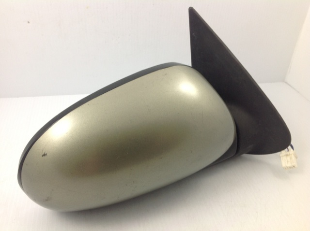

I found a non-heated 2000 I30 passenger side mirror on Ebay for $36, including tax and shipping, that I will purchase (see picture). My tan/gold (EVO is the Infiniti color) plastic cover is in better condition (it did not break when I clipped the side of the garage), so I will remove the cover from the mirror I purchase and replace it with my cover.
Thanks for all your help!!
Anovice
