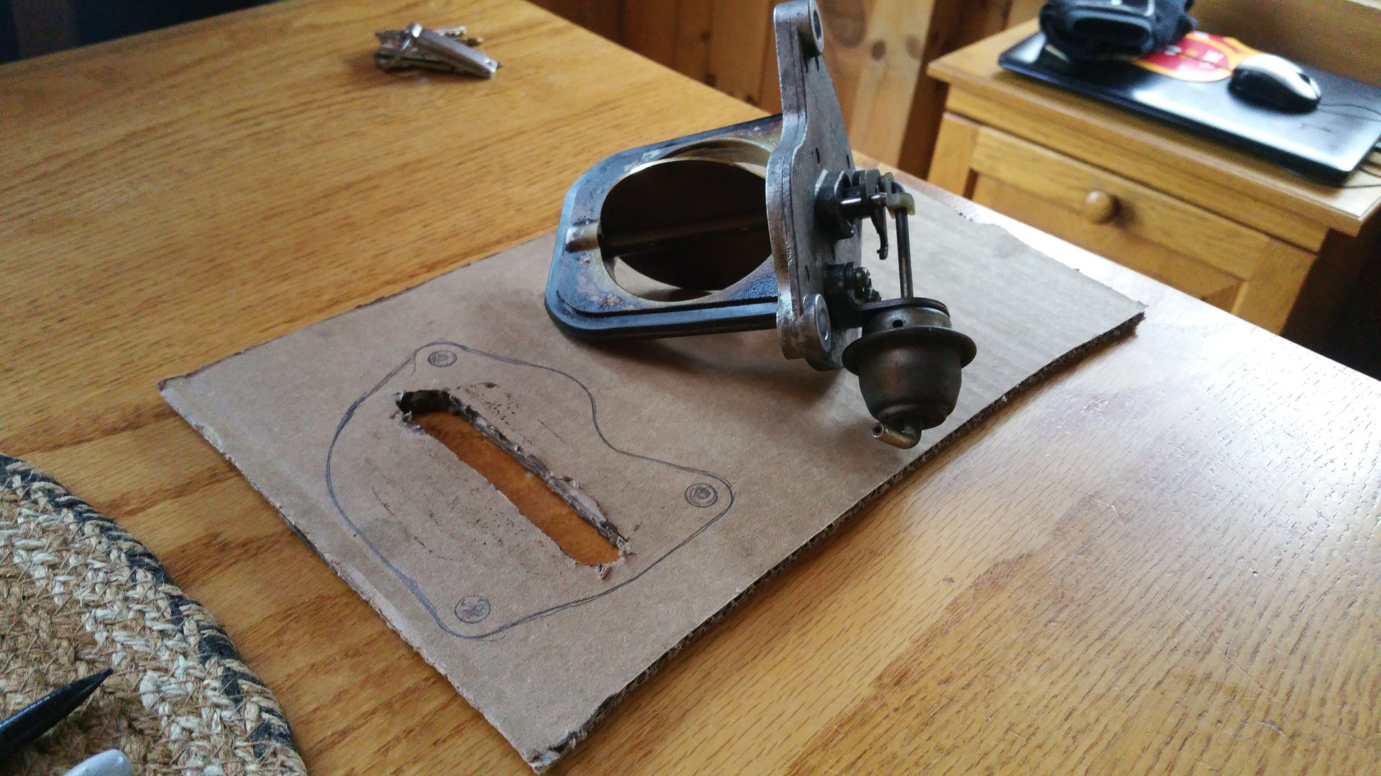

Since I had the extra metal lying around and wanted to try my hand at making something myself, here's how I went about doing my custom block off plate:
1) Traced the shape using a cardboard template:

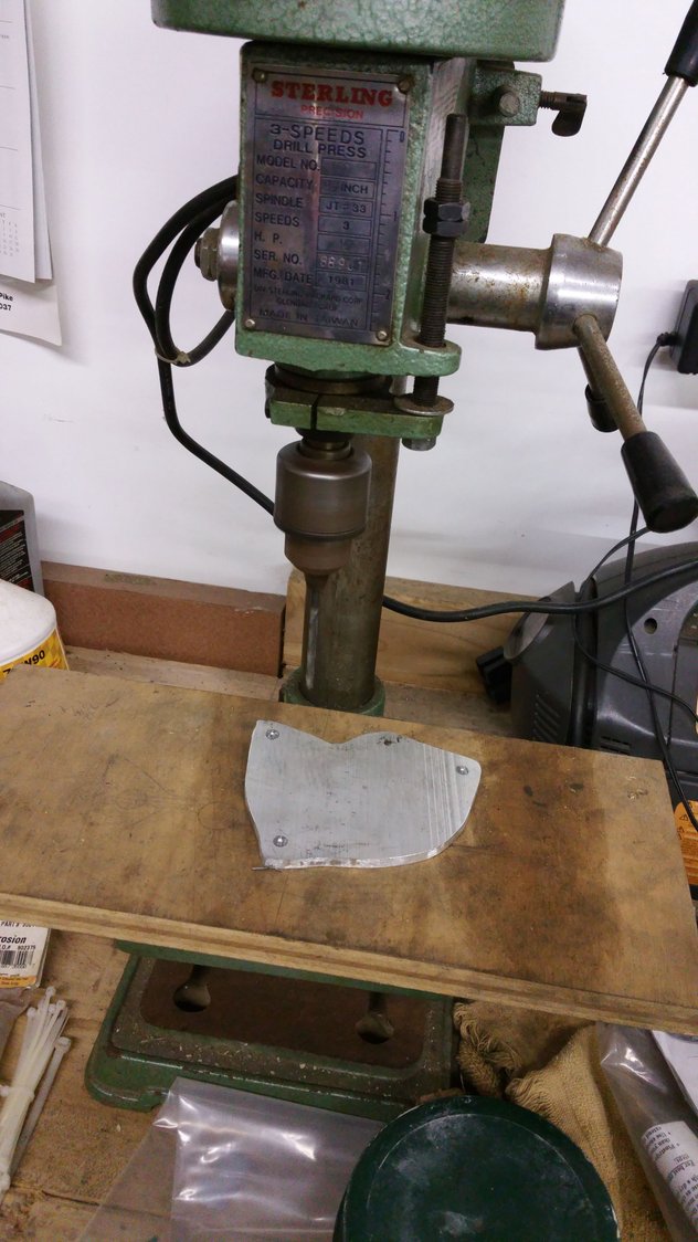

2) Had this aluminum laying around, which happened to be the perfect thickness:
3) Traced the template on to the Aluminum, cut it out using a jig saw and cleaned it up. Drilled the holes using a drill press and polished it up a little bit and viola new BOP!
