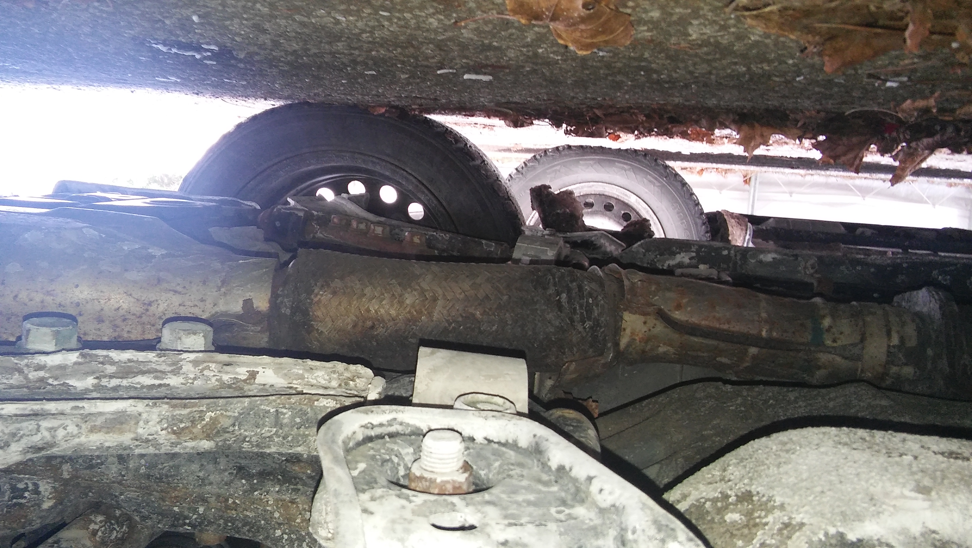

also a picture under my car (flexible broken)
Attached Thumbnails downpipe flexible is dead.....new downpipe-ypipe004.jpg   downpipe flexible is dead.....new downpipe-20160212_132506.jpg

You should be able to get a new flexpipe for cheap at any muffler place. No need to replace the Y pipe unless you want too. I'm not sure of your exhaust diameter but you can order a flexpipe from Summit Racing http://www.summitracing.com/search/p...ibanner=SREPD1
or any exhaust place will have a replacement.

With all the heat sheild around flex pipe it look difficult to weld or clamp anything.....i'll check with my local mechanical shop

my exhaust rusted and separated at the flex pipe a couple years ago when I was trying to fix the separation right in front of the muffler. A local muffler shop welded everything up for $100. I would check around at some local shops unless you really just want to get a new y pipe.
Just rip/cut it off. Our heat shields are useless unless you like rattles.

what is the best tool to use for cutting the heat sheilds off? seems ike mine are stuck

what is the best tool to use for cutting the heat sheilds off? seems like mine are stuck on/bolts are impossible to remove.
Angle grinder with cut off wheel
