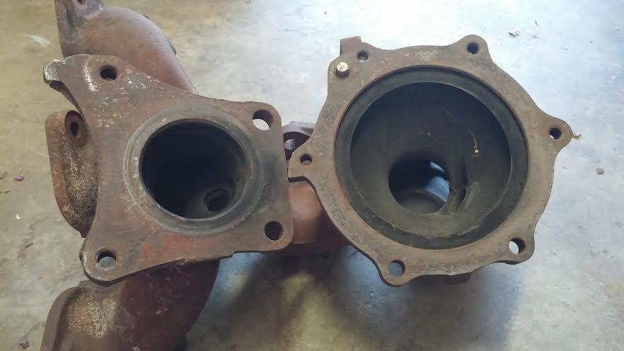

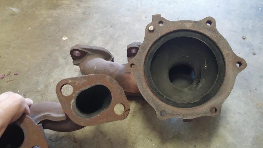

Here's a pic of the inside of our exhaust manifolds. One of them is so restrictive that it passes three ports through one hole that's about the size of a single port. The precats bolt directly to the manifolds so there's never a chance for the exhaust to develop a "flow" out of the head.

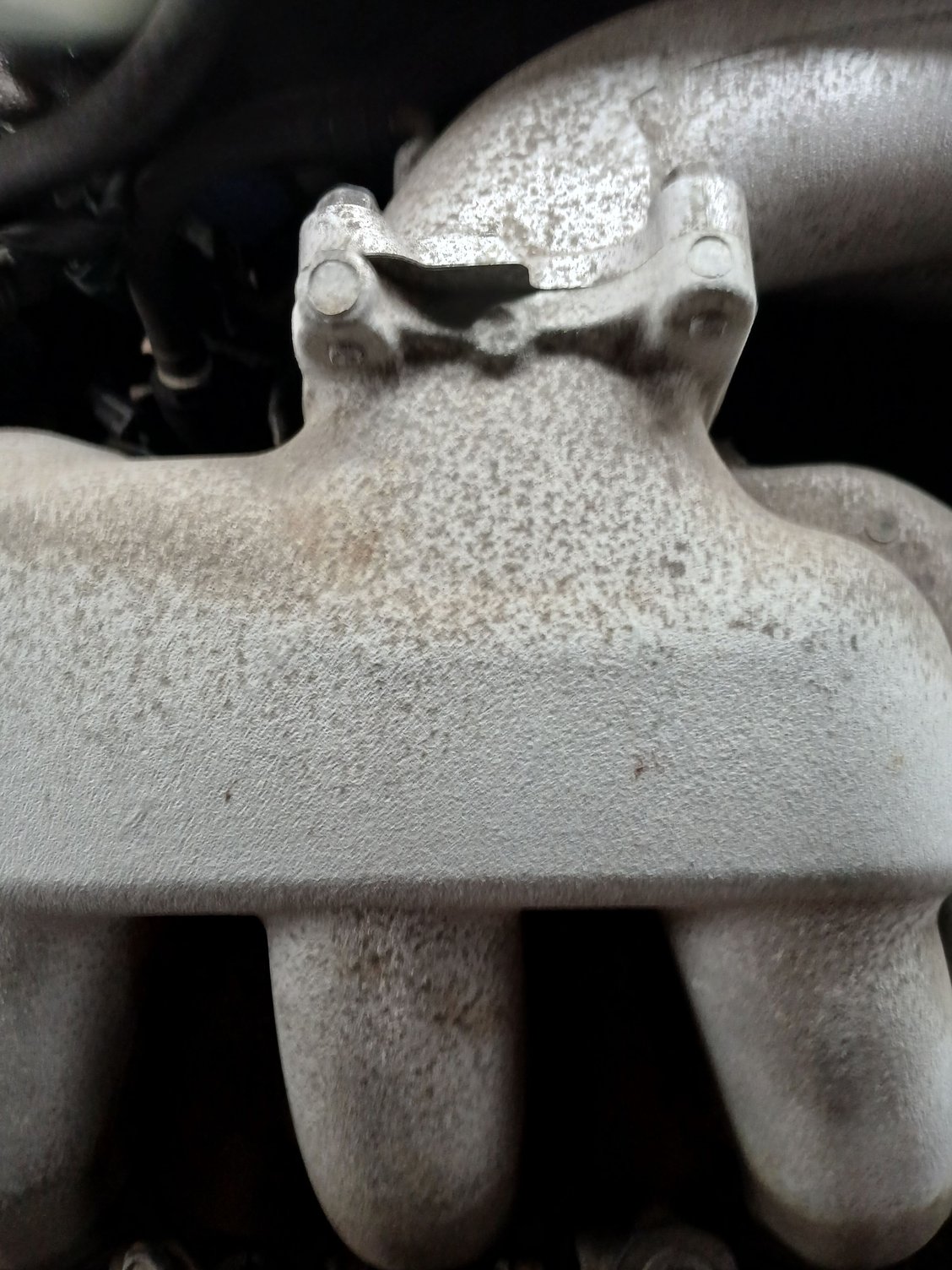

Is there aftermarket throttle-body spacer kits for our stock 70 mm throttle body for the 2003 Nissan Maxima SE 3.5L? And if so, will it bolt up directly to the stock upper intake plenum elbow side of the throttle body? Or can I get a spacer kit for the uim plenum where the elbow meets at the uim? They should have a spacer kit for the 70mm one.. no?
Sorry about the bad pic. This is the other side of the stock throttle-body. I just bought a new Hitachi 70mm throttle body i still have to install. I guess this is where the spacer kit would mount?
Heres where the uim plenum collector elbow meets up to the manifold. Could I also install a spacer kit here as well?
One more thing... What would be a good block-off plate thinga majing to switch this stock plate out? Forgot what its called, lol. If anyone could chime in Im very thankful. Thanks -- VQ
