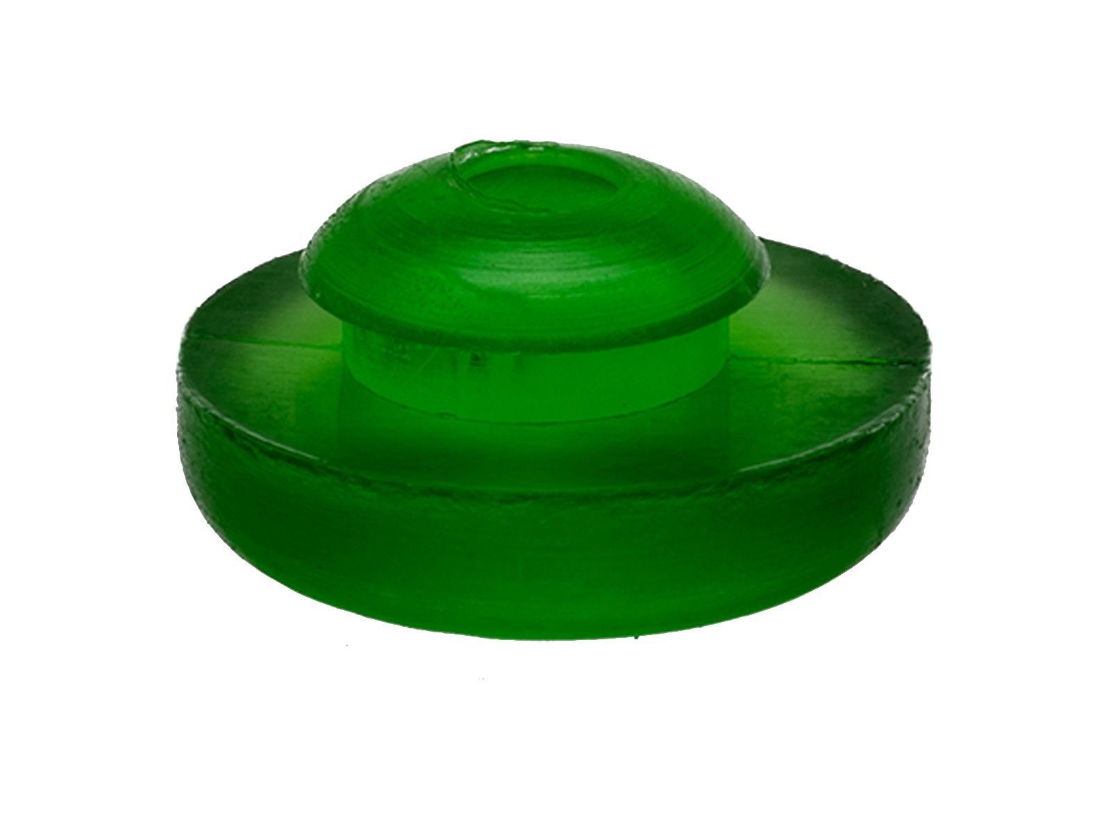

the gas pedal also has one, it's green but the black ones fit the same.. when it comes off your engine will start and idle but won't repsond when you touch the pedal
That is good to know. Thanks. If I see bits of green plastic on my car floor, then I know what to do.
