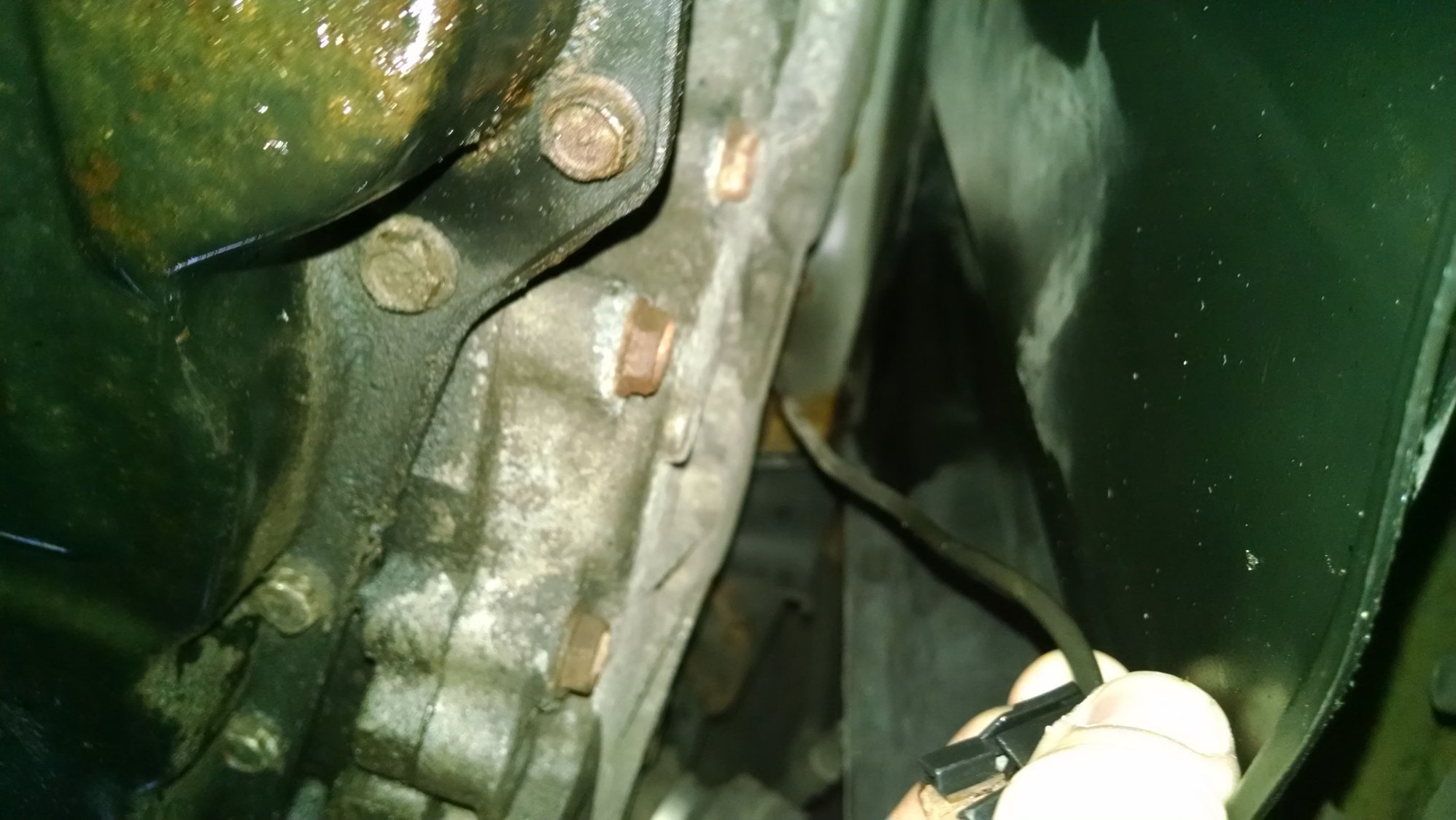

Hey guys I'm dropping my transmission pan to inspect today and I was starting to unbolt the 21 bolts and noticed a mysterious wire hanging on the driver's side of the transmission pan. It appears to be damaged at the connector but I have no idea what it's supposed to be connected to and I'm having a hard time getting a view of where it comes from. Here's a pic:
Anyone know?

Look like grounds.

If it were brown, I would say "previous owner replaced/eliminated the rear e-mount", but it's a black connector. So, it must be one of the sensors. As the car is running fine it's hard to guess.

That is FOR SURE the ground to the transmission. The other end of the connector should go to the rail about 8" forward of the mount.

Well I've been having intermittent slipping transmission issues, and occasionally the RPM's will kick up out of nowhere during slow/normal acceleration and it won't shift out of first gear. Might even be dropping a gear now that I think about it... I did the old drain and fill/cleaned the magnets today haven't driven it much yet though to see if the issue is resolved. The old fluid was brown and very dirty though, but no metal shavings in the pan just some gunk on the magnets as was expected.
Quote: That is FOR SURE the ground to the transmission. The other end of the connector should go to the rail about 8" forward of the mount.
What happens if it is disconnected? Sorry I'm clueless when it comes to electrical stuff. The connector itself looks to have a piece of metal (possibly the rail itself) sheared off inside of it so I don't think I can reconnect it... I can try to get a better pic tomorrow of the connector and rail itself.

The transmission should technically be grounded. Which is why they sell grounding kits. I would suggest taking the wire and snipping the end of it off and connecting a ring terminal and just bolt it to the transmission.

Just bumping this thread to say grounding the wire worked! Transmission is smooth as butter again. Thanks guys!
