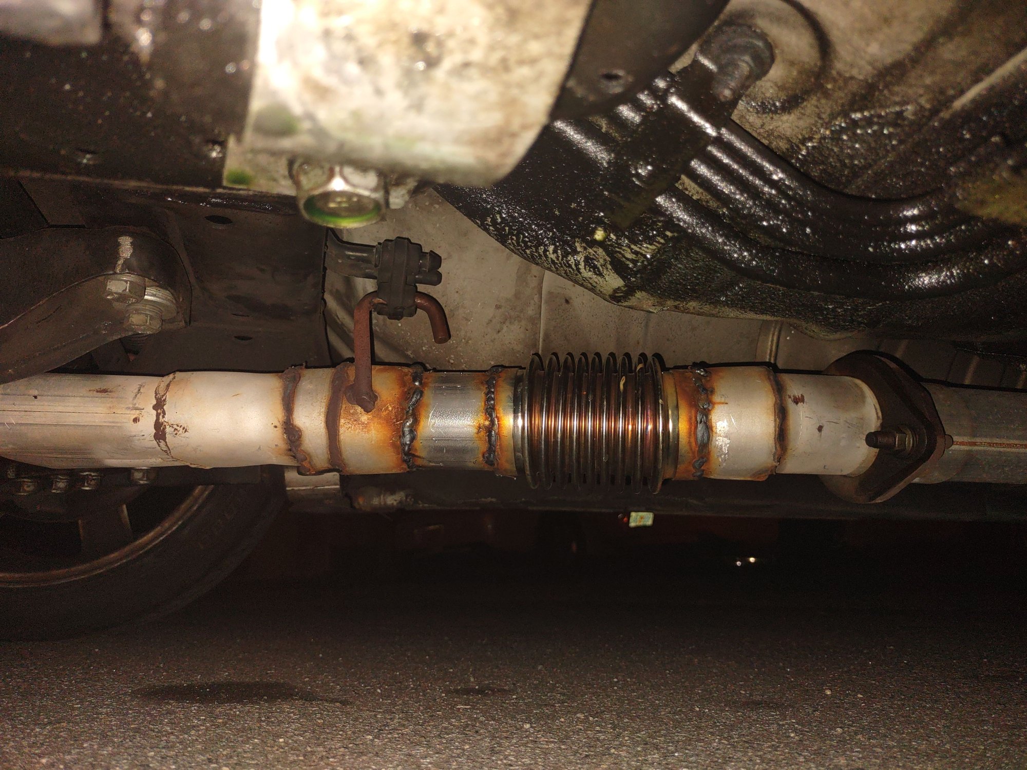

so the second flex pipe that was installed on my Warp speed Y went out on me again after the exhaust shop told me the one they have was better than the Vibrant pictured below and that it only went bad because my mounts were bad. they refused to install the vibrant flex that I had on me that day. I believe that was back in October. I had installed Nisformance upper mounts and E.S. lowers a week of 2 after having the flex pipe put in which I believe was in early November. a few days ago I parked my car for a few hours and when I got back in to crank it up I heard the noise and knew it went out again.
this morning I found a different exhaust shop and they told me the Vibrant flex that I had was cheap and no good but they went ahead and installed it anyway, $90 to install..

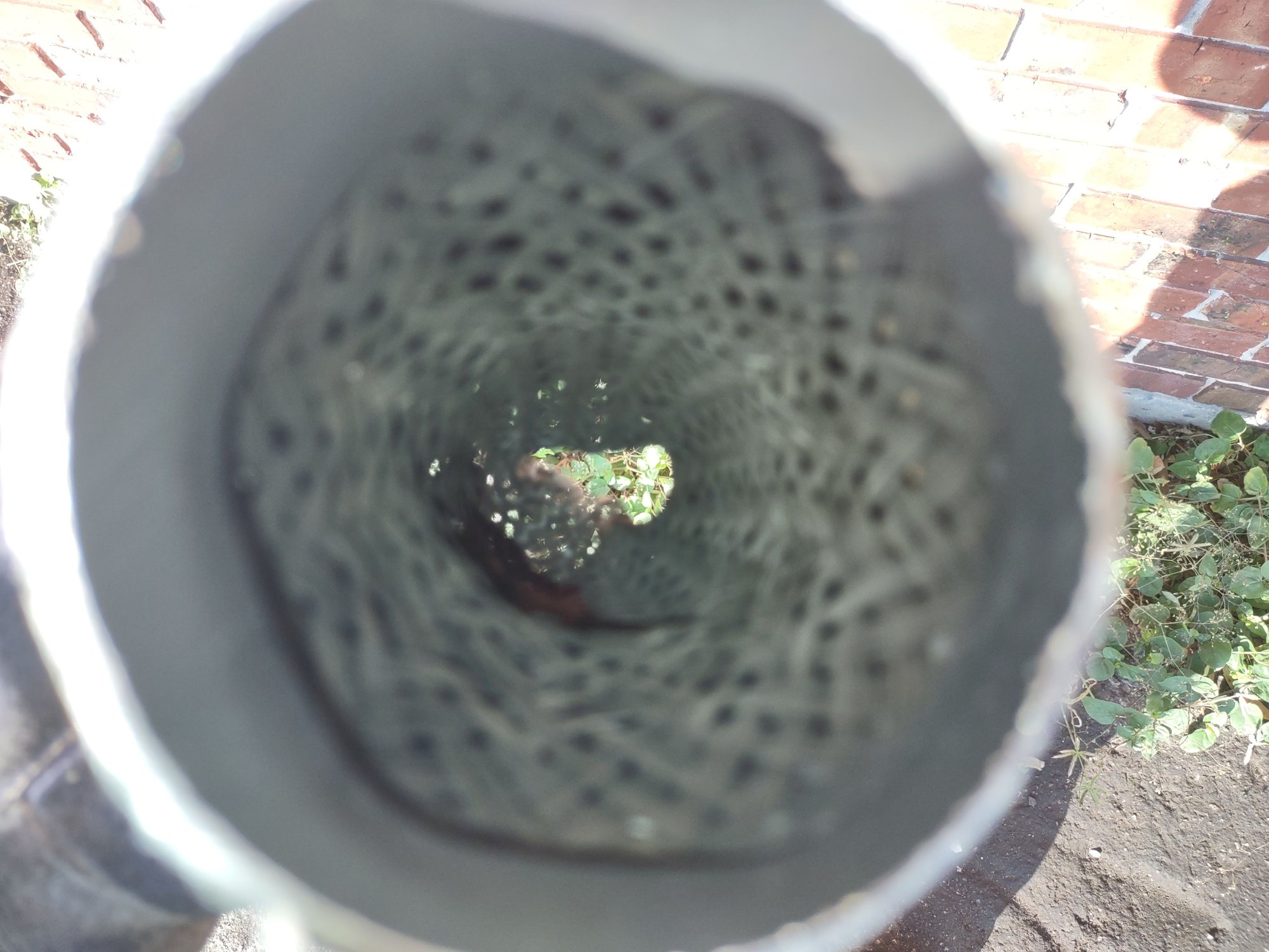

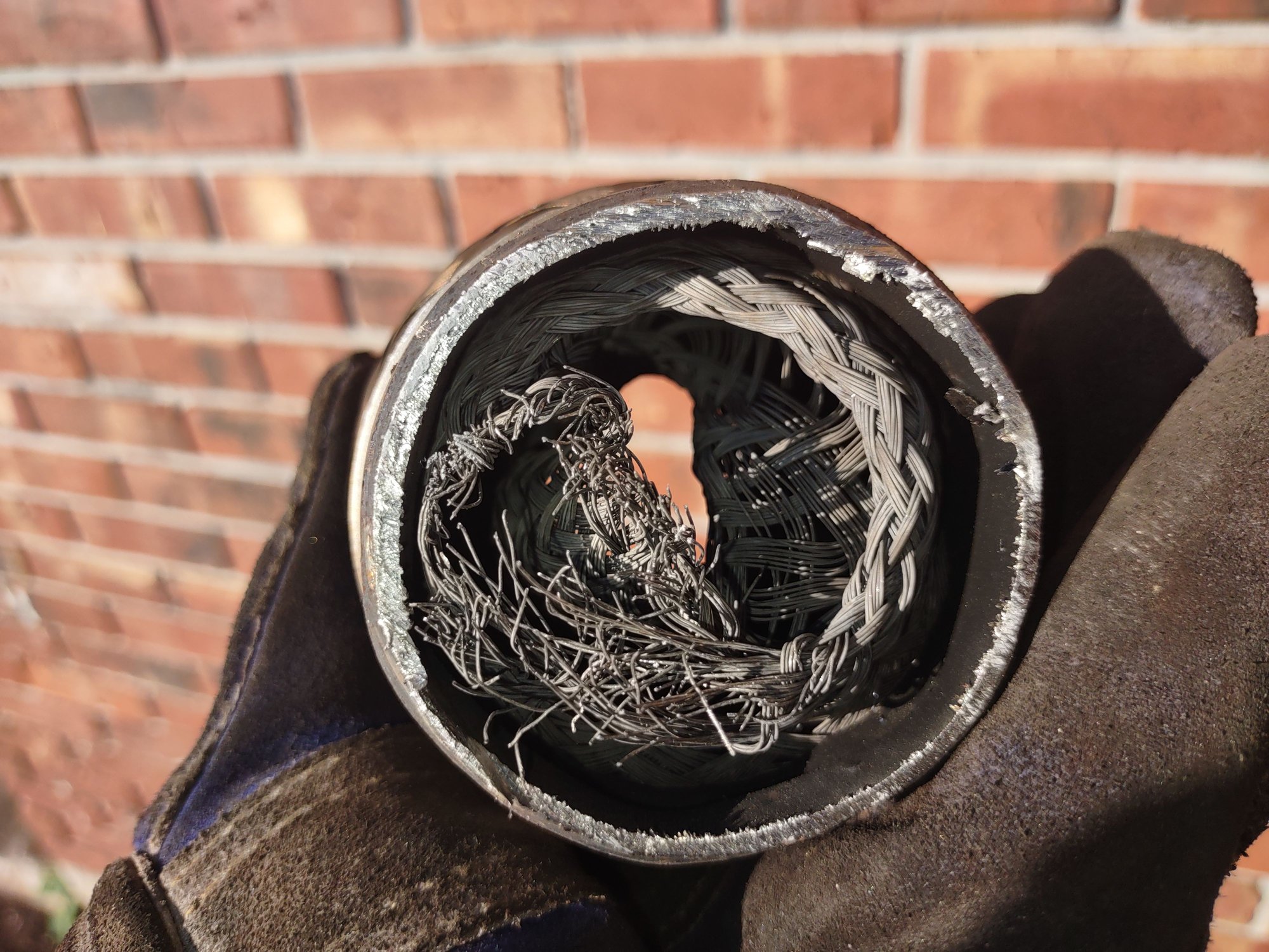

here's what's left of the old flex pipe that the other shop told me was the same internally as the Vibrant flex but has braided wiring over it and is better, they lied..

That looks like my first Warpspeed Y flex. I got 7 years out of it. Makes me wonder how long it had been collapsed because power was down for some time. https://maxima.org/forums/4th-genera...literally.html My exhaust is nearly all original on my 99. It's laughable how the factory parts can last decades but aftermarket stuff is a complete crap shoot.

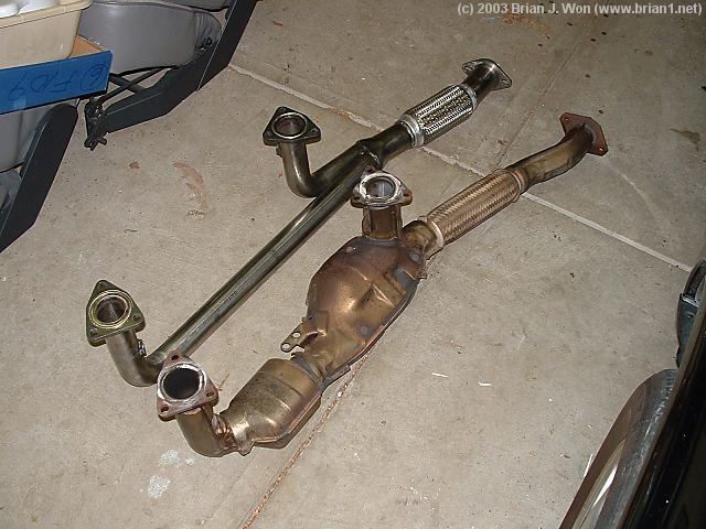

I'm guessing short flex pipes don't last as long due to less flexing surface.
the OEM flex pipe was a lot longer from what I remember, here's a random pic of OEM Y and aftermarket Y...

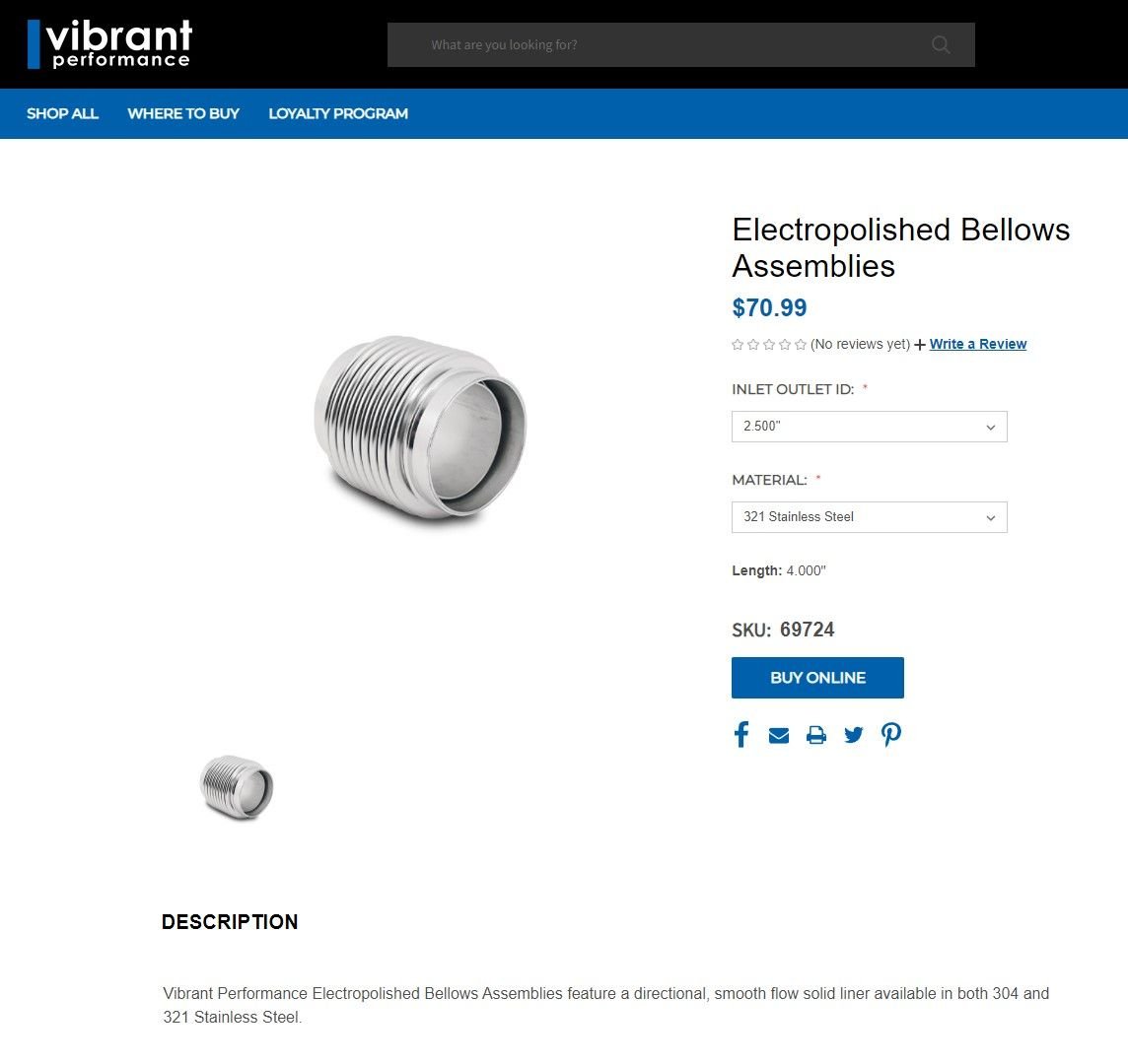

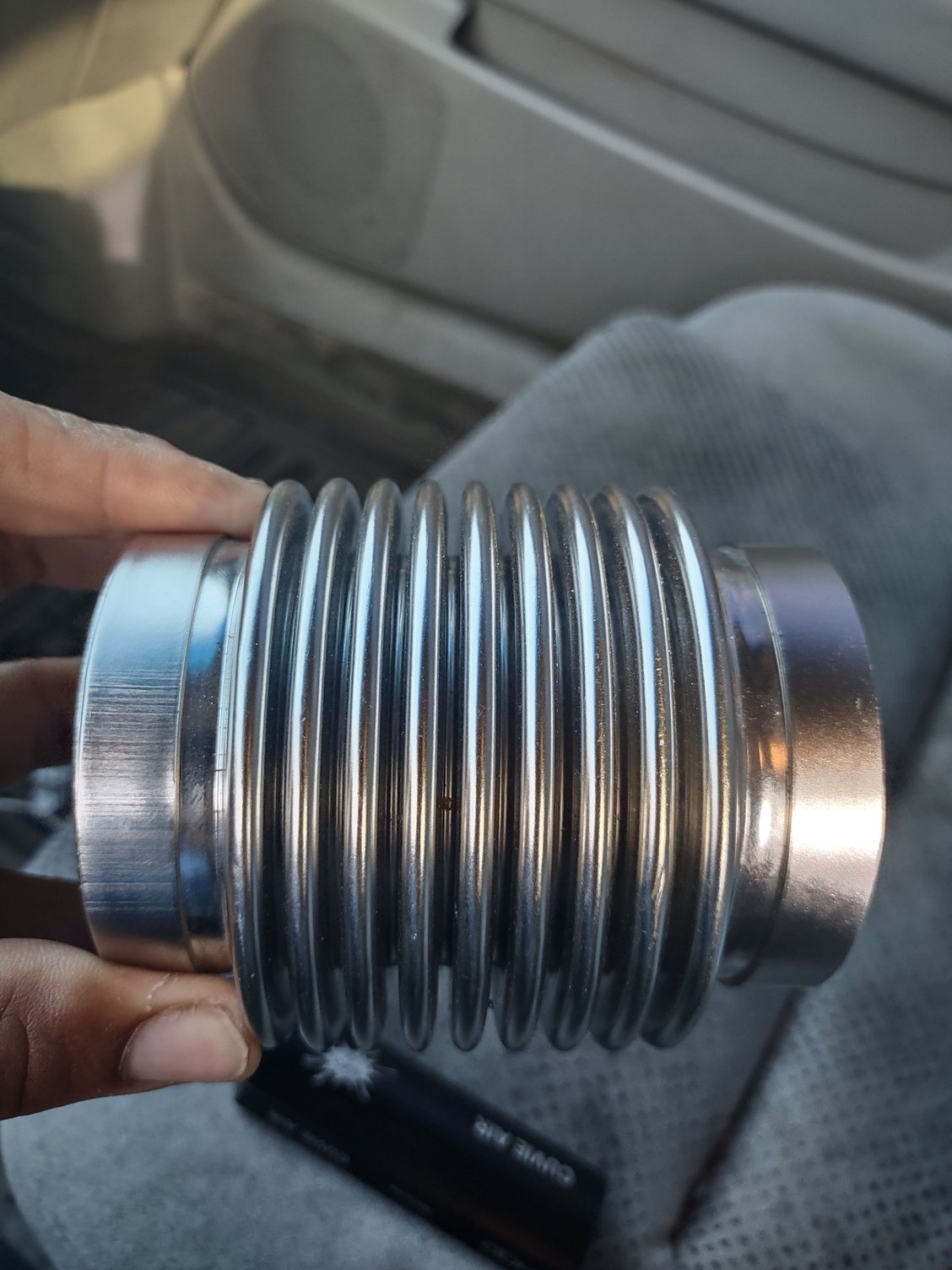

here's what the new Vibrant flex looks like that I had installed last week.
this is the actual part and part number
