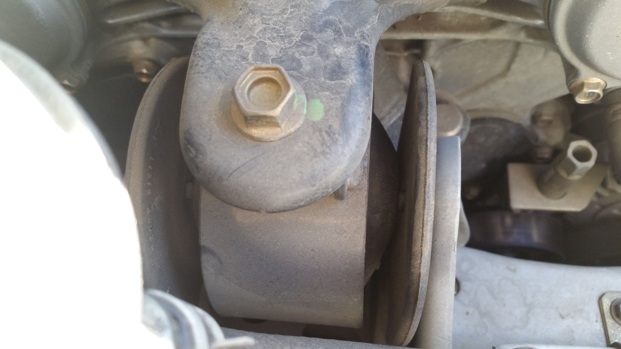

I am hearing an occasional knock coming from the engine compartment on the passenger side, usually when I run over a speed bump etc. at low speed.
It sounds like it is coming from the engine mount. I know these are notorious for going bad.
My car is an '02 with 117K on it. I'm sure it's probably ready for new mounts. I just disconnected the front/rear electronic mounts after reading about the potential to fry the ECU. I also replaced the ECU fuse w/ a 7.5A.
I just wanted to check if this actually looks bad to other members. I haven't seen a brand new OEM mount to compare it too, but I don't think it should be bulging out at the sides like this one is.
When I have someone press the gas pedal with the brake on, the engine doesn't appear to move excessively, about an inch or two.
Have a look:
Passenger side engine mount front - bulging.
Passenger side engine mount rear - bulging.
I'll probably replace it with Anchor 9031 from Rock Auto unless someone recommends something else.
Any input would be appreciated.
Thanks

That's how all of mine look. As long as it's not bouncing up and down, it's still fine.

Probably.
Mine would get knocking sounds going up driveways or bumps, turned out to be ripped mounts.
Replaced with china ones and I'm getting that knocking sound again 2-3 years later.

Just stick a pry bar in it and see if you can get excessive movement.
You could also remove it and inspect it. That mount comes out very easily.

That engine mount is very deceiving. It looks good but the rubber overtime becomes too bouncy. When it is bad you hear a heavy clunk on the right/passenger side of the engine. I know someone who changed struts, control arms, subframe bushings (big job that required engine removal), in the end it was the mount that was causing the passenger side clunk.

nah gonna replace it though, but its alot of movement of the engine from it being bad just from putting the car in reverse and reving the engine. While it was working you could feel it firm up when giving the car a good amount of throttle.
