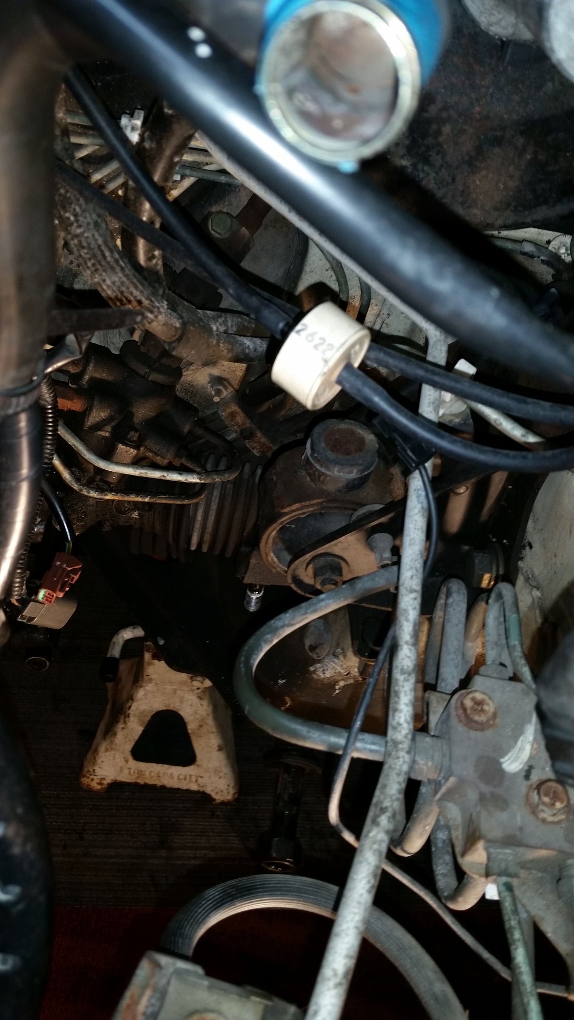

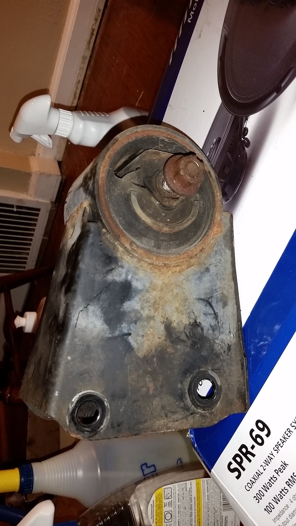

Pictures of the Mounts
I have a 1992 SE automatic and a 5 speed, but these should still help you. Even though these are mounts for the VE motor I think at least some of them are the same.
On the automatic, here is the front right engine mount,which is the one near the firewall.
Here is the front left, which is on the engine near the radiator

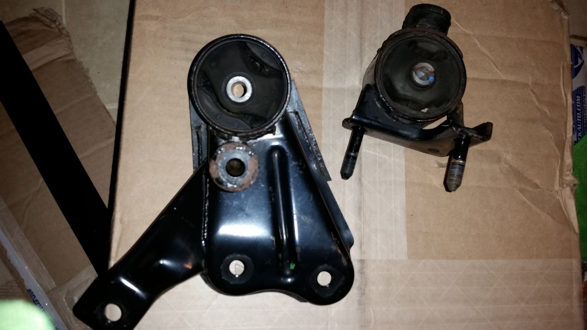

Now here are the trans mounts for a 5 speed 1992 VE
Both manual trans mounts, left on the left and right on the right
Left side manual trans mount, still installed, this is the one closer to the front of the car
Manual trans mount, still installed, right side, closer to firewall
I hope these help. I'm doing my clutch VTCs and timing chains so I have lots of pictures available.
