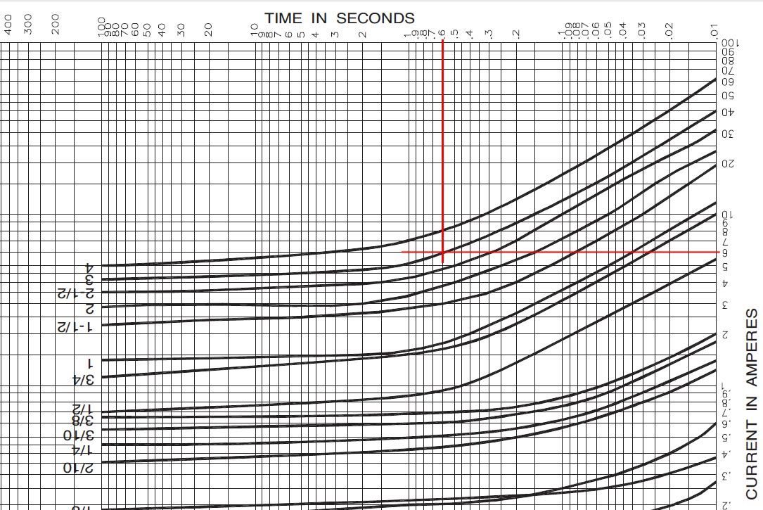

The pulse rating of the STA509a is only intended to indicate the peak current capability of the device under short term conditions. The 6A specification is for a pulse width not to exceed 100 micro-seconds, or 0.0001 second. The motor mounts aren't being pulsed, so this data is only relevant insofar as it tells us something about the life expectancy of the transistor when the coil shorts.
Just to put fuse protection into perspective, the chart below shows the blow time for Bussman AGC fast-blow glass fuses. If 6A is applied through a 3A fuse, the fuse will open in approximately 0.6 seconds. That's 6,000 times longer than the transistor is rated to survive.

It sounds like a fuse would never work because the fuse would never blow in time before the transistor became damaged.
Maybe this is the reason some owners have reported failures even after installing a fuse. A 1A fuse still requires 0.035 seconds to blow at 6A. That's 35,000 micro-seconds. In comparison, the LM317 exhibits a transient response time of 50 micro-seconds. The LM338 is less than 35 micro-seconds.
Wow. So, I guess there may be no simple solution besides unplugging the mount.
With the limiter you couldn't limit it at 3A or pulse mode wouldn't switch on. You also couldn't limit it at 6A or the transitor would be damaged. Is that what maxiiiboy was getting at?
