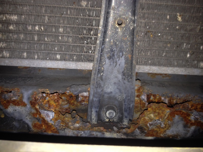

I got a question about the radiator support.
This one I got is pretty rusted out but appears to still be bolted on so I drive it anyway.
When it's bad does it completely separate from the tie bar?
What other issues will I have to address when I get the new tie bar put in?
Has anyone ever had the engine completely fall out from this?

I have officially garaged this car until I get it fixed. It's not drivable!
If you've never seen this before it's the worst thing you could ever imagine! The car clunks because the engine stability is bad and the power steering begins getting noisy.

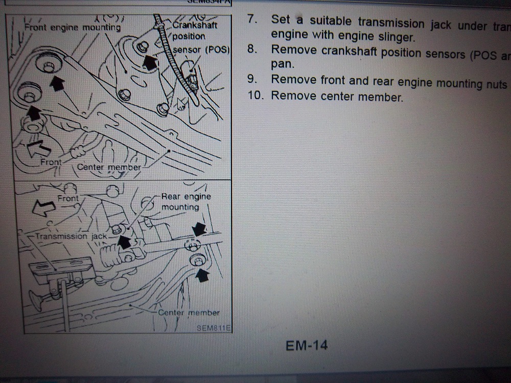

If you look at the diagram you can see the bolts are the only two bolts holding the C' Member.
The Nissan Engineer repair manual reads that when you remove the C' Member you would have to have a shop crane hold the engine in a sling. Well its just as good as being unbolted right now!
I can't imagine what I'm gong to have to get done after the tie bar is replaced.
I didn't read it would fall through; however, I read that when you remove the Center Member the engine has to be supported in a sling.
I would assume that is to prevent damage to the other engine components.
If you say so, but I'd be willing to bet 99% of .org members here don't use a sling when the crossmember is removed for common repairs such as motor mounts. Werent you the guy who was going to rivet a new support in place?

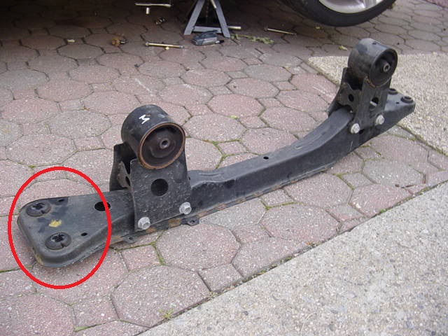

Here's the center member.
only 4 bolts holding on.
2 not even attached on mine.
well yeah it's going to create performance issues and mechanical issues.
Old May 1, 2016 | 08:52 AM
cornholio's Avatar
Joined: Mar 2013
Posts: 817
yep that's what it looks like. again, the side engine mount and transmission mount will keep the engine from falling through. it is better to get fixed sooner than later but you won't leave your engine on the road somewhere.

I can't figure out whether or not this one was re-painted or something.
I see rust bubbling but there's paint over top of it.
I'm baffled.
It's too much for me to understand.
The only other rusty area was the passenger side LCA. The thing had to be grinded off with a grinder.
besides the tie bar and LCR the rust has been OK I guess.

Rust can still bubble up under factory paint. The problem is you bought a crappy car and didn't know how to look one over properly. Anyone who's not very strong on cars should take it to an independent mechanic for a pre-purchase inspection. Especially a car that's over 15 years old.
I've been around cars for a long time now. I spent years selling cars at large dealerships and have driven thousands of used cars. I now repair cars freelance for a local shop that specializes in high end import cars and exotics. I have a pretty good idea of what problems are common among different cars.
I can tell you that these cars are holding up WAY better than most other cars from any manufacturer. All cars have weak points that show up over time and any car will fail if neglected or abused.
