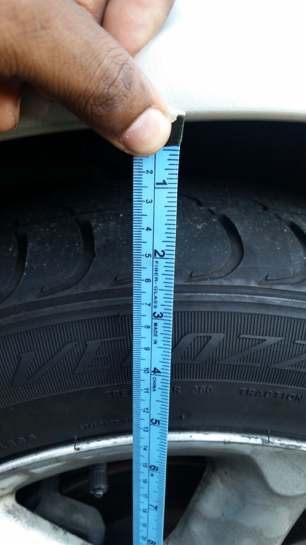

What's up, I recently replaced my control arms , tie rod ends and driver side axle. Like 2 days after that I noticed a popping/Clunking noise when I turn, go over bumps and sometimes when stopping.. And I also noticed that one side of the car is like 1inch lower than the other. Could the struts be bad? It's not bouncing bad at all. just handling weird. (That may be my sway bar links) HELP IS GREATLY APPRECIATED!!!!
My boot on the Sway bar link Is coming off.

Strut must be bad. That's a huge height difference.

That's what I was thinking. And the height difference changes as I drive. Thanks bro! You think that's what causing the noise??

Struts bottoming out will cause clunking, too, so yeah. I mean nothing else should be making noise since you replaced those parts, too.
