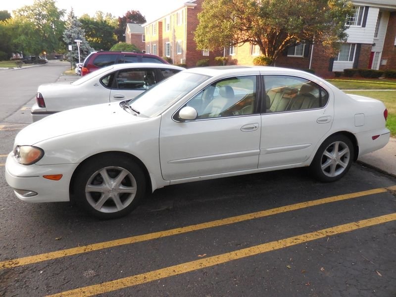

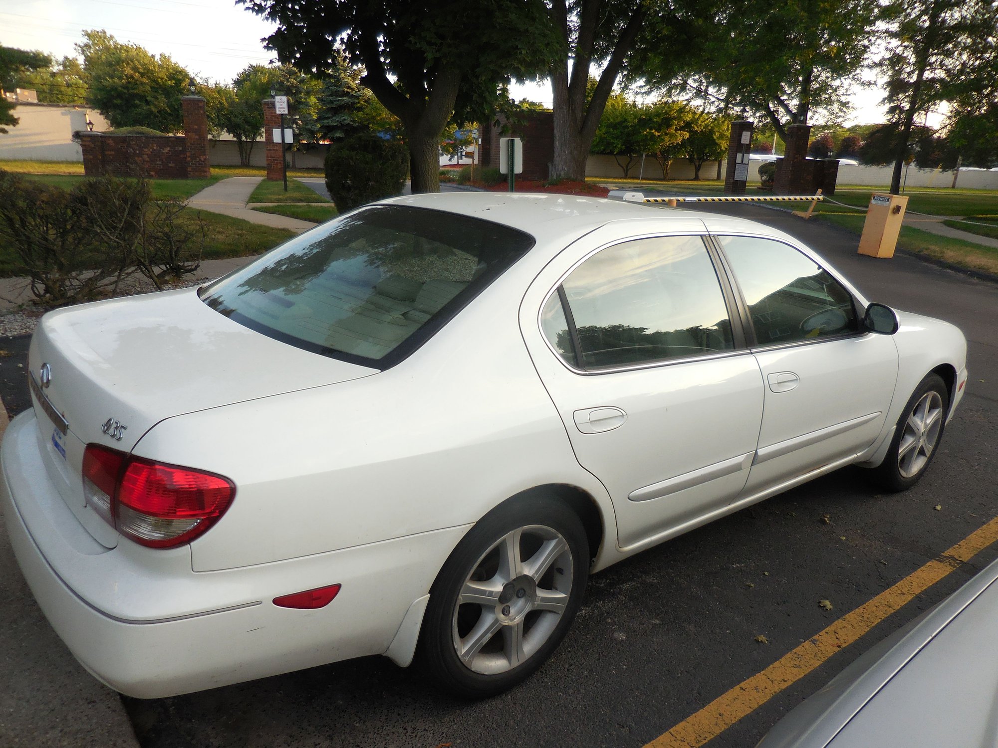

Car looks good, at least from the outside. Could probably use a bath.
Post a vid of the issues you're having.

yeah man nice car and for a good price too.
