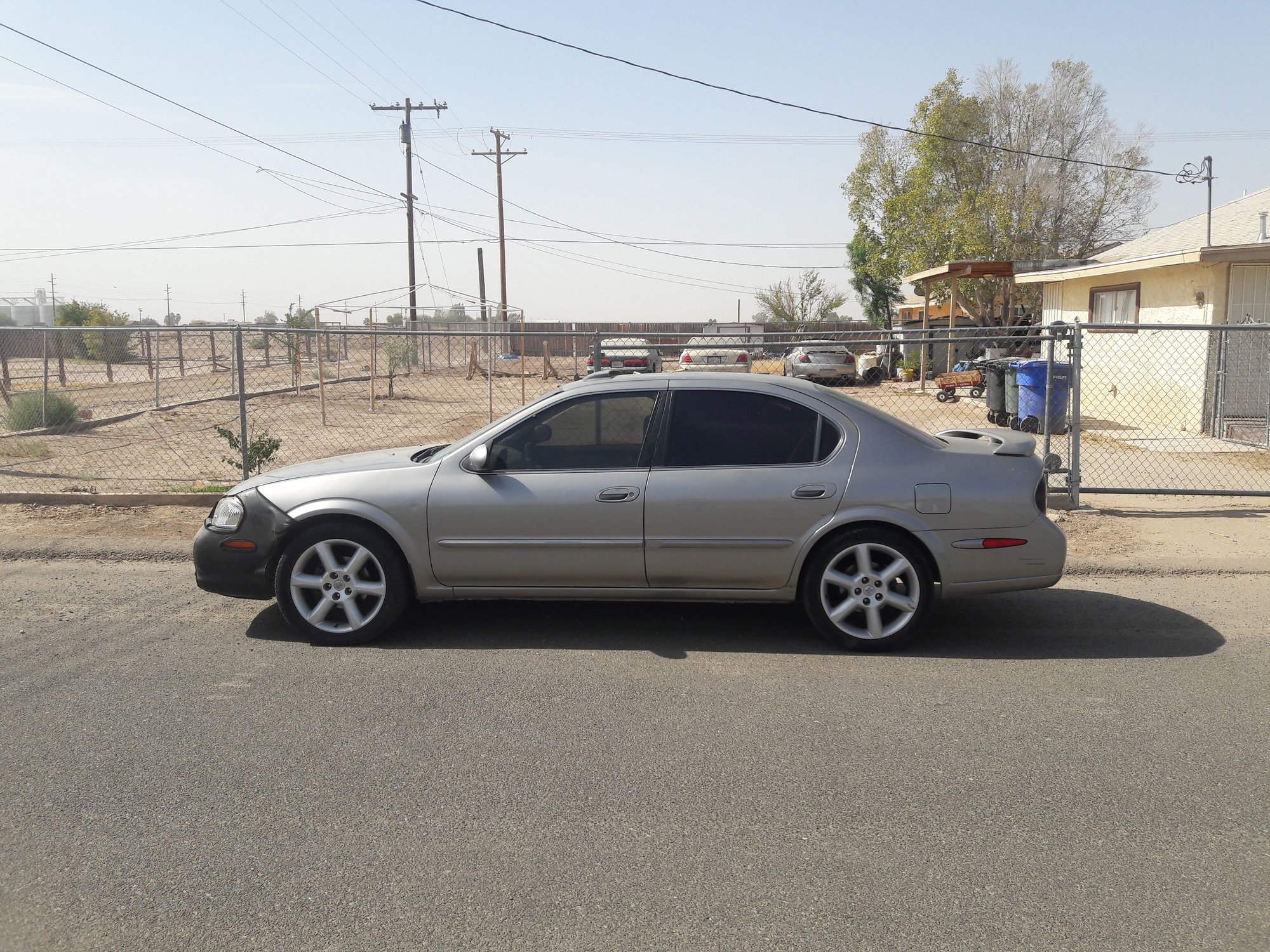

I
know from.the back its lower.. What springs do i need.. How many inches do.i need to.drop it from.the back and.front.. Thanks
