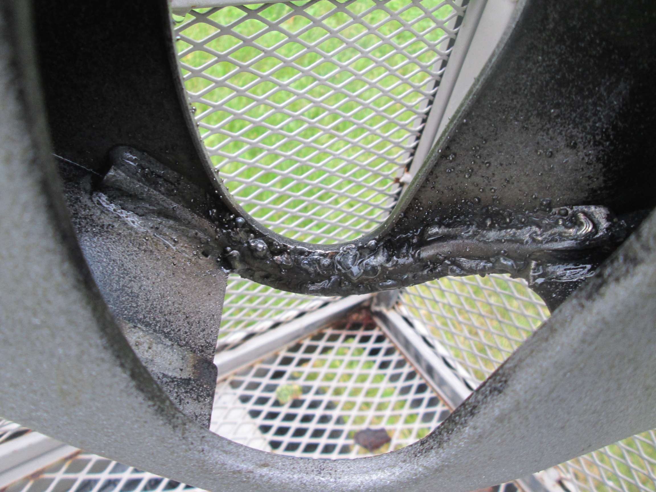

looks much better than this ,but wasn't easy to weld.
Also pictures of rad support welded.

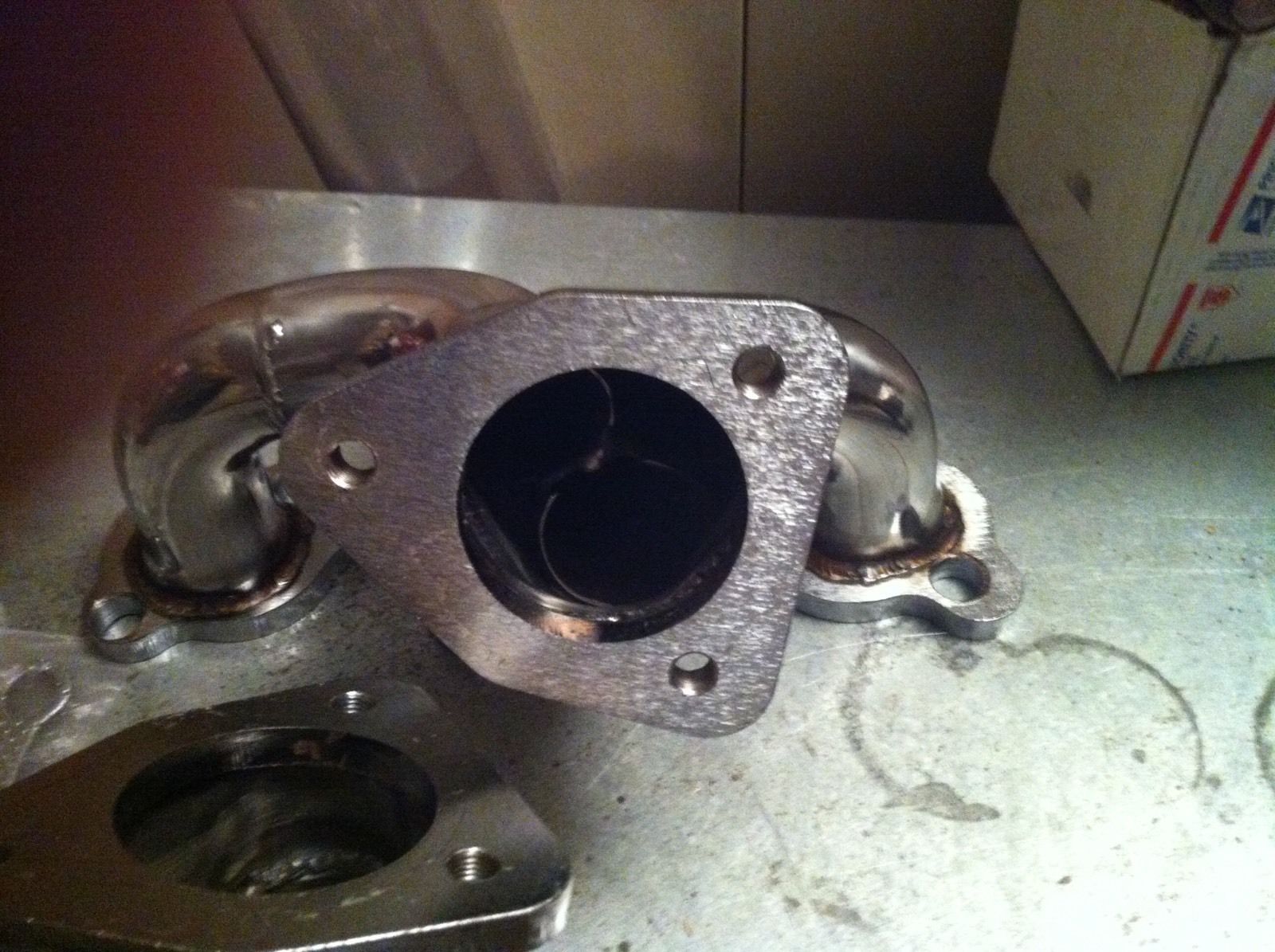

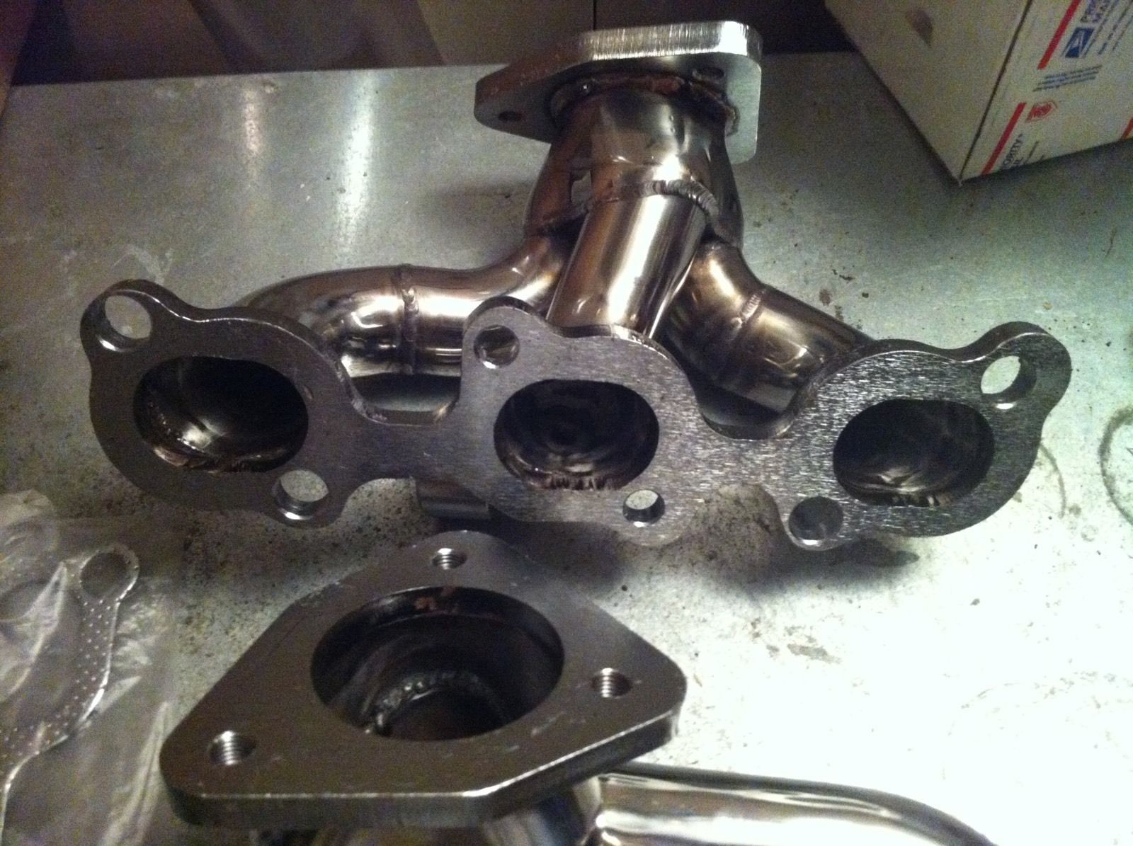

just picked these items up more on the way.
clutch master a little stronger than stock.
304 SS bungs for 5 th gen O2 locations. And some cavity wax. and some 304 SS "extenders"

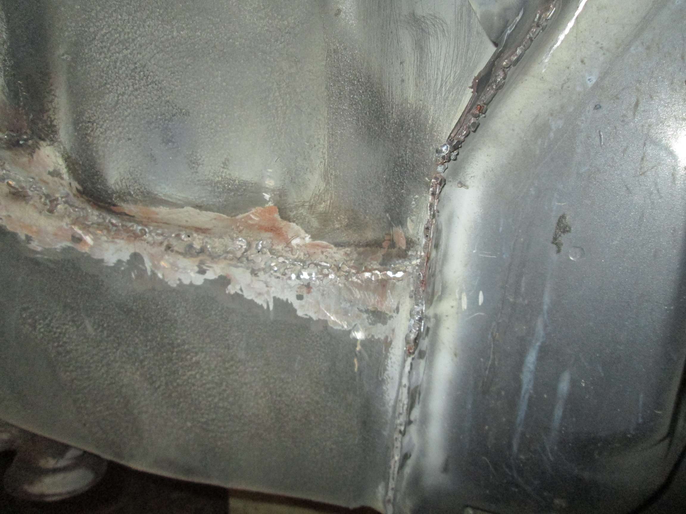

i was gonna buy new crossmember and rear lateral link but canceled the order decided to save the money and fix my stuff.
here is the crossmember ,fixed and sandblasted. Completely seam welded. And holes filled just left one on the top and bottom for foam.
and the middle brace under the car. they both had heavy rust and the crossmember in pic 3 had a hole of rust in that spot and was slightly twisted.
After pics were taken i marine cleaned these and metal prepped these pieces they are now waiting to dry.getting ready for POR15.
I will do this to the rear lateral link and the brace it mounts to,next.

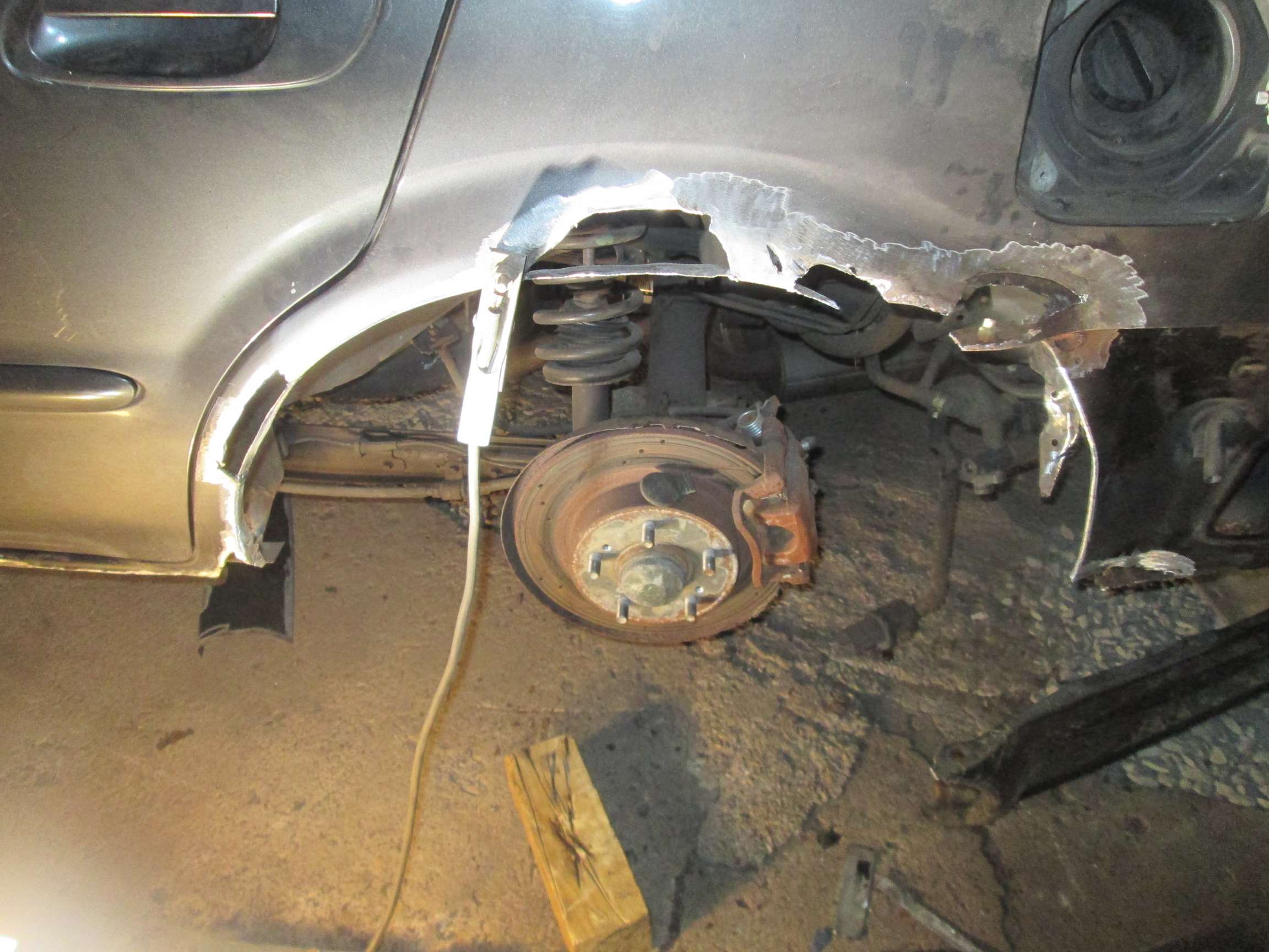

Well after putting some attention into the back of the vehicle i am finding the rust is worse than i thought.A lot of the rear is gonna get coated with a wax or petroleum product. At this point some of the rust can't be repaired without much hassle. So there a products that can stop it.
Also Ordered new evap bracket that thing is crumbling apart.
I noticed the plastic shield that goes in the wheel well isn't there.There are two on the 4th and 5th gen. I smaller one and a much bigger one. Bigger one wasn't on it.
I'am cleaning up the rear wheel wells now. I did end up ordering a new lateral link also.
And the lateral link bracket ,is gonna get repaired.
With the wheel wells i cut the worse metal out ,then re frame it so the shape is back.Then the inside will be filled from the back with POR 15 and their mesh.Then front covered over with fiberglass bondo.If you look at the 2nd 3rd 4th 7th and 8th picture the rocker is getting repaired. it was bad there.

This is the reason why rad supports and these lateral links are so advanced with rust.
For the time they are on the car they shouldn't be so bad. I know why they are now. New lateral link received it.
I notice the paint on the welds, (in storage) has already failed. Welding makes metal very dirty,they did not cleaned the pieces properly before paint in the factory .
Rusty on these seem welds ,same seem welds on radiator supports and cross members.
It's to bad i have to media blast the new link. I'am gonna also finish the rest of the welding nissan didn't do.
Also picked up a new EVAP canister bracket. price around $38 .Link was about $115 ,courtesy nissan

Well this is the second to last part to clean on the car . last part is the lateral link mount bracket.
Welded the last seams shut and the ends. Just finished marine cleaning parts.

another snag the steering rack looks like junk, covered with walmart spray paint
Tried to go cheap but i am gonna get a cardone re manufactured costs a bit more.
Here's some progress pics
First 2 are a before and after just to show what i am doing. I have to speed up and get the car on the road because i am over budget and running out of time.
I will foam the rest later, so i can also check and see how the body repairs do. In relations to rust. if it comes back in some spots ,foam will make it hard to fix.
Posting more tomarrow
Attached Thumbnails Picked up a 2001 SE,gonna clean it up............-img_6097.jpg   Picked up a 2001 SE,gonna clean it up............-img_6786.jpg
