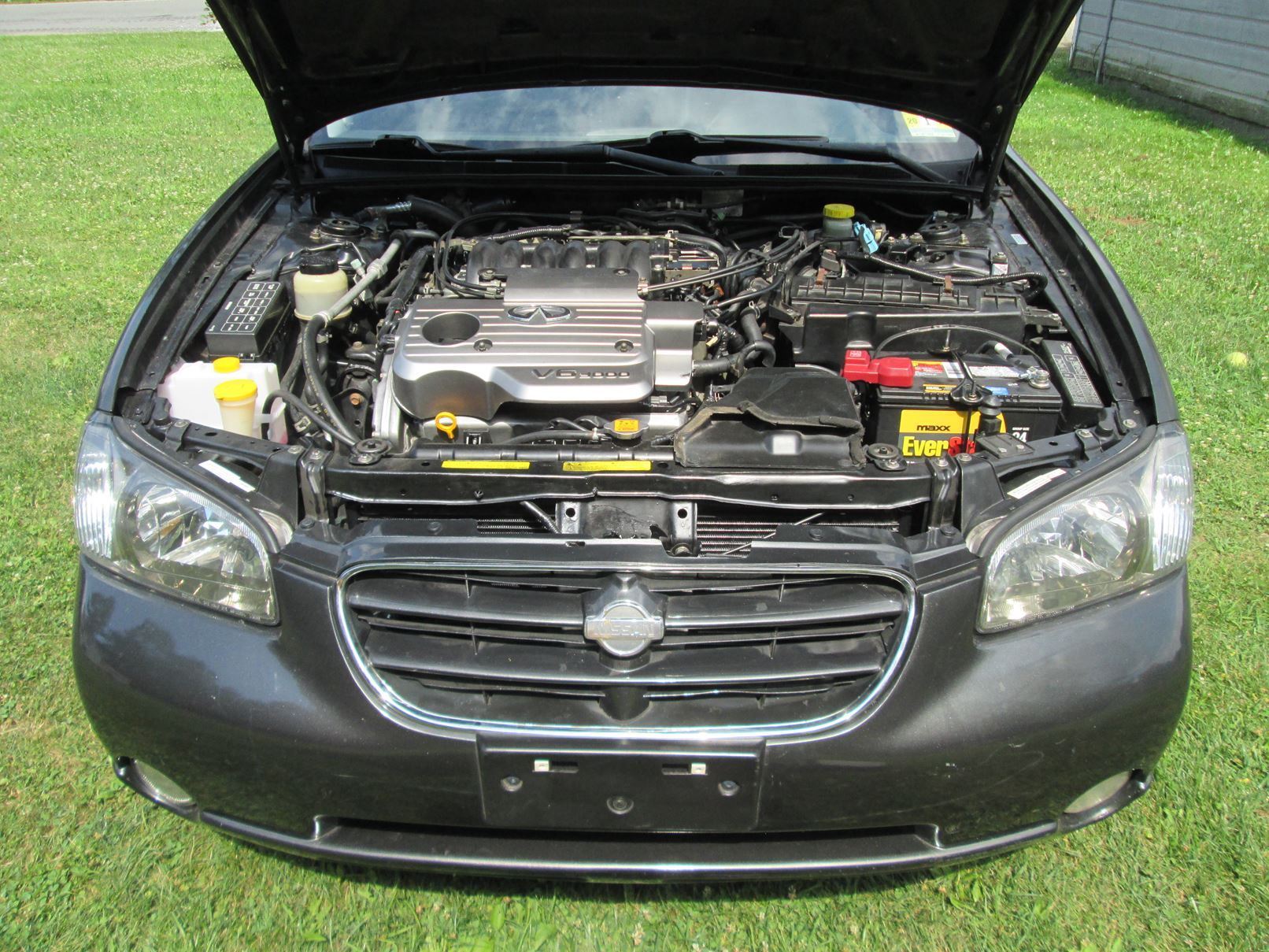

OK i forgot to post these . This was around the end of last summer . FINISH Pictures.
Still need a good set of stock rims . And fix the exhaust to my liking. And i still haven't washed the car ,once.It did rain a couple times notice the car cleaner.

Old Feb 3, 2019 | 08:21 AM
  #208
flames101sully's Avatar
Joined: May 2016
Posts: 283
From: Canada
A+. Impressive work.

You did a seriously amazing job on that car! Just out of curiosity did you estimate the total amount of hours you spent re building it?
Thank you.
I will get new pictures of the current car. But i put a better way trunk on since then. That one was rusty and damaged.
The brakes are new so when they go bad i have bigger brakes from a newer maxima. Also like i said i will be changing the exhaust .
I have cleaned the interior since then.

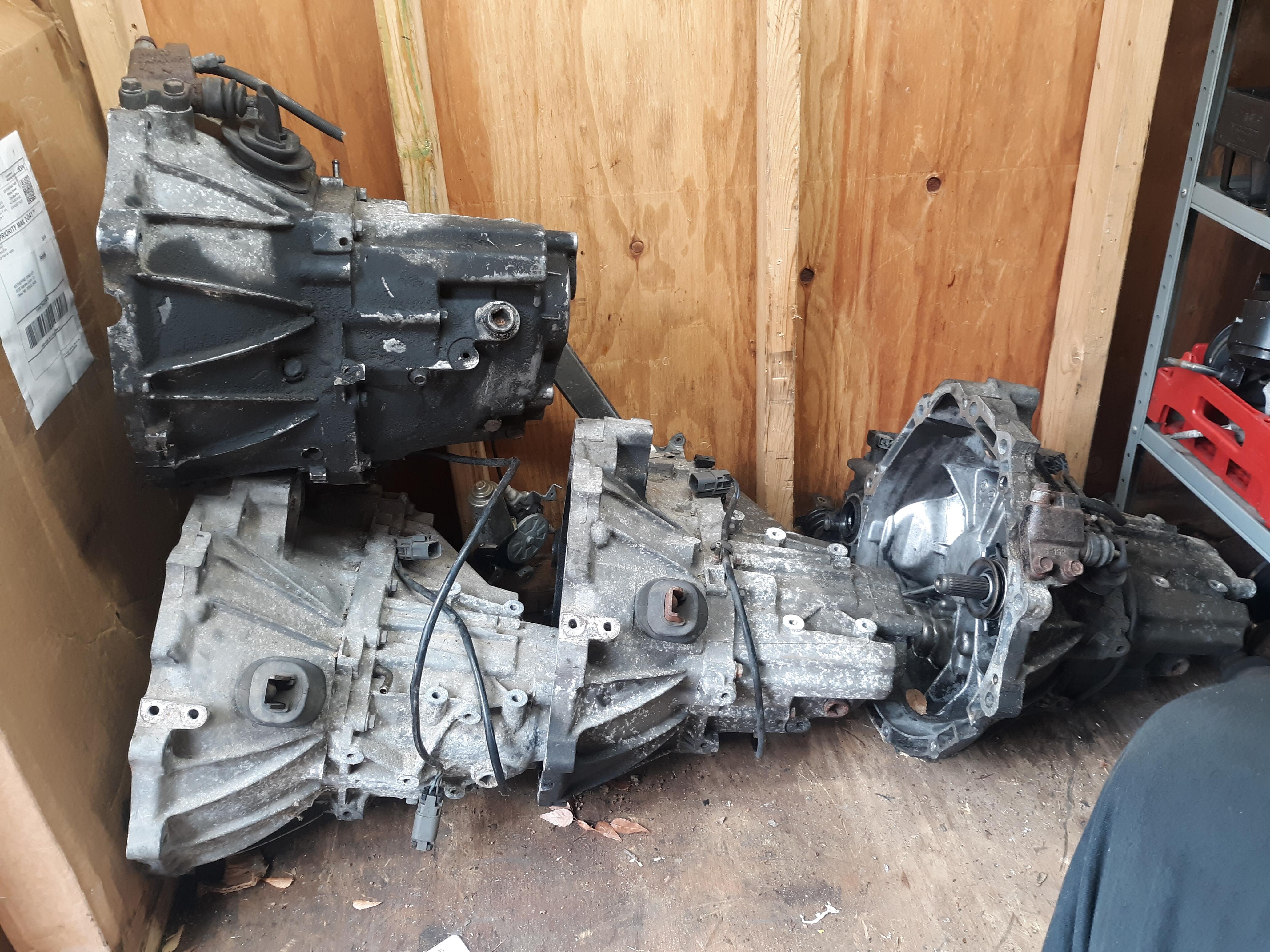

Finally got my hands on this stuff . 6 speed 2004 .Took 3 years.
I have all the interior stuff for 6 speed swap,except the shift ****.
I took the bracket off the transmission also.For the cables.
The hunt continues for the under hood stuff.

Ok i have been getting parts for the 6 speed swap. I am also working on a 05 Armada so it will take longer for the 6 speed.
Here's a link to club armada.
https://www.clubarmada.com/threads/p...-2#post-580157
I have the passenger axle from a 02-03 but i will probably use an 04-06 axles and axle bracket. I also have the body transmission mount. And the 02 shifter assembly and cables and shift ****. I also have the interior trim for the 6 speed.
I have the 04 stuff but it wasn't a direct fit. So now i have the 02-03 stuff.

Oh man, I'm jealous. I kind of want to do the 6MT swap, so I'll watch how it goes for you first
Yeah my transmission is on the way out. I had a low mileage 5 speed,i was gonna use. But there was a crack in it's case from someone dropping it. So i had it welded by a guy ,not someone a usually use . This guy instead of using a small aluminum patch , just tig welded the trans case. The problem with that is the case is very thin, and he welded so deep he did damage to the transmission.
You can't find a good 5 speed ,so a 6 speed it is.
It's easy to find a 6 speed transmission ,but all the other stuff is almost impossible .

That's why I keep a low mileage VLSD 5 speed in my shed as a backup for the Quaife trans What's the hard stuff to find for the 6 speed, shift linkage?
The shifter assembly is the hardest to find then the cables.
I recommend to start looking now for those . It took me 2 years to find them. If you don't start now you will never find them.

I have 3 sets complete 6 speed parts no axles tho. Pic 4 kicks. Lol
