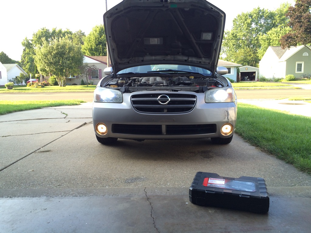

Instead of posting in my "Hope to Own 2002 SE" thread, I decided I'd make a thread specifically for it. Some background on the car, it has 129k miles currently, when I bought it, all the struts were replaced and supposedly the brakes as well. Still need to pull the wheels and give everything a once over. The radiator has been replaced and coolant flushed out. One tie rod replaced, alignment done to it. I got it for $2400, but has the 2-3 transmission flare that I won't be fixing. Body isn't perfect, but it doesn't bother me. Has the typical wheel well rust, but not horrible. I polished up the headlights using one of those cheap kits. I know the haze will come back, but they needed to be cleaned up. I attempted to clean the MAF sensor, but one of the torx screws stripped due to being rusted in place, so I'll be pulling out the intake tube and using a hacksaw to cut a slice in the screw head to get a flat blade screwdriver in there. Oil is clean and full, tranny fluid is nice and red and full. Front VC has residual around it, but nothing fresh or wet looking so maybe someone spilled some? I'll clean it up and take a peek. Interior was pretty nasty so I gave it a good cleaning.

(Yes I did replace the DRL light on the top on the pass headlight)
