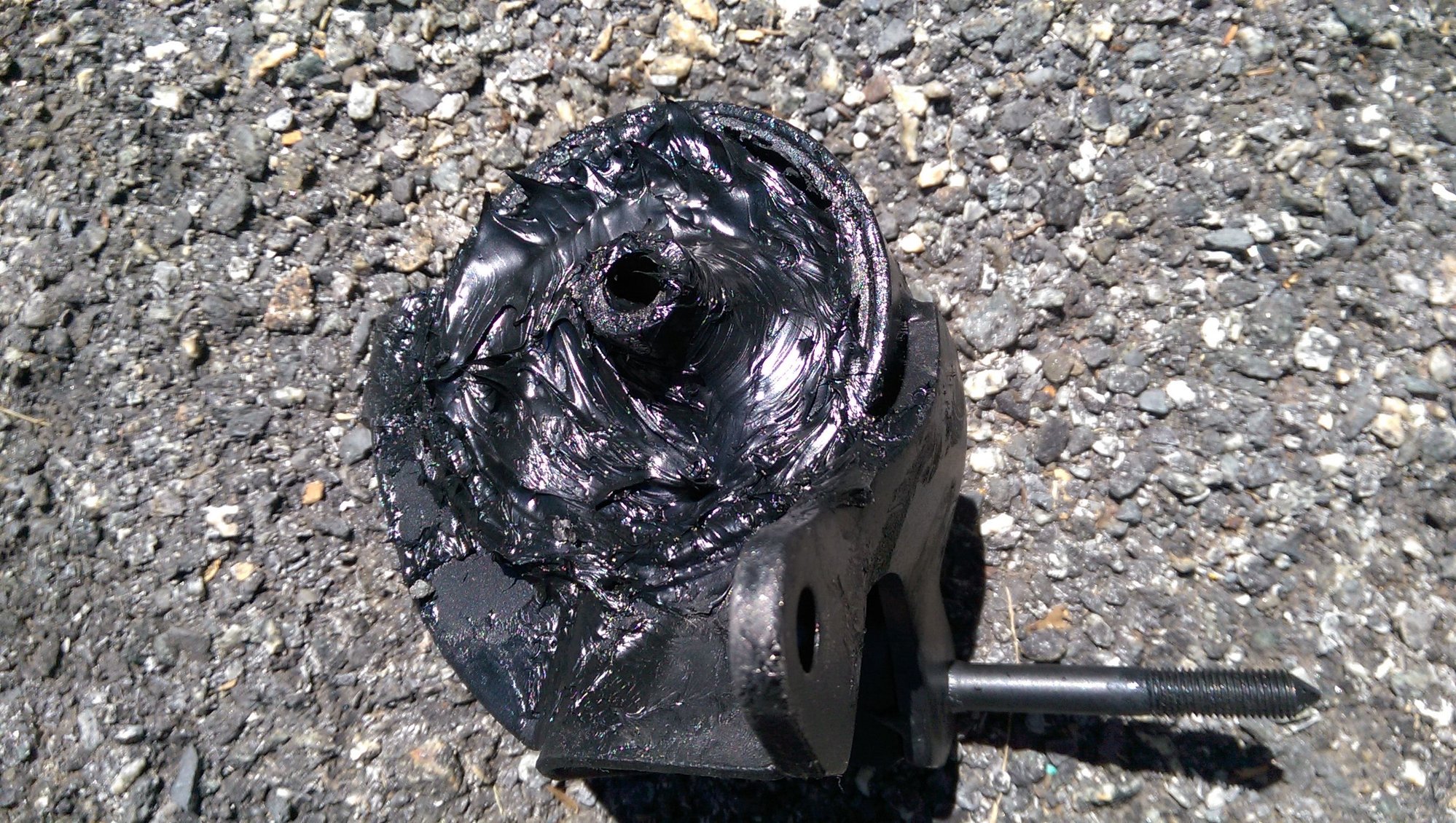

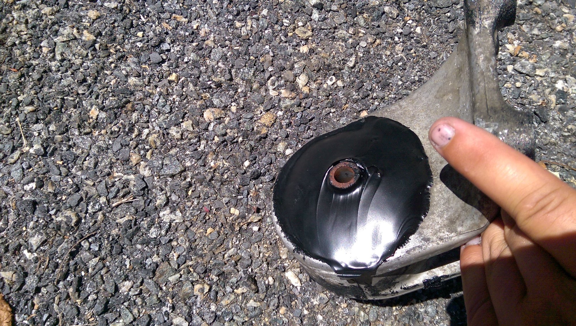

While I wait to install my es inserts I dug up my old trans mount and it was stressed but sturdy. The mount on the car that was new is squishy a hell so I decided to just fill the old one and slap it in. Grabbed a passenger side mount aswell to fill because the one on the car can be twisted with hand strength. God they were so cheaply built. I drilled them out and filled them with 3m window weld and they are currently curing. I can't wait to test them out and use my inserts aswell.

These have finaly cured. I was going to install them earlier in the week but it felt a little too soft so I left them outside. To my luck we have had some horrible humidity up here in NY and after 2 days of gross feeling air, the mounts were more solid then ever. I could barely bend the middle bolt hole out of center. My current bushings on the pas and driver side look preloaded upward so I'm thinking that these will put that preload on the front/rear mounts and keep the engine at bay for now. They are preloaded due to the subframe and crossmember washer mod.
