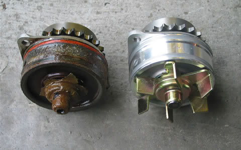

Maxinout brings up a point that I tend to forget about, at least this early in the diagnosing. The water pump. Leaking coolant is not the only way the water pump can go bad. If the antifreeze solution has depleted all the anti-corrosion chemicals, the impeller blades will corrode away and the coolant flow is slowly reduced to nothing. The only way to diagnose this is to remove the water pump and look at it.
Here is a photo of a corroded water pump, originally posted by nestor lugo:
That image is giving someone heart attack!
