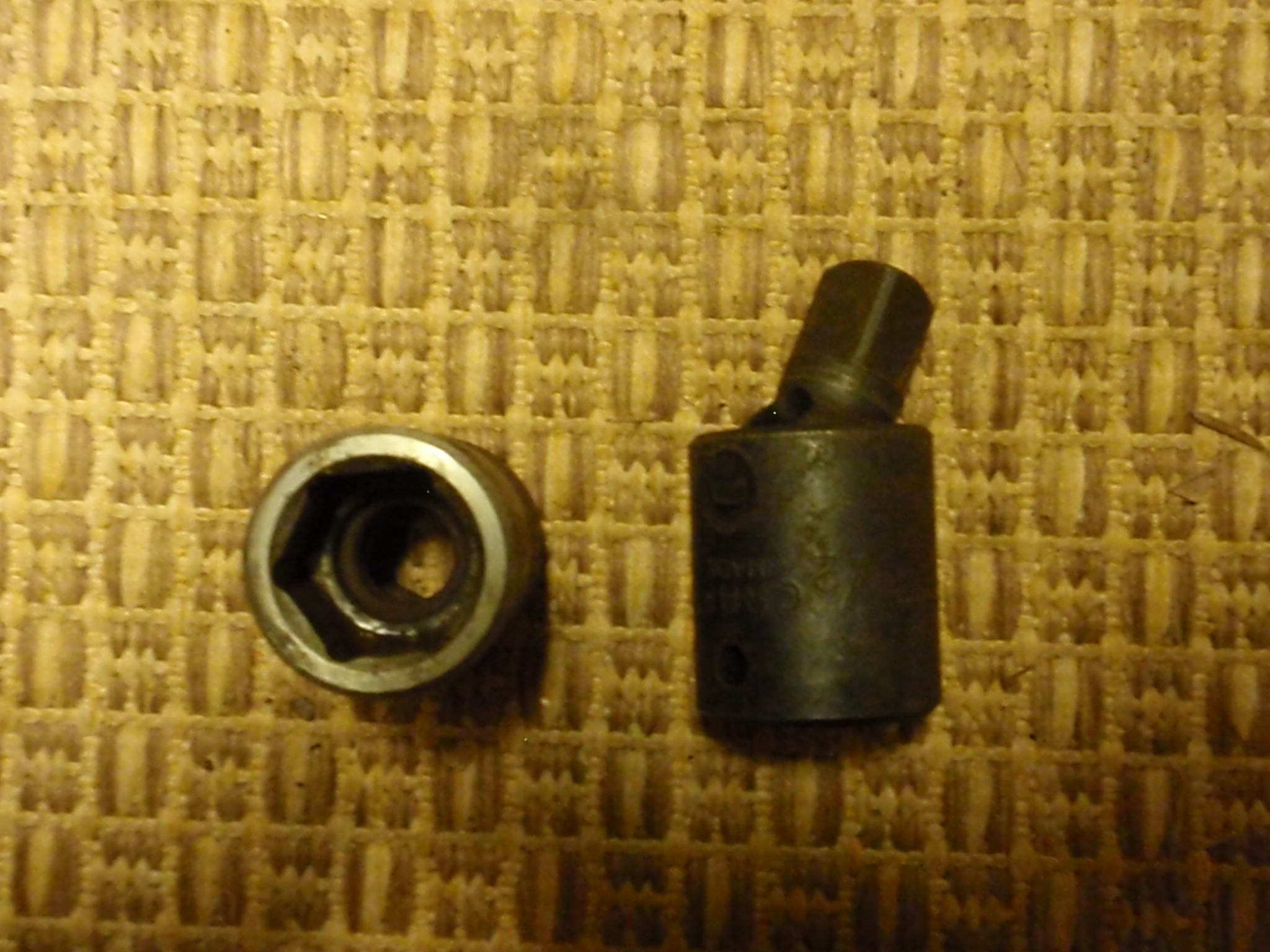

So somthin' like this is what you recommend; socket + swivel extension?
Attached Thumbnails Size wrech needed for front lower ball joint-socketext.jpg
Old Oct 5, 2016 | 04:26 PM
Child_uv_KoRn's Avatar
Bad *** Newb
Posts: 4,975
Forgot about those. That'll work, too.
