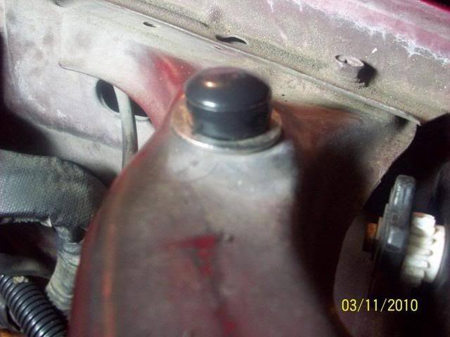

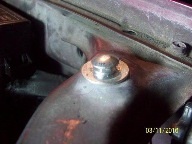

This is A carriage bolt and washer....
These rubber tips are found all day in hardware store for $1.00
Together this is what it should look like...
