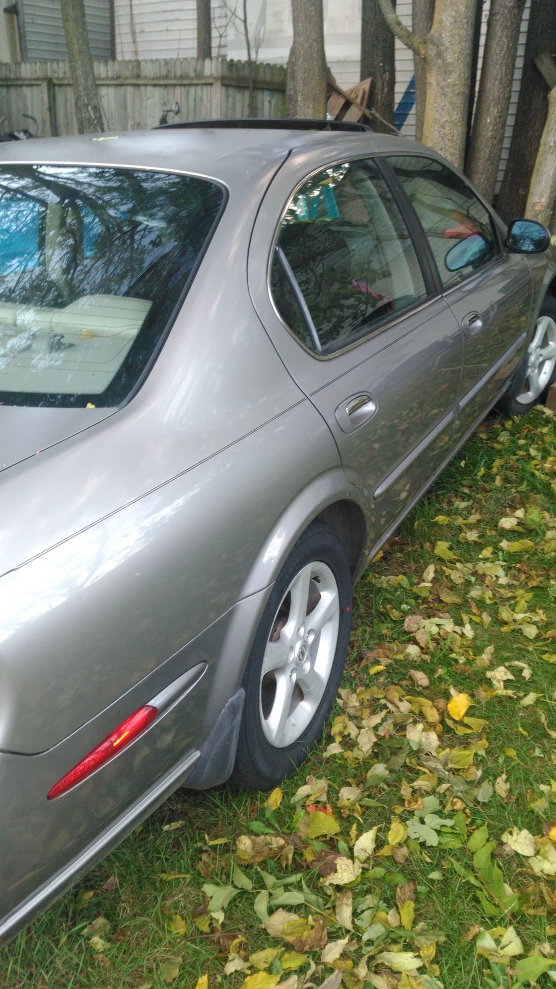

I bought this 2000 maxima about a month ago. Has 138,000 miles. It started overheating on the way home. I've replaced radiator, thermostat, water pump, temp sensor. It's fine when it's idling, but as soon as I put it in gear, the gauge starts climbing. I can let it sit for 30 minutes in the driveway, but as soon as I pull out, it starts. We can't figure it out. Please help. I love this car.
