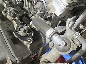

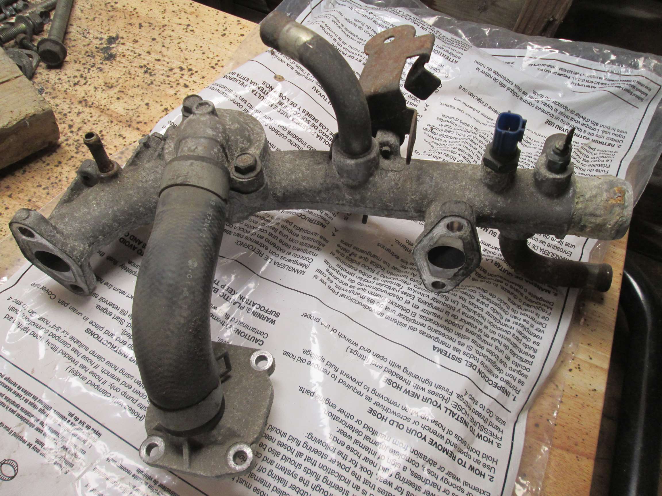

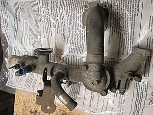

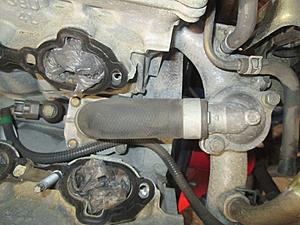

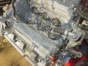

Nissan designed the same setup to be used in the 3.5 (.One time where the 3.0 dek was ahead) for better cooling.
Many 350z guys found this out and bought the 3.0 dek setup.If you look in the V on the 3.5 by the knock sensor you will see a square with 4 threaded holes ,this is where it is suppose to be.
Was big on my350z.com
Heres a picture of one
Attached Thumbnails 2001 Maxima thermostat-img_7147.jpg   2001 Maxima thermostat-img_7148.jpg   2001 Maxima thermostat-img_7149.jpg   2001 Maxima thermostat-img_7160.jpg   2001 Maxima thermostat-img_7161.jpg
