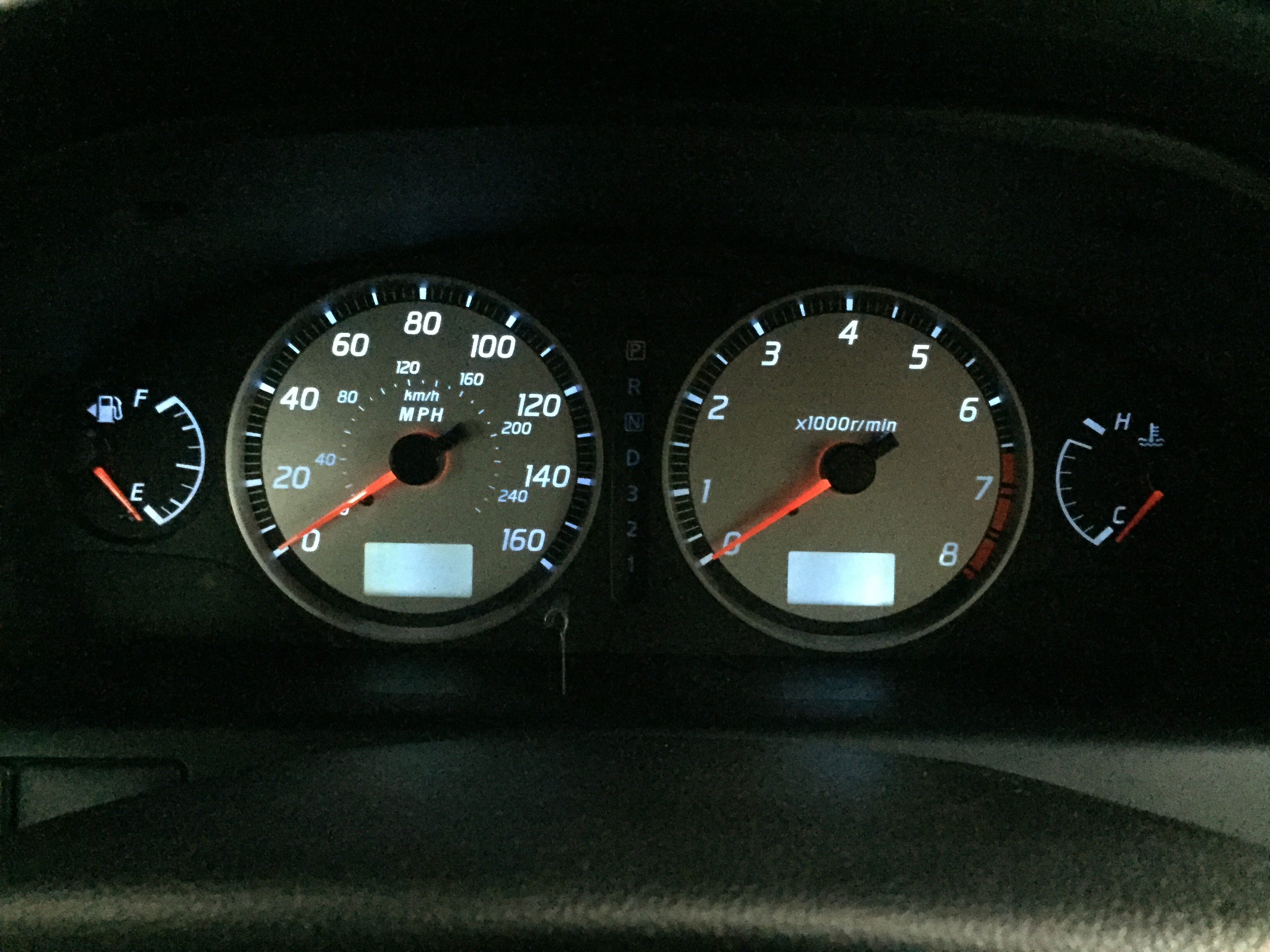

Just wanting to start a new thread on cluster LED options. Currently, I have superbrightled plug and play warm white 3 LED installed. I like the white color they produce in my SE cluster but don't love the hot spotting.
The hot spots are not as noticable at night, but at dusk they really stand out. I picked up some lighthouse LED flat top cool white to try out but they are quite blue in the cluster and didn't reduce the hotspots.
Cluster LEDs - 2018-20180921_131518-1612x1209.jpg In addition, they are a nuisance to install requiring resistors and custom fabrication to use the 74 base.
I found these vleds VLED 74 6 LEDand wondering if anyone had tried these out? I'd prefer a warmer color temp than they offer though.

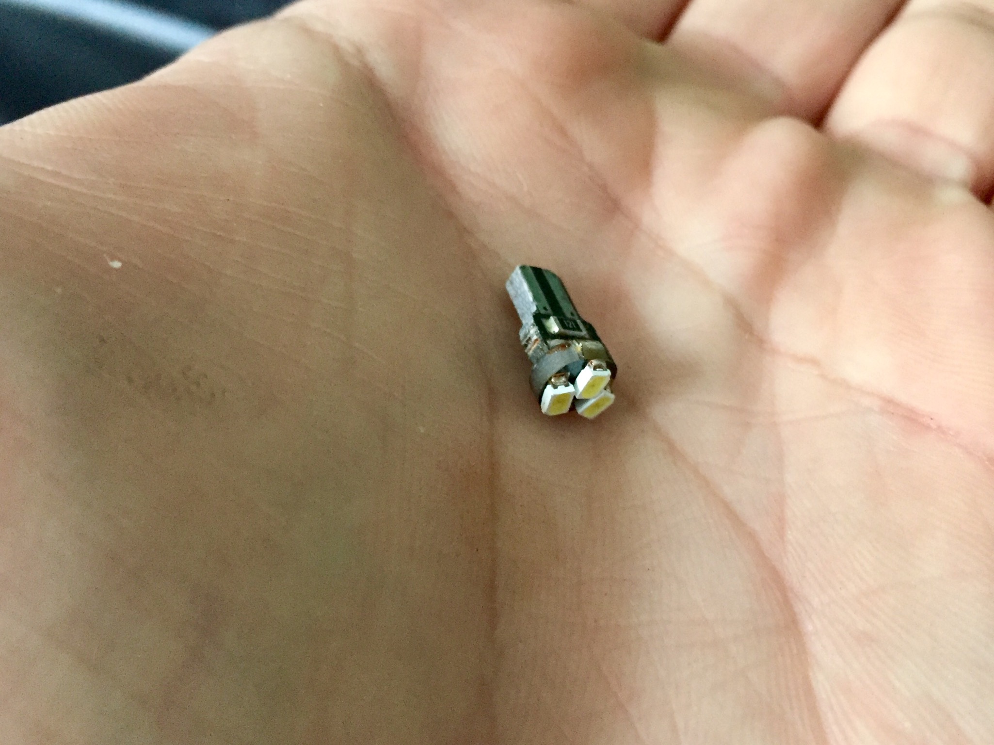

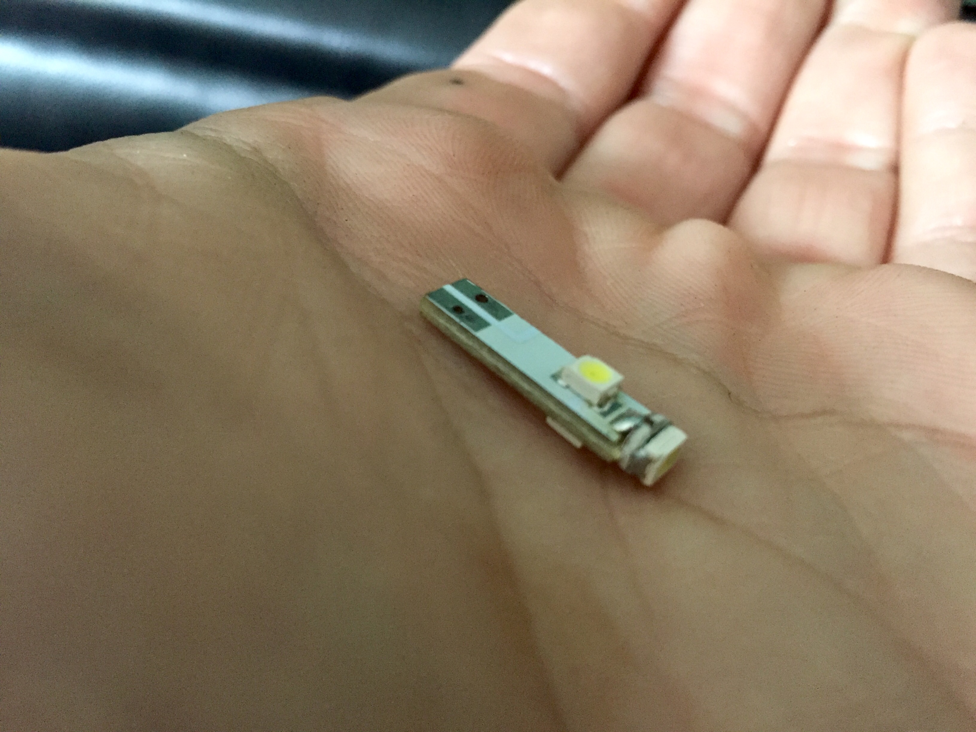

Checking back in. Still have some minor hot spots. Will likely be more apparent at night but not as bad as before.
First picture shows style of old bulbs, second pic shows style of new bulbs and third pic shows the new bulbs installed.
EDIT: Link to the bulbs purchased.
https://rover.ebay.com/rover/0/0/0?m...2F253064197160

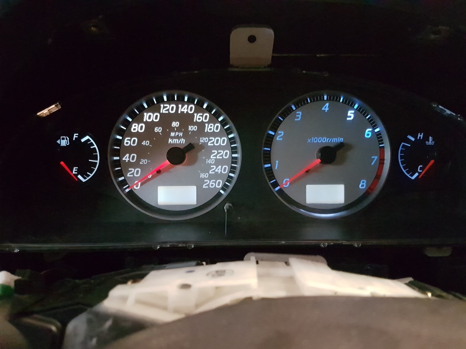

so I got "white" leds and it looks blue -_- I ordered new actual white leds and im gonna try again. the seller claims white .. nah blue

If you have an SE cluster you need to buy warm white ( yellowish) if you want the cluster to appear white and not blue.

5.5 gen clusters will always look blue because of the tint on the cluster face
