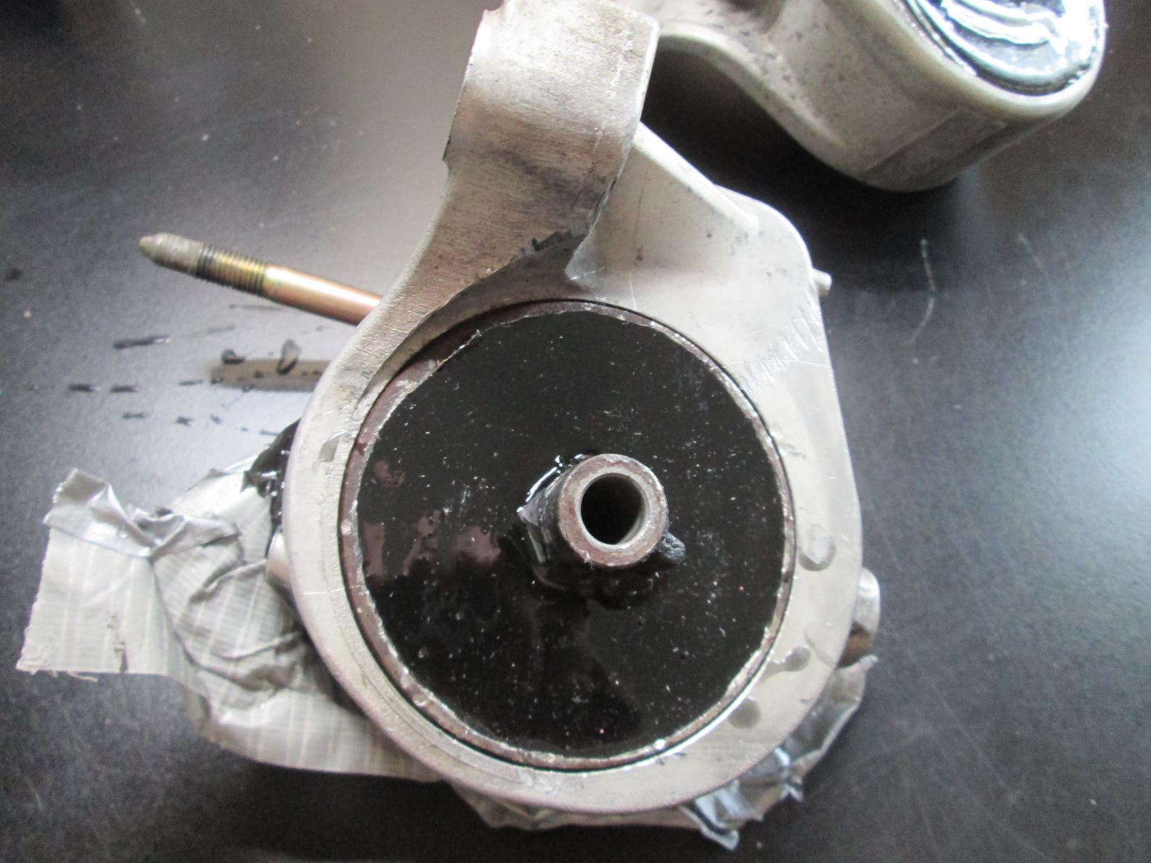

urethaned some motor mounts.

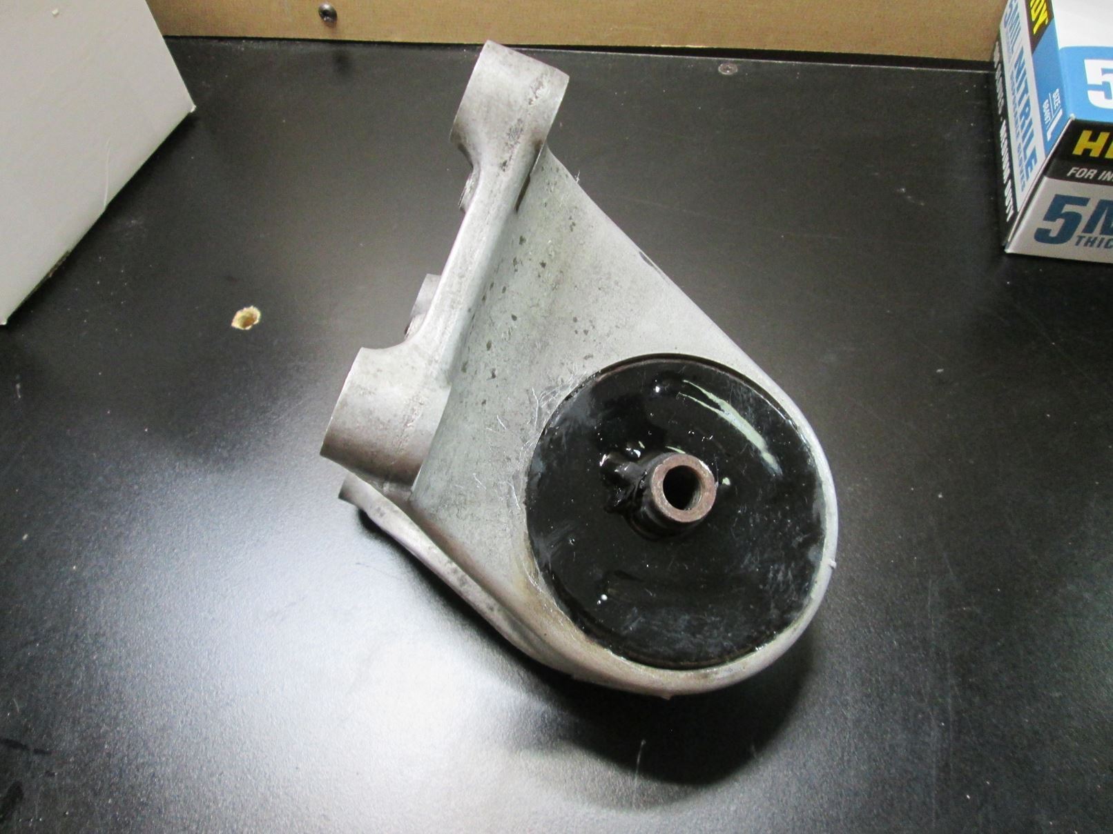

60 A Liquid Urethane MCmaster Carr $48 product , tax, and shipping. I think i had enough to make 3 but i didn't. Because i thought it would only make 2.
This only has a 15 min work time.So you have to have everything ready.

Nice! Those look great. I have all my old mounts from the swap because I replaced all of them with new mounts. I eventually want to do this and keep the set as spares. What method do you use to line up and keep the center pin/guide/whatever aligned during the pour?

I do not disconnect it. Picture a band of rubber running to both sides ,still holding the metal tube. I don't take it out. I keep just enough to hold the metal piece. I do this to make it easier and it makes the mount ,have a stock like feel.
I have been making these for 15 years. The car i raced with and ran 12's with slicks 15 years ago used these. And they still were the same ones after 15 years. I took them off and used them on each of my newer maxima's.
I don't think the'll ever go bad.
But i take a lot of rubber out ,even some metal on some.
But these are for sale,not for me.

I see, so you keep a web of material in the center, is that right? Sounds like fun. Care to post links to the materials you used?

https://www.mcmaster.com/catalog/123/3697
Its the 8644K24... $33.33
Two orders of it can probably do 5-6 mounts. Can be bought much cheaper (in bulk)but i was just doing a couple.
Manual mounts are much easier to prep. But i have used auto mounts also.

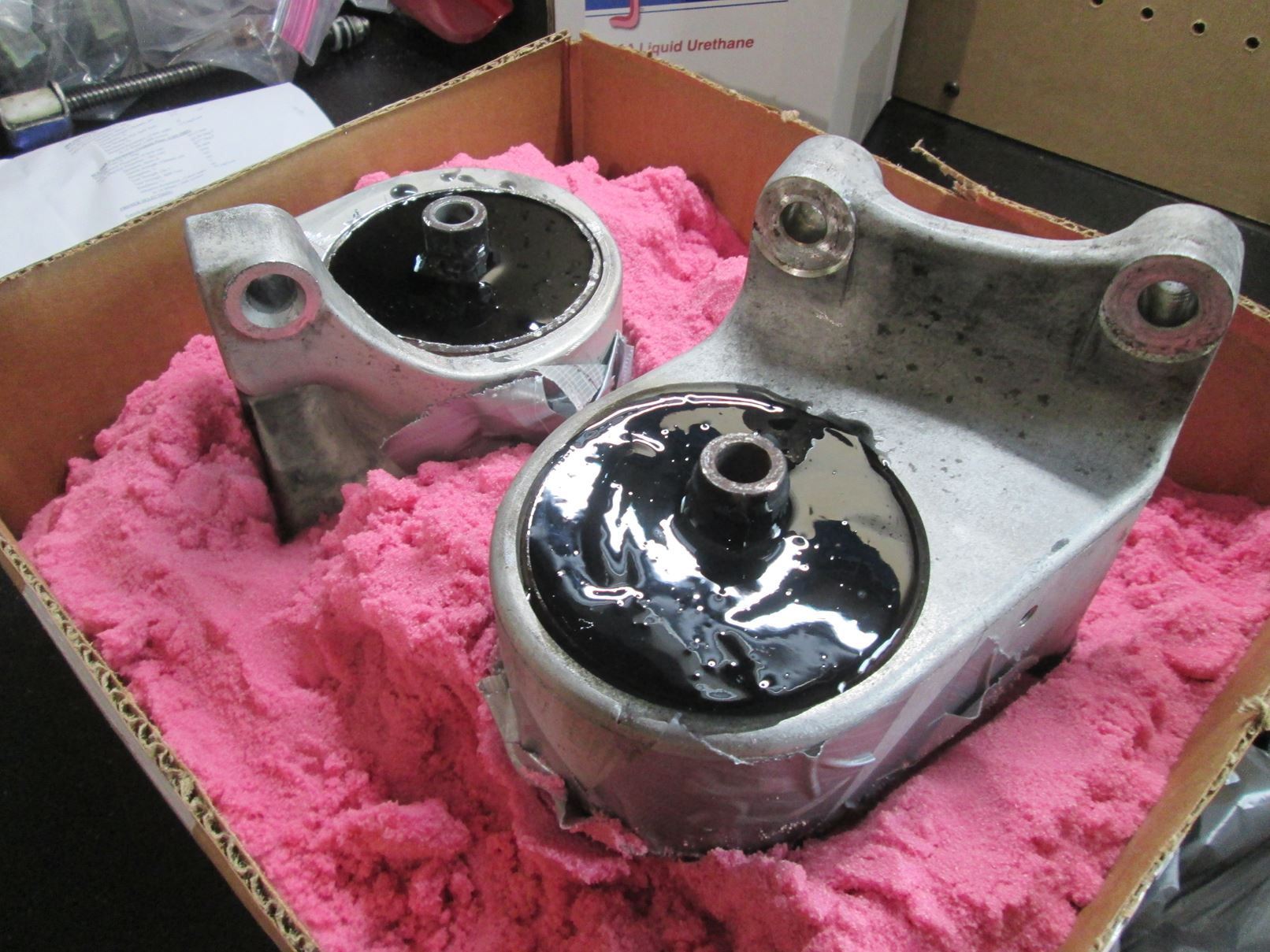

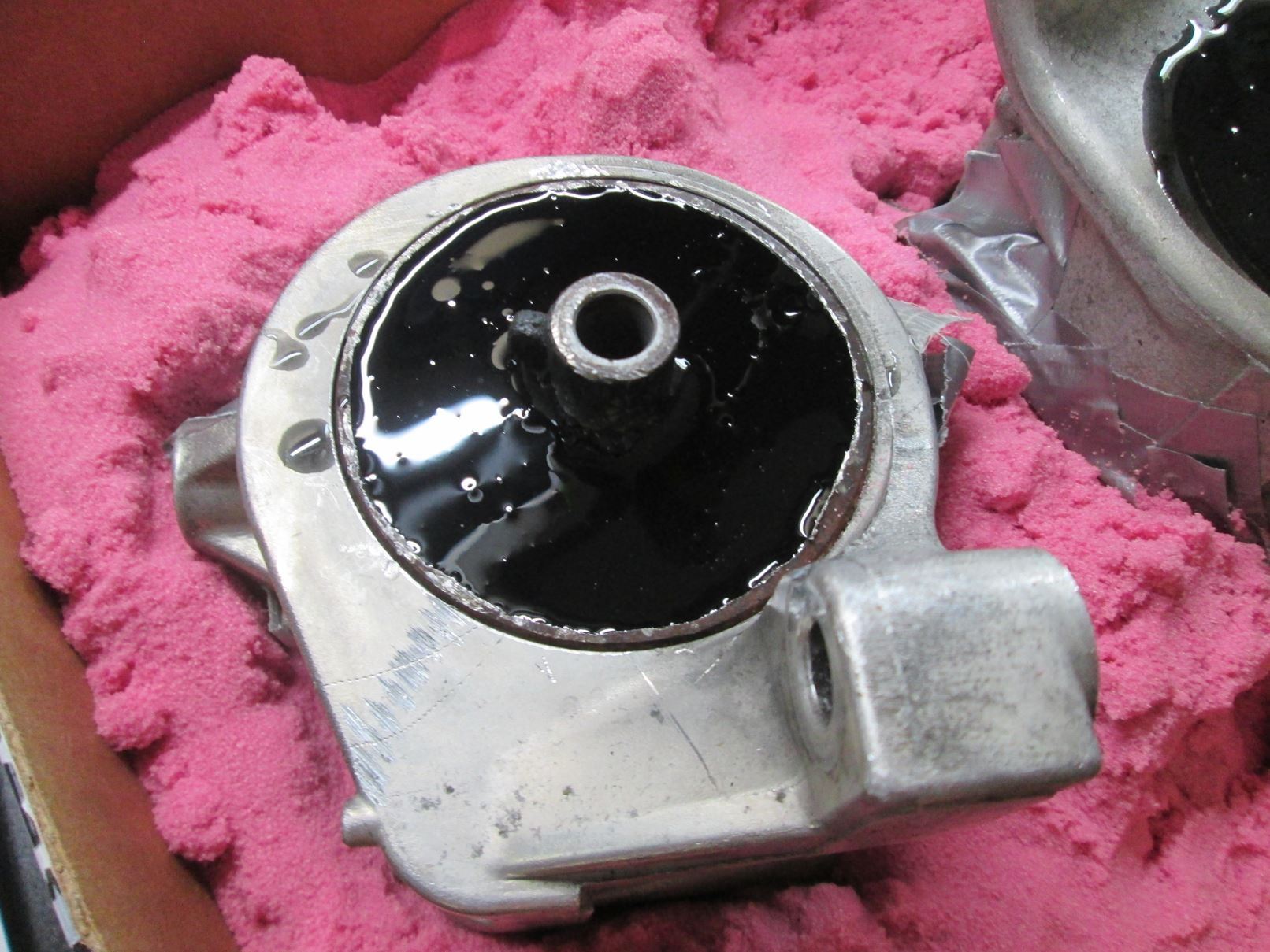

What’s that pink stuff? ... it looks yummy.

looks like play sand so he can position the part to be perfect for the urethane pouring, good idea OP!
