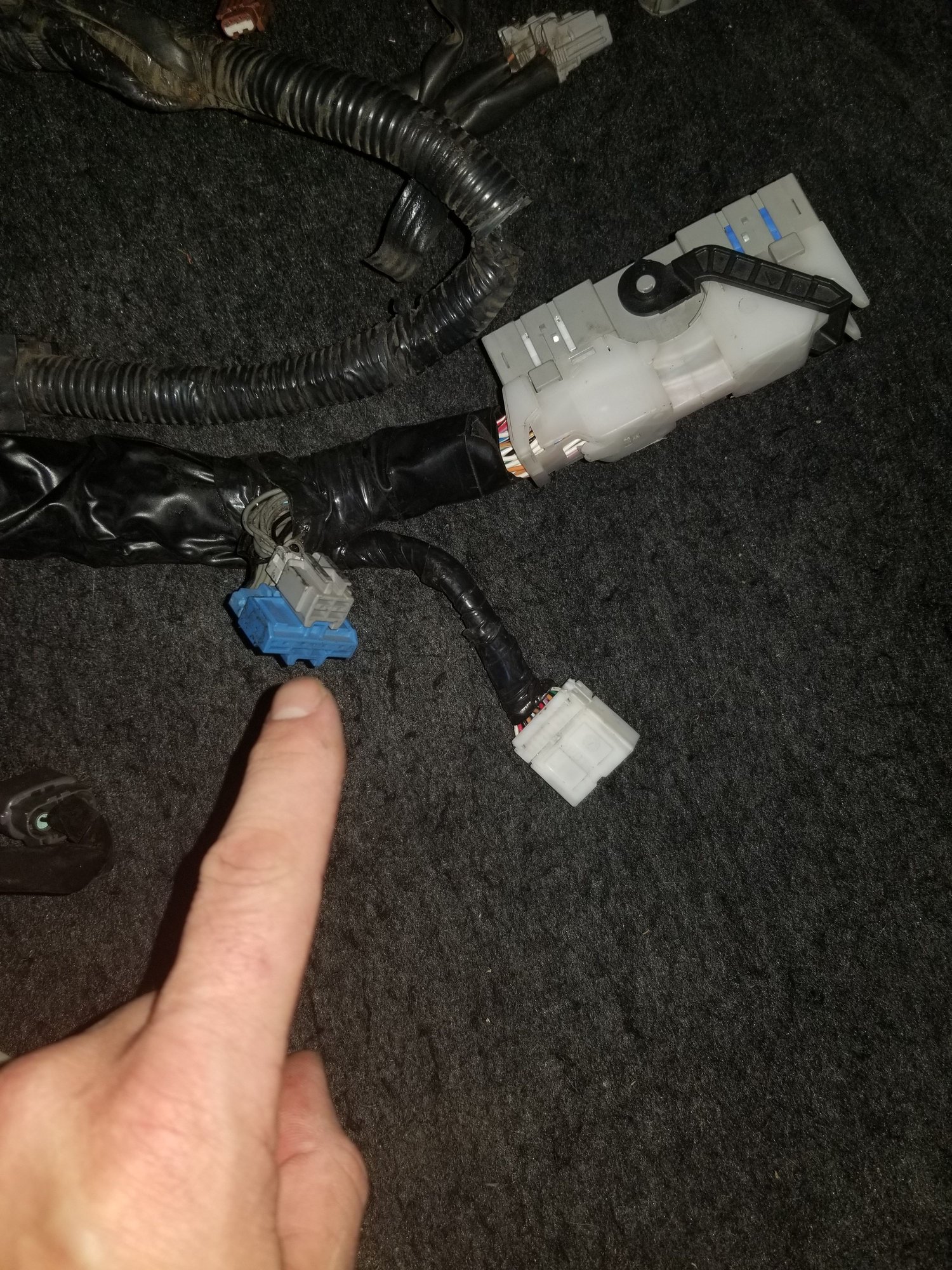

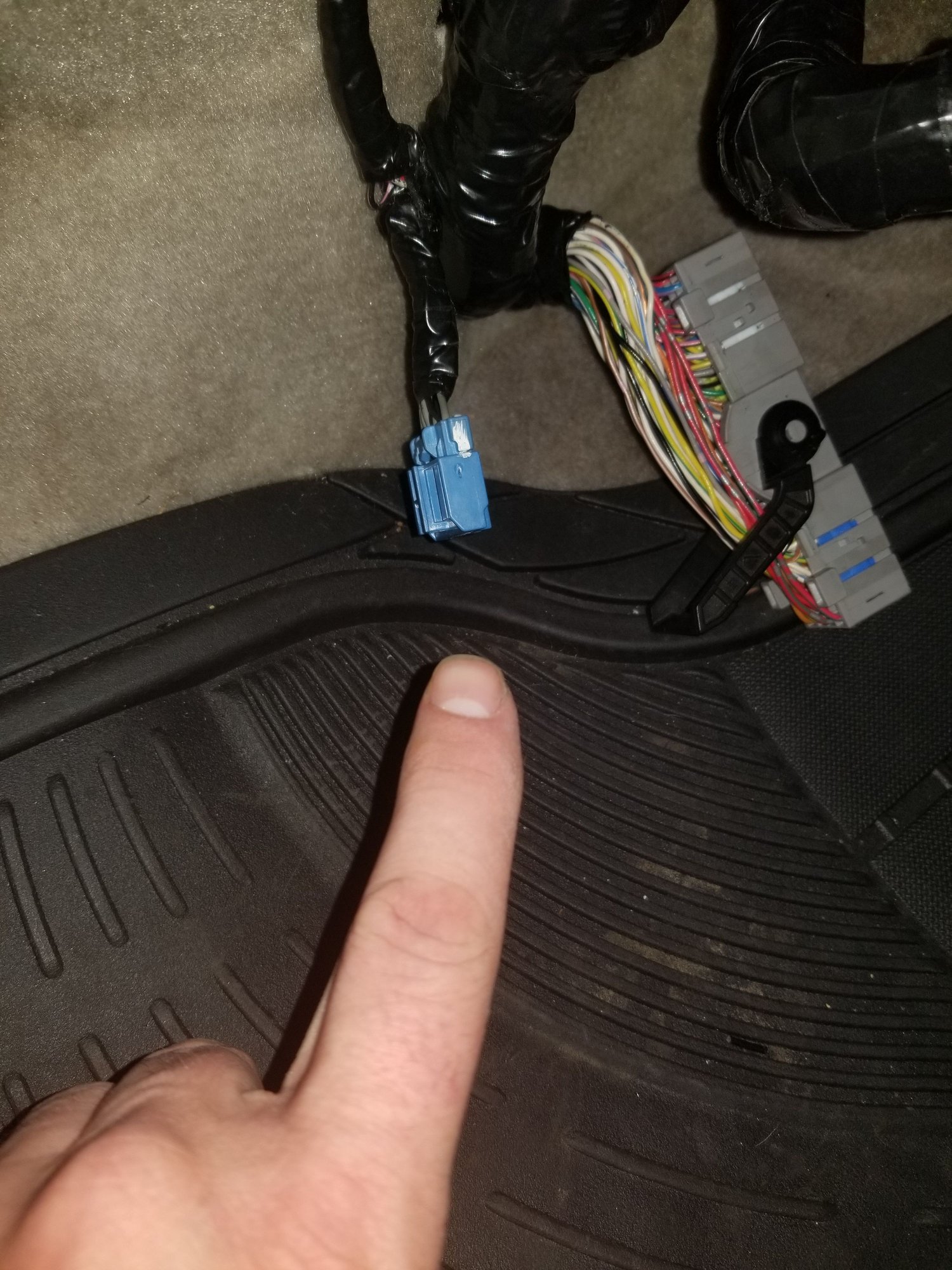

Under the dash the harness in the car now there is a blue plug right by the ecu not in use and the new harness has the same blue plug but there is a grey plug hooked to it, any ideas what it's for?

I belive your talking about the boost sensor. Some cars have it under the hood some dont.
Does the plug look like it plugs into this.This is a boost sensor from my 01 maxima. It's on the ECU bracket.

I have the same thing you pictured. The blue plug in the bottom picture is not plugged into anything on the harness in the car now. The top picture is the new harness and it has the same blue plug but with a grey plug. Any ideas on this one? Thanks

I don't think that's a plug at all. Just leave it alone.
