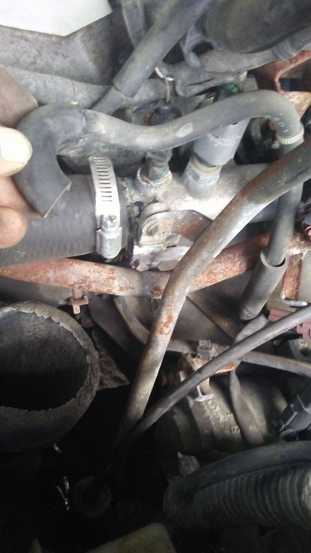

Vac lines near sensor
Anyone tell me where this should plug in?
The hose im holding..looks like it should plug into air box but no male connector anywhere.
Starts right behind under starter

I'll save child the grief: Looks like a tranny vent, dude. Check for vacuum leaks/unmeasured air leaks and pull your codes. Not sure about the VQ30 temp sensors and switches and stuff but does not sound like the two (surging and ECTS) are related. Let us know how it goes.
