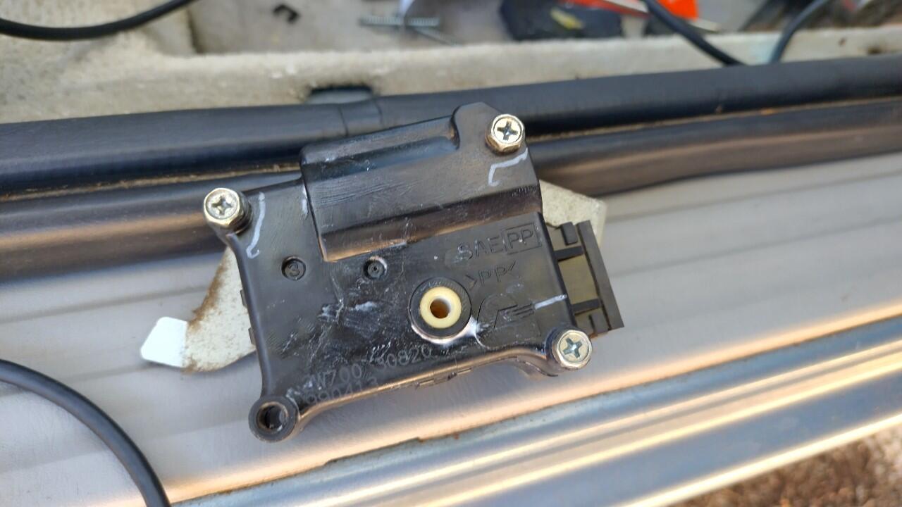

I first noticed this problem sometime in 2020, and just assumed that the actuator motor burned out. I found a brand new OEM replacement (Nissan Part # 27730-2Y900 - ACTUATOR-AIR INTAKE BOX) from an eBay seller from the UAE. After I installed the new motor, it seemed to work just fine for about a year. Unfortunately, it stopped working again. It would only work sporadically, so I would just leave the Recirculate button pressed until it finally activated, which could be hours, days, or weeks later. Curiously, any time I wanted to disable the recirculation, it would immediately retract the blend door with no hesitation. Therefore, only the forward motion was not working. I let this go for a while and, just a few days ago, I finally took the glove box out so I can work on solving this.
My first assumption was that the new actuator motor had failed, and perhaps it might have been a counterfeit part. Upon taking the actuator motor out and tested it while plugged in, I found that it would only nudge forward slightly when Recirculation was activated, and I had to push the actuator lever to get it to move all the way. But, when I pressed the Recirculation button again to deactivate it, the motor retracted all the way without hesitation. The fault seems to be only with the forward motion. Upon noticing this, I opened the motor actuator housing to examine the insides. It contains a small electric motor and a series of plastic cog gears. It had plenty of grease and I did not see any faults (such as dirt or debris getting stuck in the gears, like I had suspected).
As a next step, and in lieu of spending almost $200 to buy another brand new OEM actuator motor, I went to a local junkyard and bought two (2) actuator motors from two different 2001 Nissan Maximas they had in the yard, both of which had manual climate controls. When I came home and installed one of the replacement actuators, I found that the first junkyard actuator had the exact same problem. Just to rule out the possibility of Murphy's law, I tried the second actuator. Sure enough, this one also had the same problem. Now I have come to the conclusion that the replacement actuators are (probably) not faulty; the fault lies somewhere else within the vehicle.
At this point, I am going to do some research and try to come up with a solution. I will report back on the reserved post below to report my findings when I am finished.
Do not mind all of the loose wires and junk on the passenger side; I am working on a few other unrelated projects as well. The dirt on the ground is from me cleaning out a ton of dirt and pine needles from inside the fender.

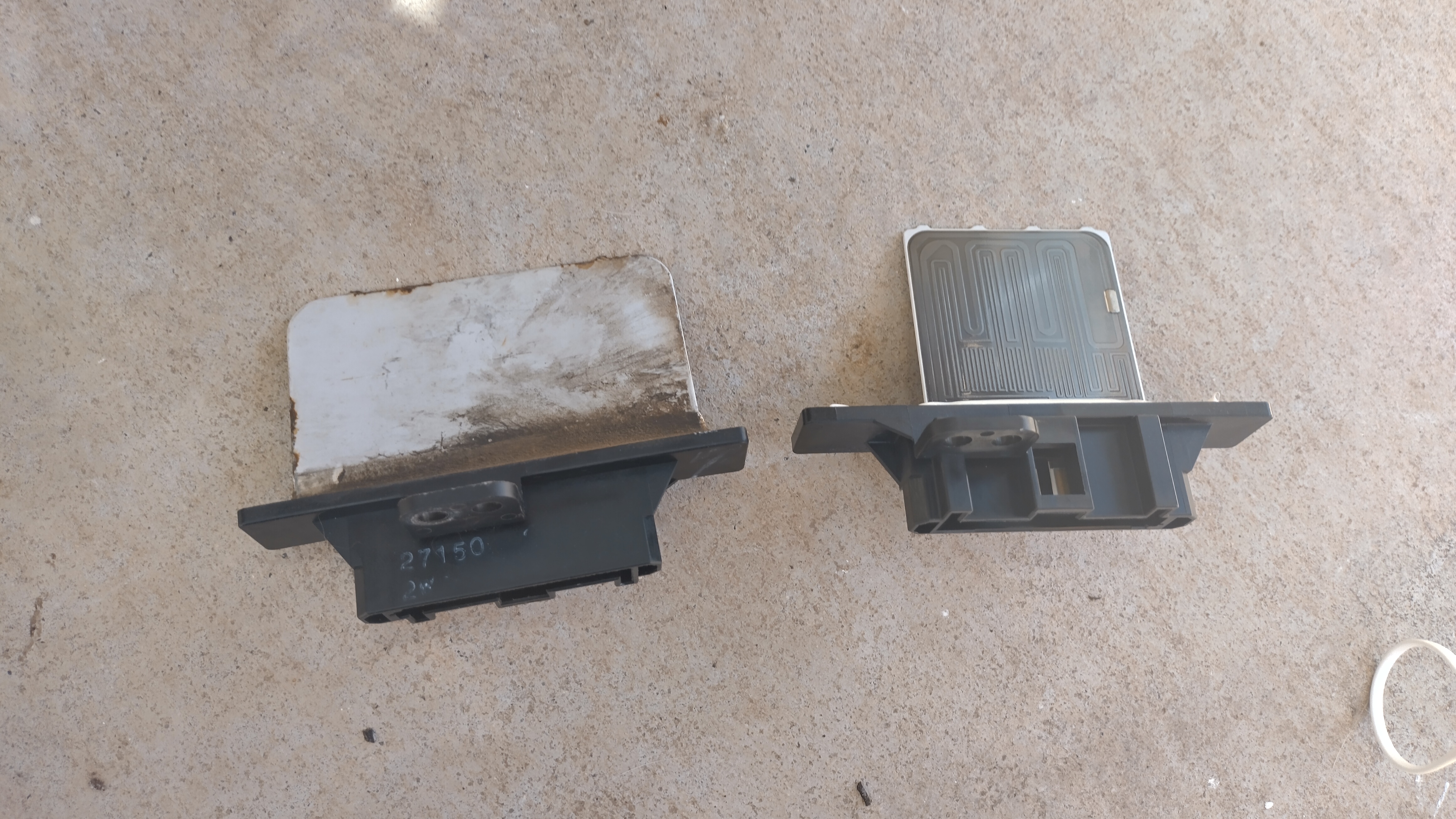

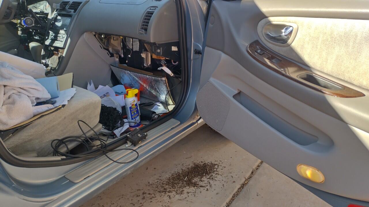

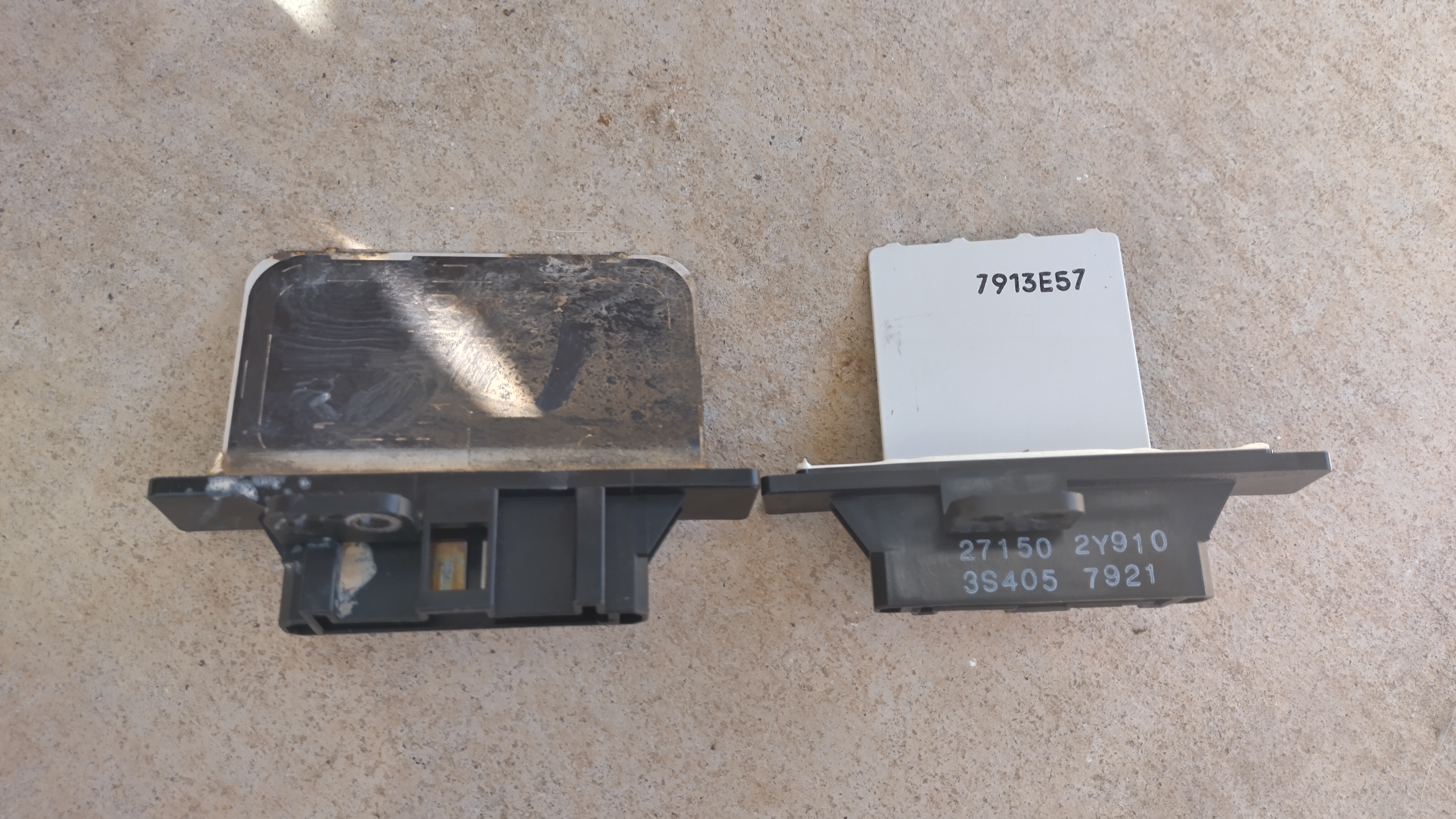

On October 16, 2025, I started by removing the glove box. I replaced the Blower Motor Resistor. The resistor was held in with two screws. One screw appears to not be original to the vehicle, suggesting prior replacement, but this is uncertain. The enclosed pictures show the failed resistor and the replacement, side by side. It should be obvious which is which. I reinserted the new resistor and reconnected it without incident. This immediately and successfully resolved Problem 3 (fan not working, except on highest setting). However, this did not affect Problem 1 (re-circulation door hesitation) nor Problem 2 (A/C activation delay after button press). I specifically tested for both upon replacing the resistor.
Admittedly, I was hoping this would be a silver bullet solution for all problems, but the resistor failure was probably just coincidental while the other problems were ongoing.

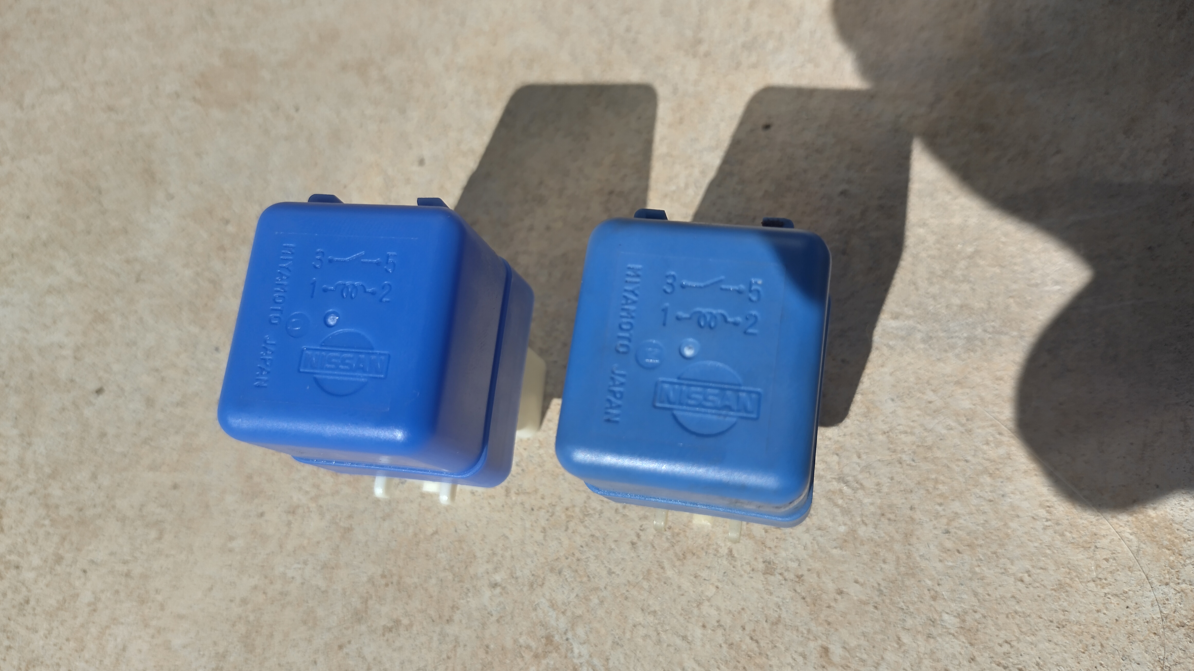

Following the successful resistor replacement, I turned the engine off and replaced the electrical relay for the Air Conditioner. A side-by-side comparison of the old and replacement unit is enclosed to this post. The old relay did not have any obvious problems, aside from discoloration (likely due to age), and I could feel something shaking internally when I shook the old unit in my hand. The replacement unit had no such shake. Unfortunately, upon inserting the new relay, the A/C delay did not resolve. This indicates the replaced relay was not faulty, thus ruling out theory of possible intermittent malfunction of the relay.

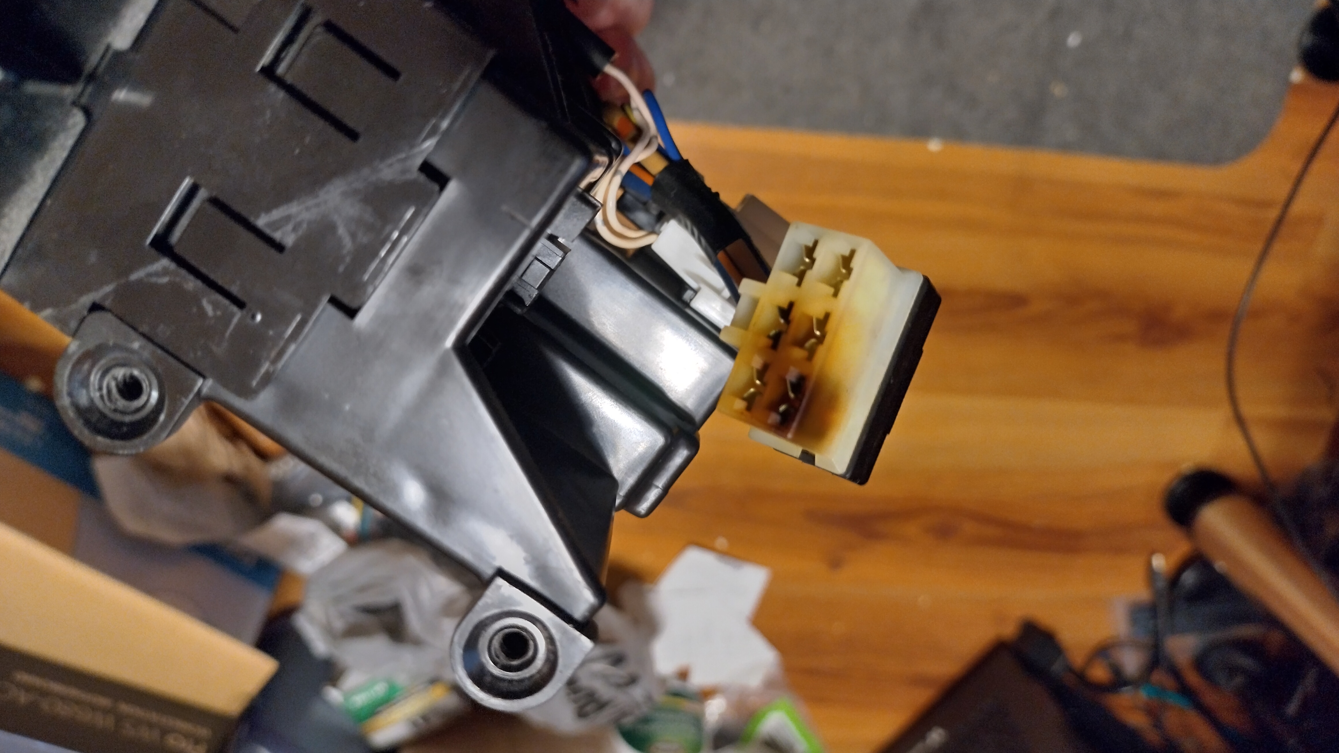

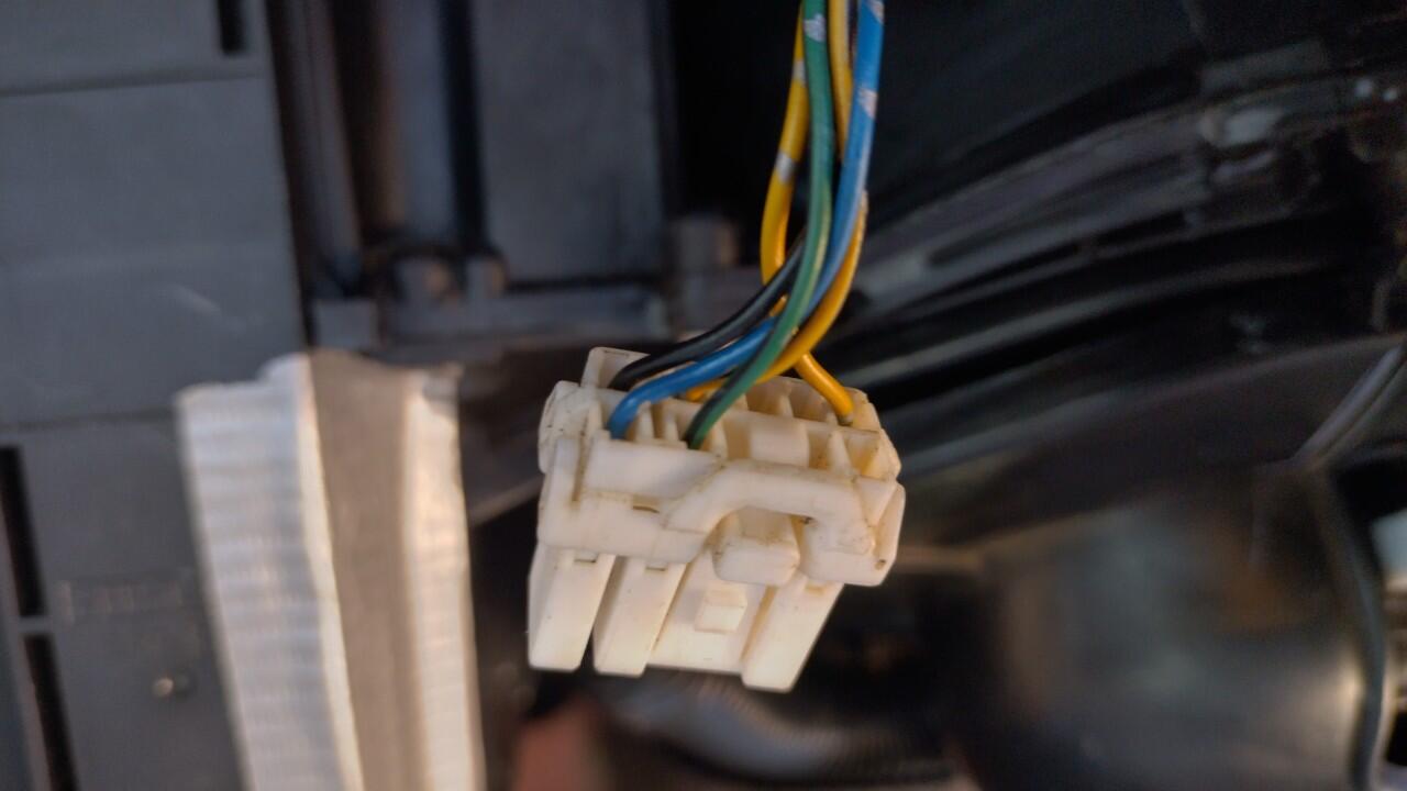

After months of on-and-off troubleshooting, I believe I have resolved the problem, and it was not what I expected. However, I made the error of performing multiple "fixes" at the same time, so I am unsure which one fixed the HVAC (recirculation and AC hesitation) issue. As I have noted in this thread, multiple unrelated electrical gremlins began to occur, usually one after another. I assumed this was due to either a failing car battery and/or the vehicle's electronics failing due to age. Neither appear to be the case.

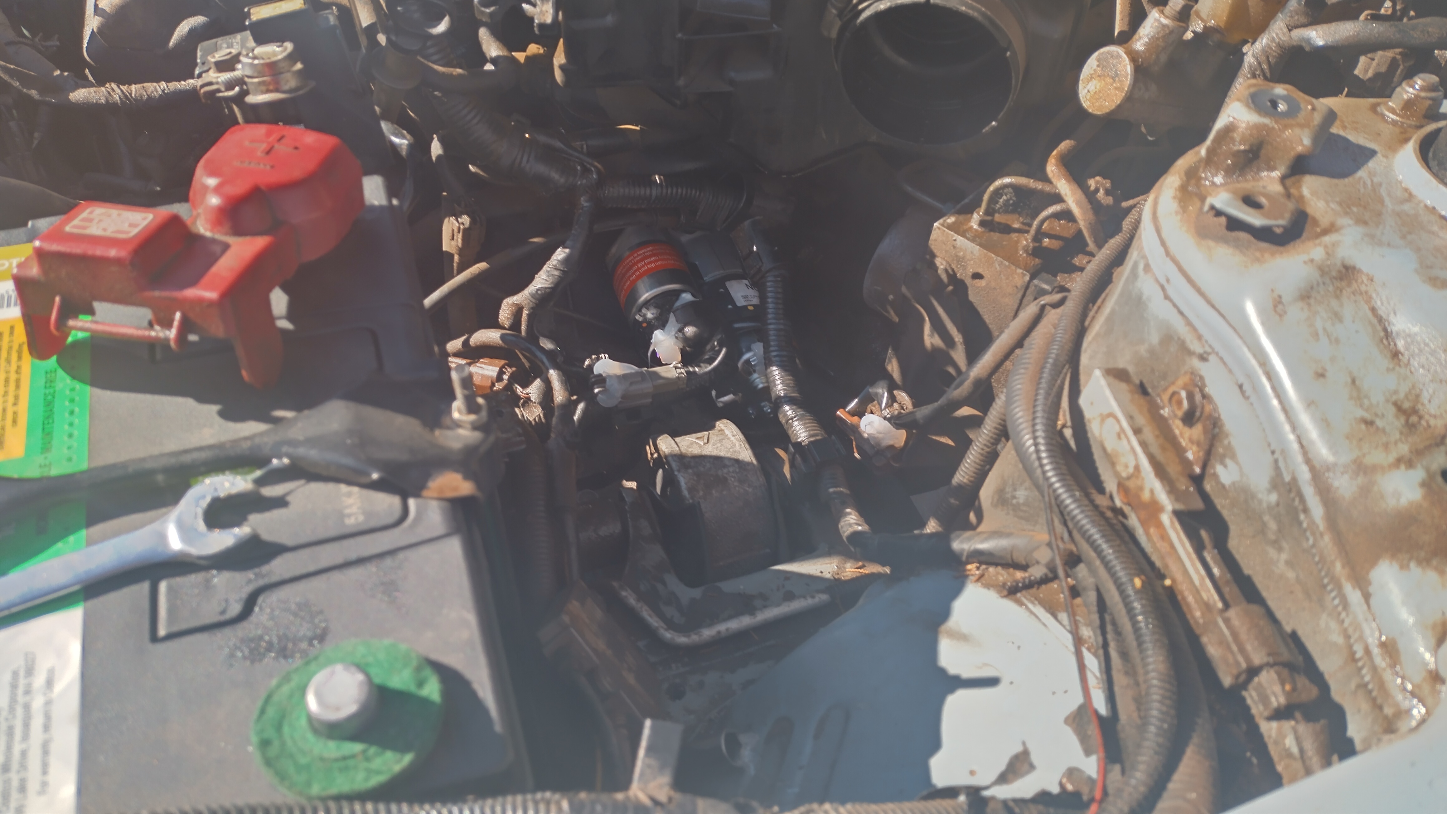

October 2025: I replaced the car battery with an Interstate battery from Costco. The old battery was a cheap brand and I do not recommend it. The new battery offered a negligible improvement, but did not resolve the issue(s).

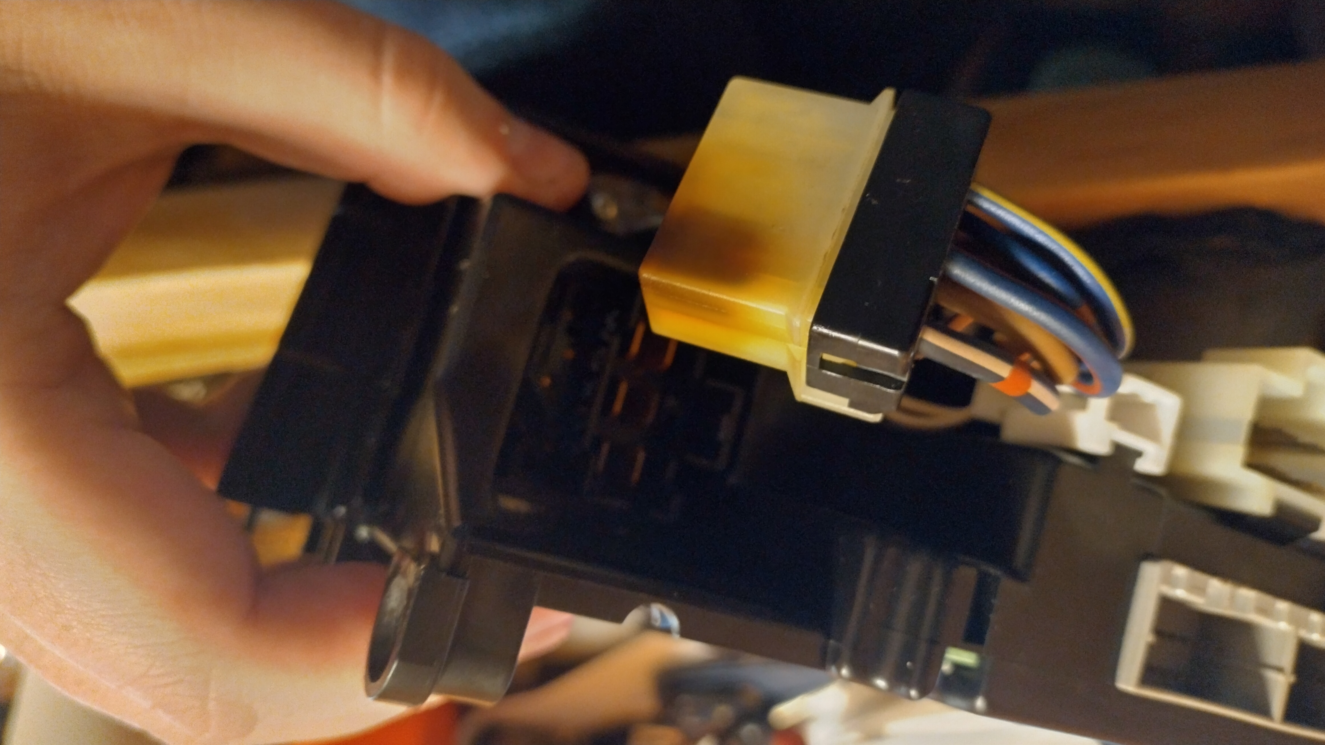

January 2026: I removed the stereo and HVAC system to begin more complex testing and troubleshooting. I also began to observe multiple minor electrical faults, such as the dash board randomly dimming when one of the turn signals were on, the driver side window not working, courtesy lights flickering, etc.
February 2026: The starter motor failed (last replaced in early 2011). I replaced the motor. During that process, I took out the air box and noticed that the battery's ground cable (where it connects to the chassis) was very dirty and corroded. On a hunch, I bought some brass cleaner (Brasso, 8oz; about $5 on Amazon) and steel wool and meticulously cleaned the brass connector and the part of the chassis that it grounds to. I also replaced the battery's negative terminal because it felt loose. I also cleaned up some of the electrical grounds in the engine bay and inside the cabin, under the dash.
At about the same time, I took apart the HVAC control unit to replace the interior lights (the LEDs I last used in 2011 caused hotspotting, so I wanted to use this opportunity to fix that). In doing so, I noticed that the connector to the fan control had heat/burn damage! (see enclosed pics). The pin where the damage occurred connects to the wire that sends power when the fan speed is set to "4" (to bypass the blower motor resistor). I have no idea how that happened. Nonetheless, I used the same brass cleaner and cleaned those connections out. I also swapped out the fan switch (not the whole HVAC unit) for one of the junkyard units, just for good measure.
March 2026: Once I got the new motor in and reassembled the air box, and reinstalled the HVAC unit, I found that all of the issues were completely resolved! No more electrical gremlins, no more flickering/dimming lights on the dash, no more AC hesitating to engage and, most importantly, the Recirculation motor now works without hesitation. Moreover, the battery no longer goes dead after just 2-3 days of no driving.
PROBABLE SOLUTION:
Unfortunately, I didn't think to document and test each part of this process, so I am unsure which step actually fixed the issue. However, I would bet that cleaning the battery ground/chassis cable likely fixed the electrical (and HVAC) issues. Apparently a bad battery ground connection can cause all of these issues, and supposedly can also cause the battery to drain/discharge rapidly (something about amperage and higher resistance, from what I read). If anyone in the future has this problem, I recommend to start with cleaning/repairing the main ground with brass cleaner. It's an easy $5 solution that can be done in one afternoon.
