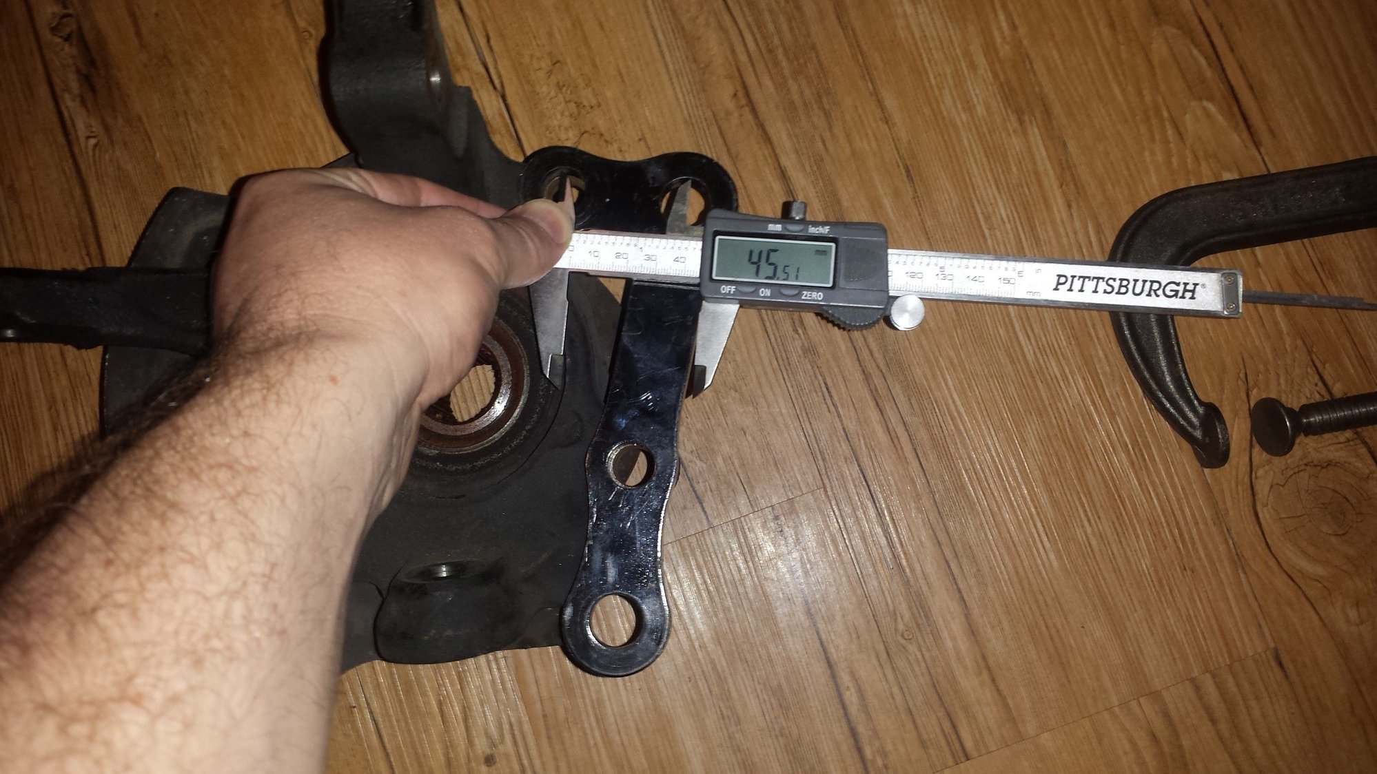

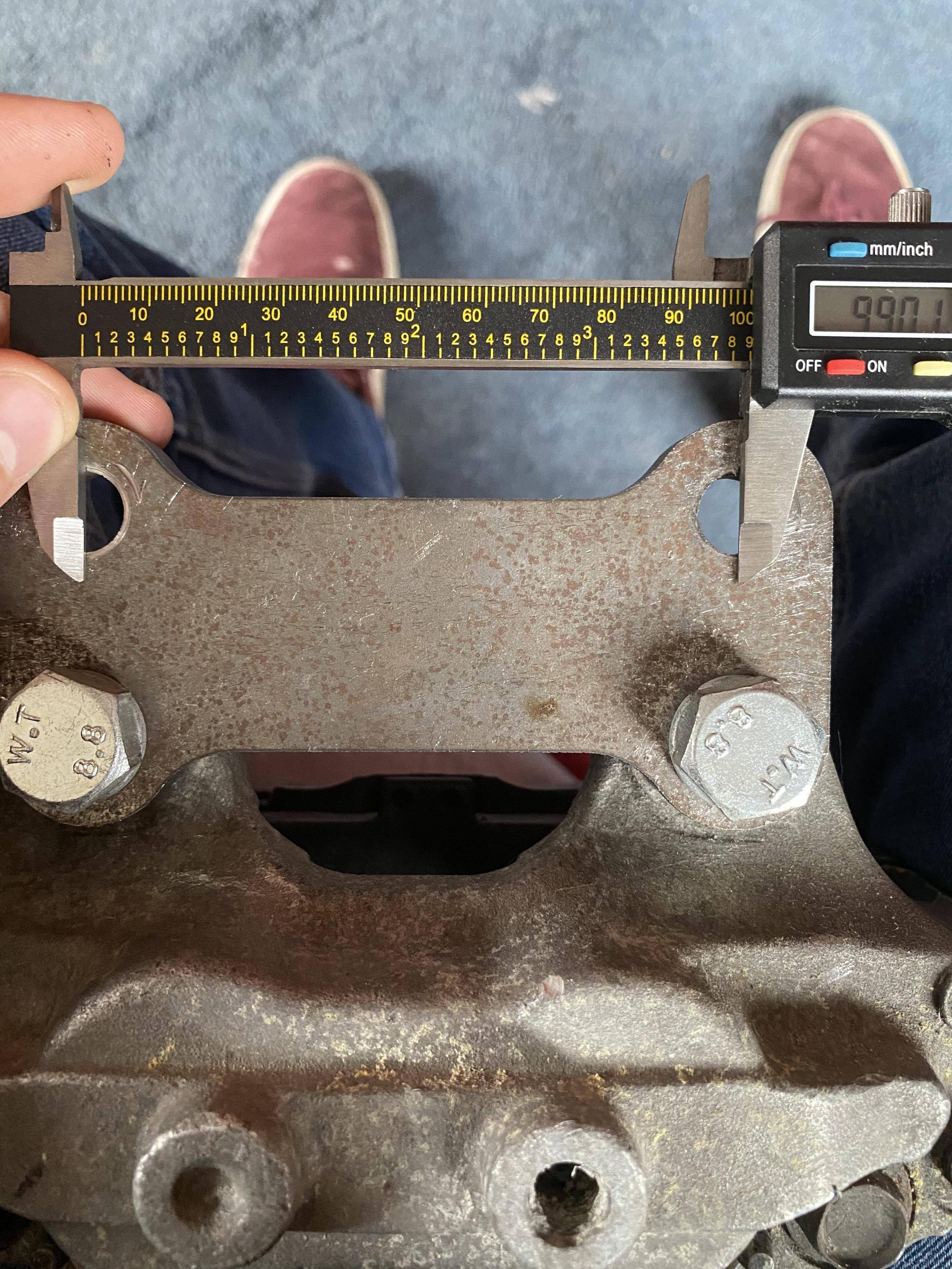

Finally remembered to dig out and measure those 300zx brackets like i promised.
About 9.5mm thick, with roughly 98-99mm distance between the holes top and bottom when measured from centerline. Side to side is about 32mm with those holes.
Again, these are for the 4th gen (95-99) so they are not made for our cars. But Im extremely curious what the distance is between bolt holes on our spindles. Any chance you happened to take a measurement of that? If by some miracle that distance is the same as the 4th gens (doubtful) then theres a chance these can get rigged up on a 5.5 gen. I want to upgrade my brakes from stock, and right now the plan is to just use 6th gen brakes, but having some nice eye candy 4 pot calipers that say NISSAN across them would look pretty damn nice.

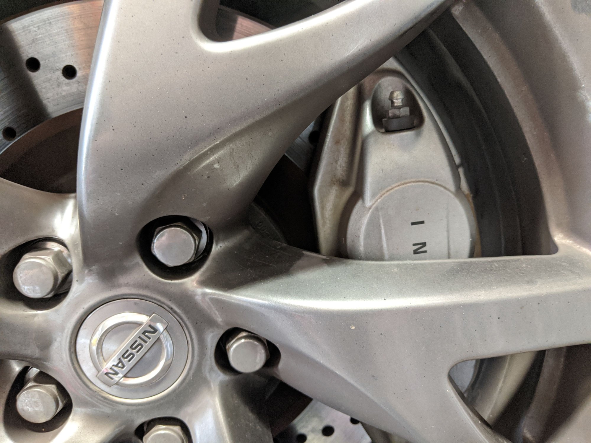

What dimensions are you looking for? I have the sport package on my g37
Old Apr 17, 2020 | 03:38 PM
  #44
User1's Avatar
Joined: Jun 2018
Posts: 2,493

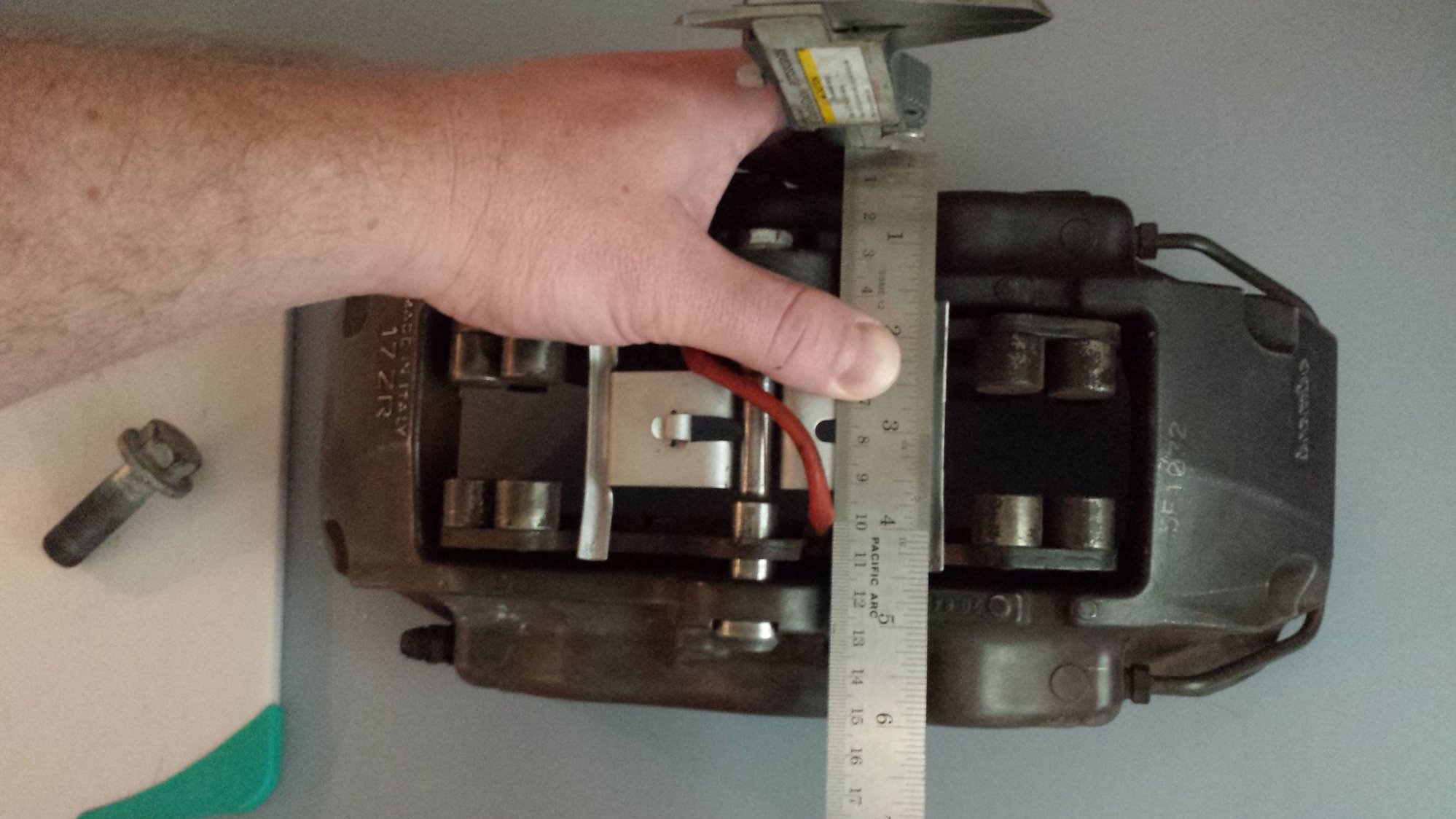

I need to know the width of a front caliper at it's widest point.

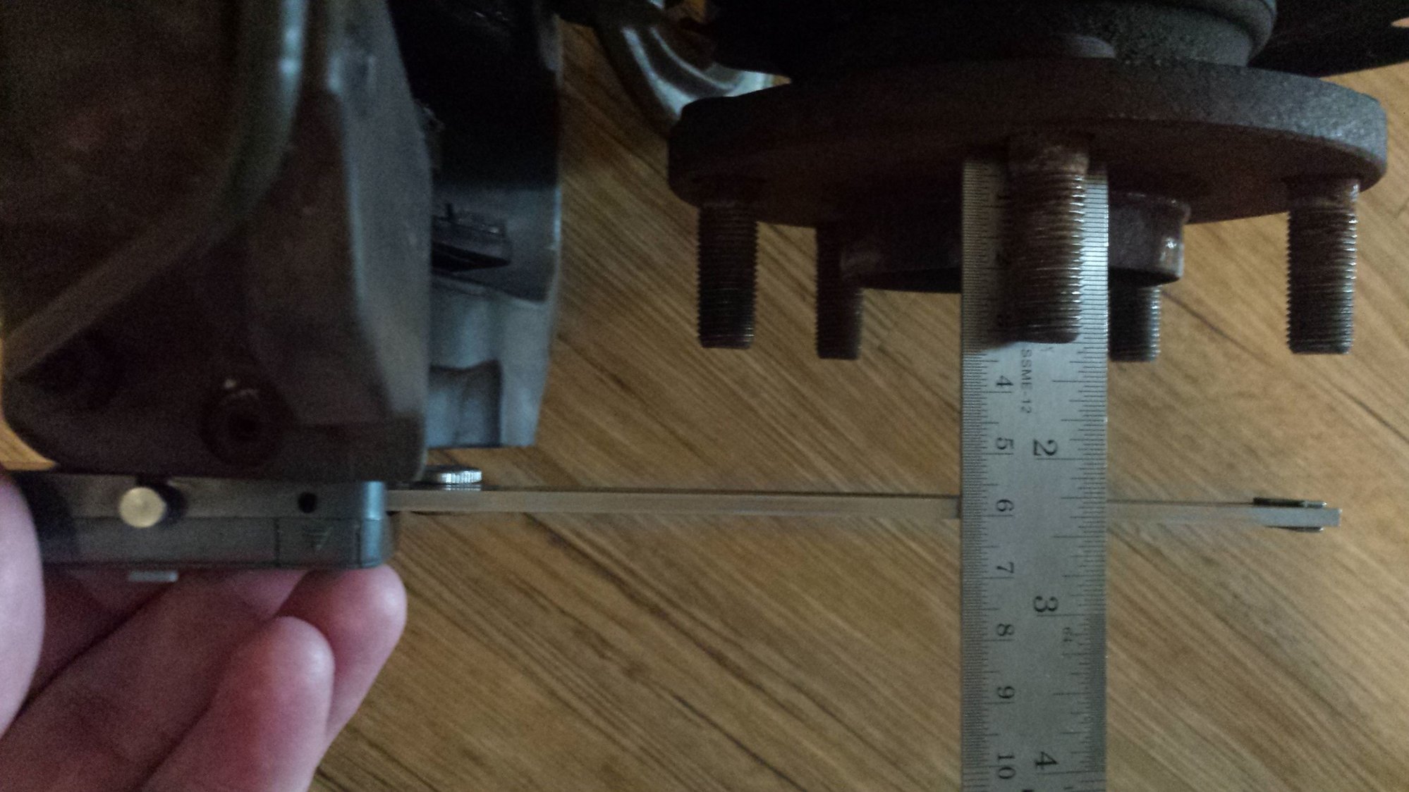

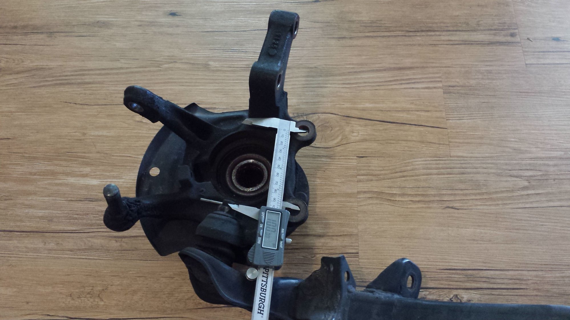

Odd, because I got 100mm when I measured for the adapters. Also note, however, that the bolt holes for 5.5 gen are M14.

So for slamrod, 4th and 5th gen mounting tabs are the same at 100mm, the only difference is 5th gen bolts are M14 and it looks like your Z32 bolt holes are M12. Easy mod, just drill out a couple mm.

Looks like width is right at 150mm. Looks like caliper extends 2.25" past the hub surface. Quite a caliper. Big sucker!

I just got home but I see you got what you needed
Old Apr 17, 2020 | 04:34 PM

The width of the red part is what I need. By measuring your caliper total width, we can divide by 2 and get our answer. If the answer is less than 75mm, we are good to go, as this means any wheel that you can run, I can run.

Not really sure this will help you though, as my bracket is an odd shape, not a symmetrical dog bone like yours
Old Apr 17, 2020 | 05:18 PM
  #55
User1's Avatar
Joined: Jun 2018
Posts: 2,493
Slamrod, your bracket will work, the limitation will be rotor diameter. My brackets were designed for 355mm rotors. I think your bracket accommodates 320mm/12.6" rotors, or the same rotors 6th gen Maximas and 350Z. I'm running the 320mm now with my 2008 350Z brakes. So for $99 bucks you can pick up this pair of rotors (what I'm running now, and I have another pair on order right now because I'm going to mod my 350Z calipers rather than cut down rotors -in case this Brembo thing doesn't work out-)

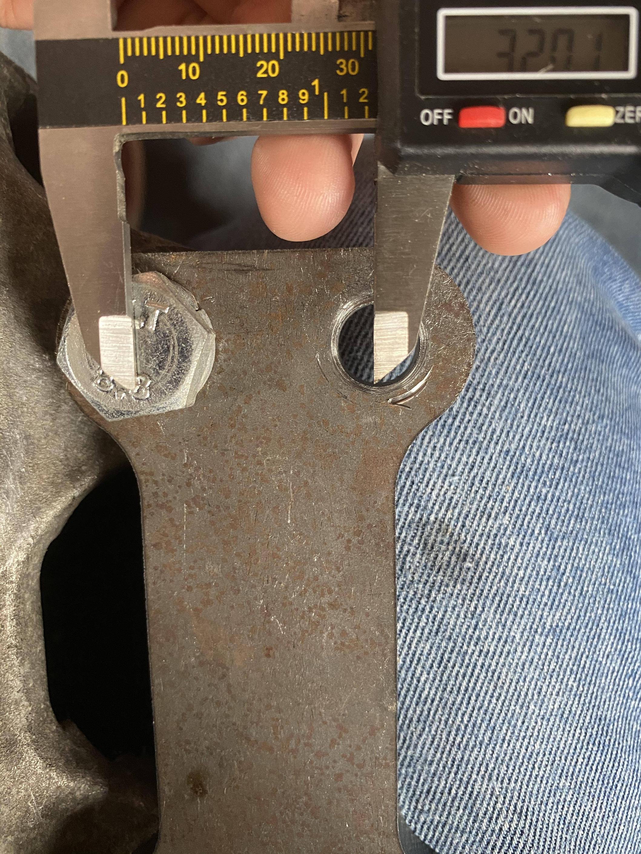

Everything is the same except the 5th gen caliper mounting tab bolt holes, which are M14. But don't quote me on that So you would have to drill out two of the bracket holes. No big deal. I think you're right about the rotor, your bracket is for the 13" Cobra rotors. Do you already have wheels that will clear those calipers?
No idea why I didnt search until now lol. Youre right, the only real difference is the bolt hole size. They should fit perfectly other than that. Still gotta get hub centric rings for the rotors though.

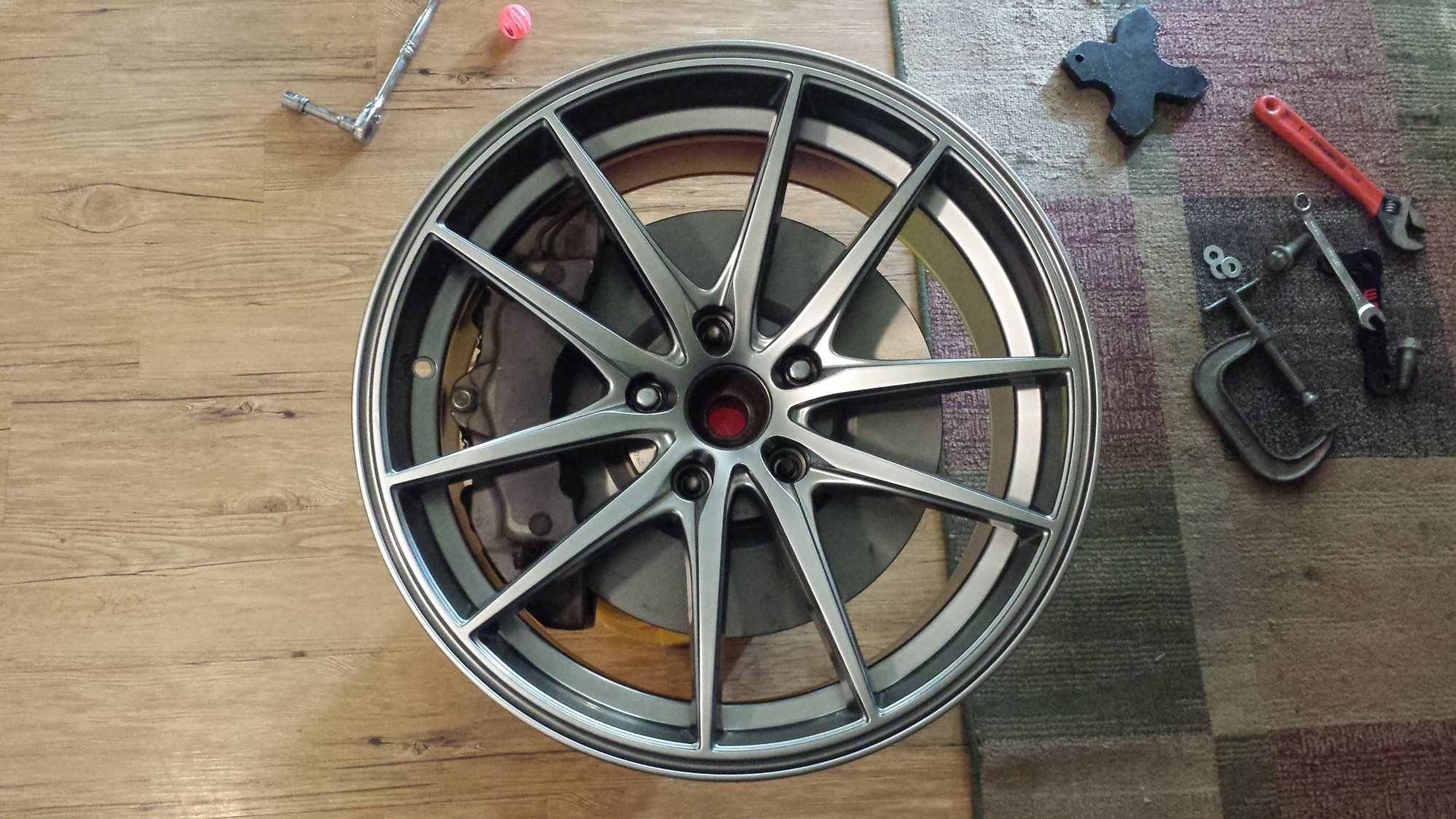

I win!!!!!!!!!!!!!!!!!!!
Old Apr 19, 2020 | 03:13 PM
  #65
User1's Avatar
Joined: Jun 2018
Posts: 2,493
That's the practice rotor I bought to replace my existing rotors, so 12.6". I have Z1 Motorsports putting together a pair of two-piece 14" rotors in blank, not fancy cross-drilled or slotted or any of that nonsense.
I am SO relieved right now! Because I don't have to keep looking for another wheel! I really like this open-spoke design. Displays the caliper well. I will however, need a 5mm wheel spacer to have adequate wheel spoke clearance. It just BARELY clears right now and I have the caliper bracket offset 5mm on the spindle to center the disc. I hope using a 5mm washer between the caliper adapter and the caliper mounting tabs on the knuckle won't cause any problems?
Also, I'm not educated in wheel spacers because I despise them and never cared to understand the adaptation of them, but I will now lose 5mm of stud, how do I make that up? Do I have to press out the old studs and press in longer ones???
Anyway, Fuuuuuuuuuuck YEAH!

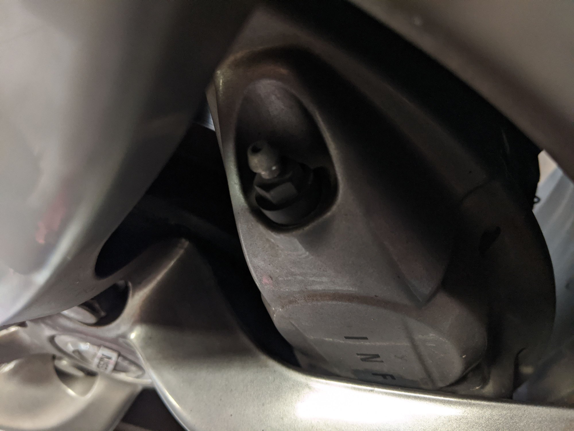

These brakes are cool. I just put some proper wheels on, but WILL be running the stock 17s in winter. I will want to upgrade my brakes so there isn't just a black hole behind there.
Attached Thumbnails New Project: Six Piston Brembos-20200418_160929.jpg
I have been through hundreds of threads related to this kit, and those wheels will clear the 17Z calipers.

Not very precise by any means but from the face of the rotor friction surface to the face of the caliper where "Infiniti" is printed is right around 63.5mm. from the face of the rotor at the hub to the face of the caliper is 51mm. I would definitely give this 3-5mm margin of error.
Clearance behind 370z forged "sport" wheels
Thanks for checking that. I have it all mocked up on the knuckle now (the "I win" post, it's all bolted together) and forgot to grab a happy snap or two of it all bolted up. I needed a 5mm shim between the bracket and the knuckle mounting tabs (two washers stacked) to center the disc. This left me with needing about 3mm of spacer (I used 3mm washers for the above pic) between the wheel and the rotor face for adequate caliper spoke clearance. I'm not really happy with needing a wheel spacer, as now I lose those stud threads. I'm going to do some research and see if this is something I need to be worried about or can remedy without trashing brand new Timken bearings to press in longer studs.

Nice work.
pheww where is the clearance ! , kidding but man that is close =)
Old Apr 22, 2020 | 07:01 AM
  #77
Prophecy99's Avatar
Posts: 6,097
From: SE PA
3mm spacers you will be fine with same studs, u need 7+ full rotations on the wheel lug nuts to be safe. i actually got a decent write up from a spacer manufactuer and it described how many turns you need etc. and it was approx 7+ i can look for it it up if you want.
i pushed 5mm up front and it was fine but not exactly super comforting, i believe i still got 7 turns there as well. 3mm i have no worries. now i have proper extended studs for 10 mm upfront.
Old Apr 22, 2020 | 07:40 AM
  #78
slvr2KSE5's Avatar
Joined: Sep 2000
Posts: 641
Lol... My 3000gt has less than that. IIRC it's about 2mm between the back of the spoke and caliper.
Old Apr 22, 2020 | 11:12 AM
  #79
User1's Avatar
Joined: Jun 2018
Posts: 2,493
That's about what I'm looking at. I'm still working on getting some close-ups. You don't have any problems with wheel flex?
Old Apr 22, 2020 | 01:58 PM
  #80
slvr2KSE5's Avatar
Joined: Sep 2000
Posts: 641
That car is all stock. If anything in that area is flexing 2mm you have bigger problems. That amount of flex will fatigue metal very quickly and breakage will soon follow.
