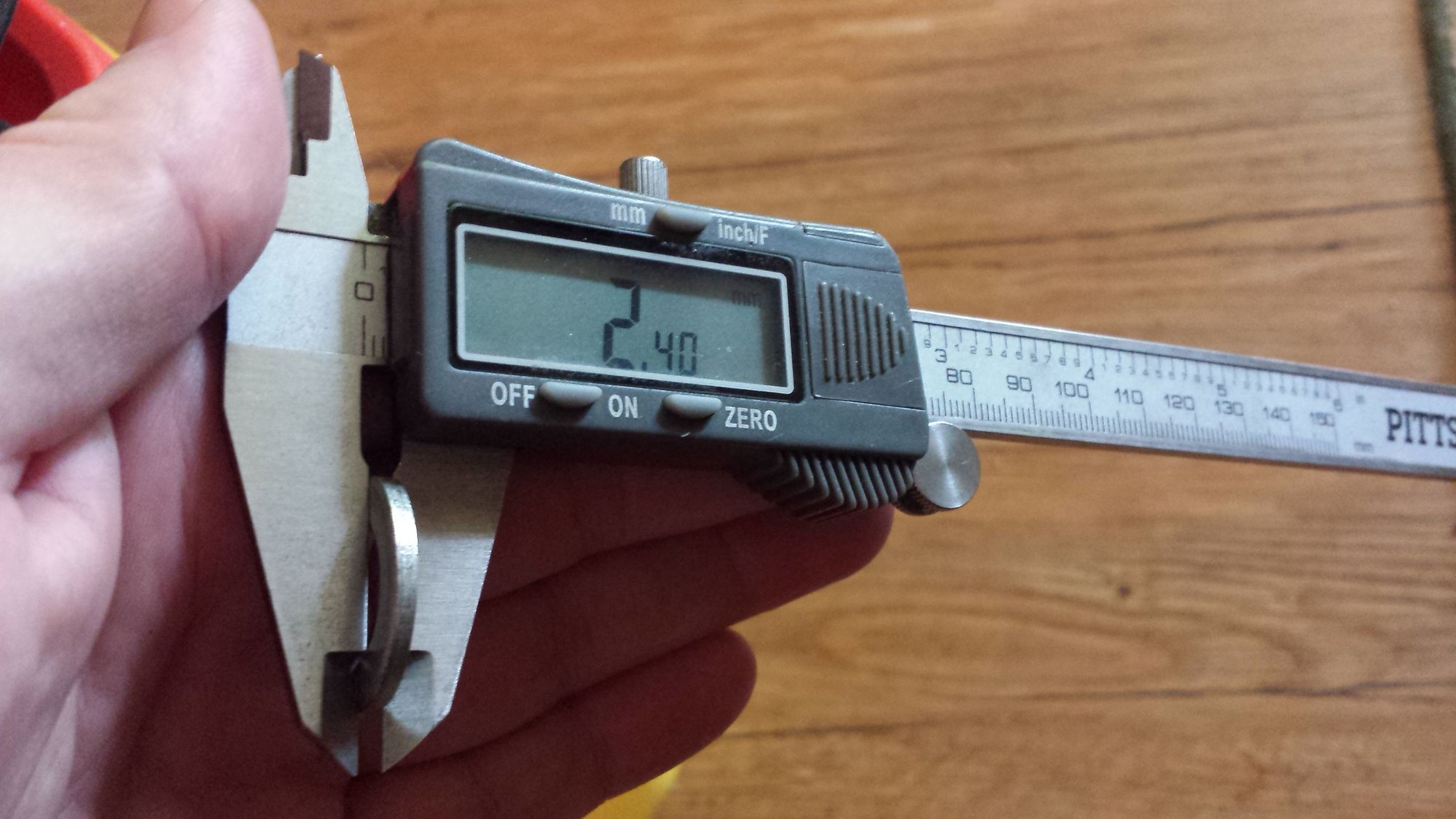

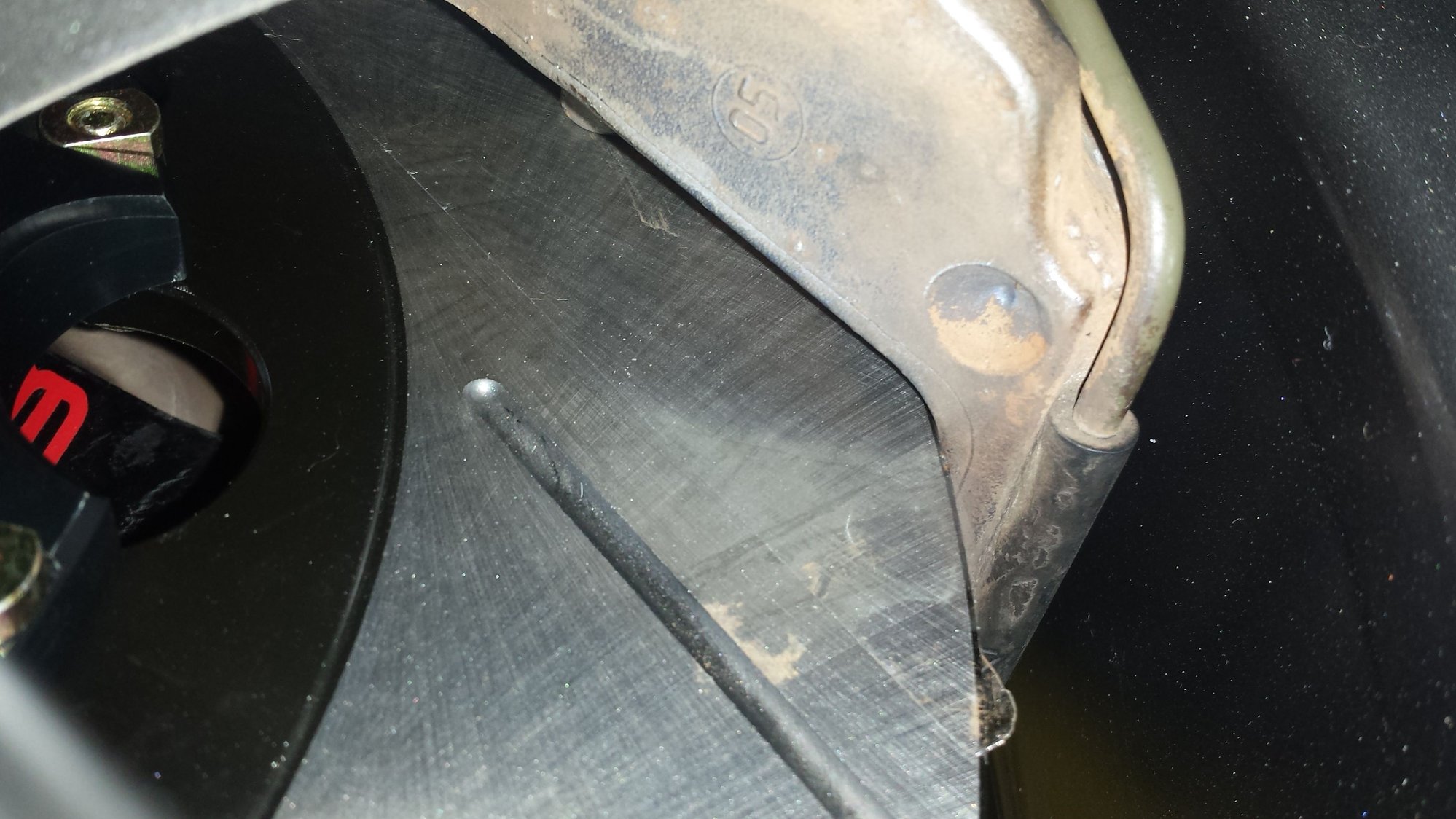

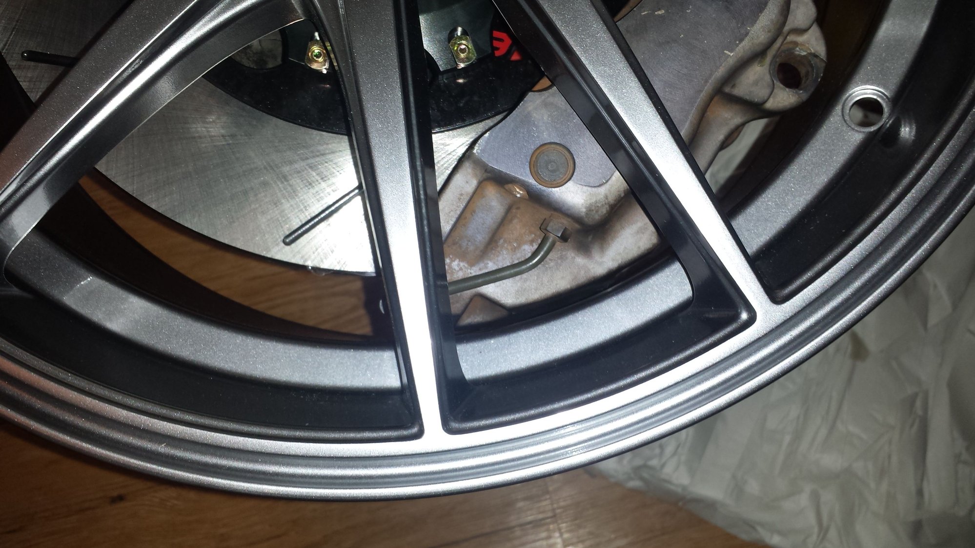

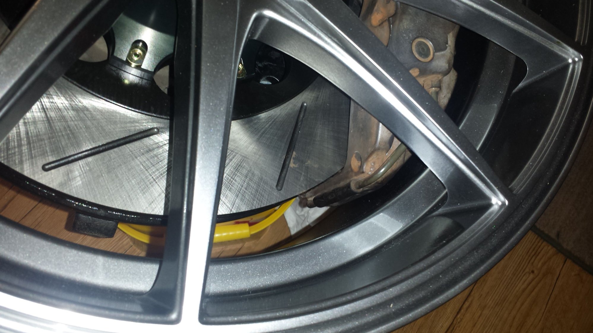

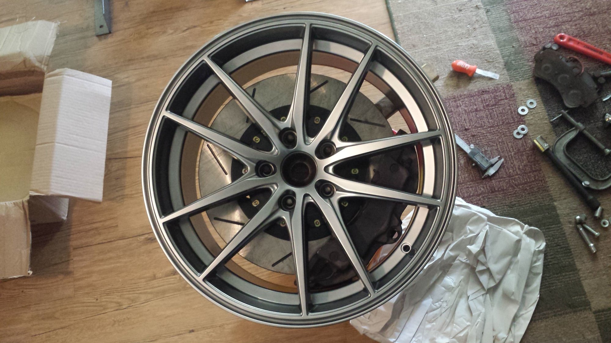

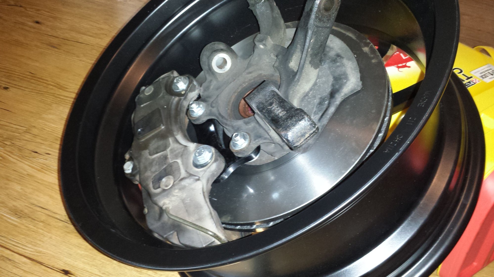

The washers I used to test fit the wheel with the caliper bolted to the knuckle:
It barely cleared, but not everything is exactly lined up and final at this point. The question now is should I run a 3mm, or 5mm spacer...
5mm spacers (2 washers) between the knuckle and caliper tabs to center the disc. I could theoretically grind down the outer pad protrusion thingy (up top, inside with the disc) and push the caliper medially another 1mm without any problems. This disc is also 28mm wide, whereas the 2-piece rotor is 32mm wide:
All the hardware used to mock everything up was just spare parts for the sole purpose of getting an eyeball on everything. I presume some dimensional changes will occur with proper hardware, but not to any detriment to proceeding with the project.
I think I will source 6mm mounting spacers, grind the inner pad sliders 1mm, and run a 3mm wheel spacer. This would give me 3-4mm caliper to wheel clearance.

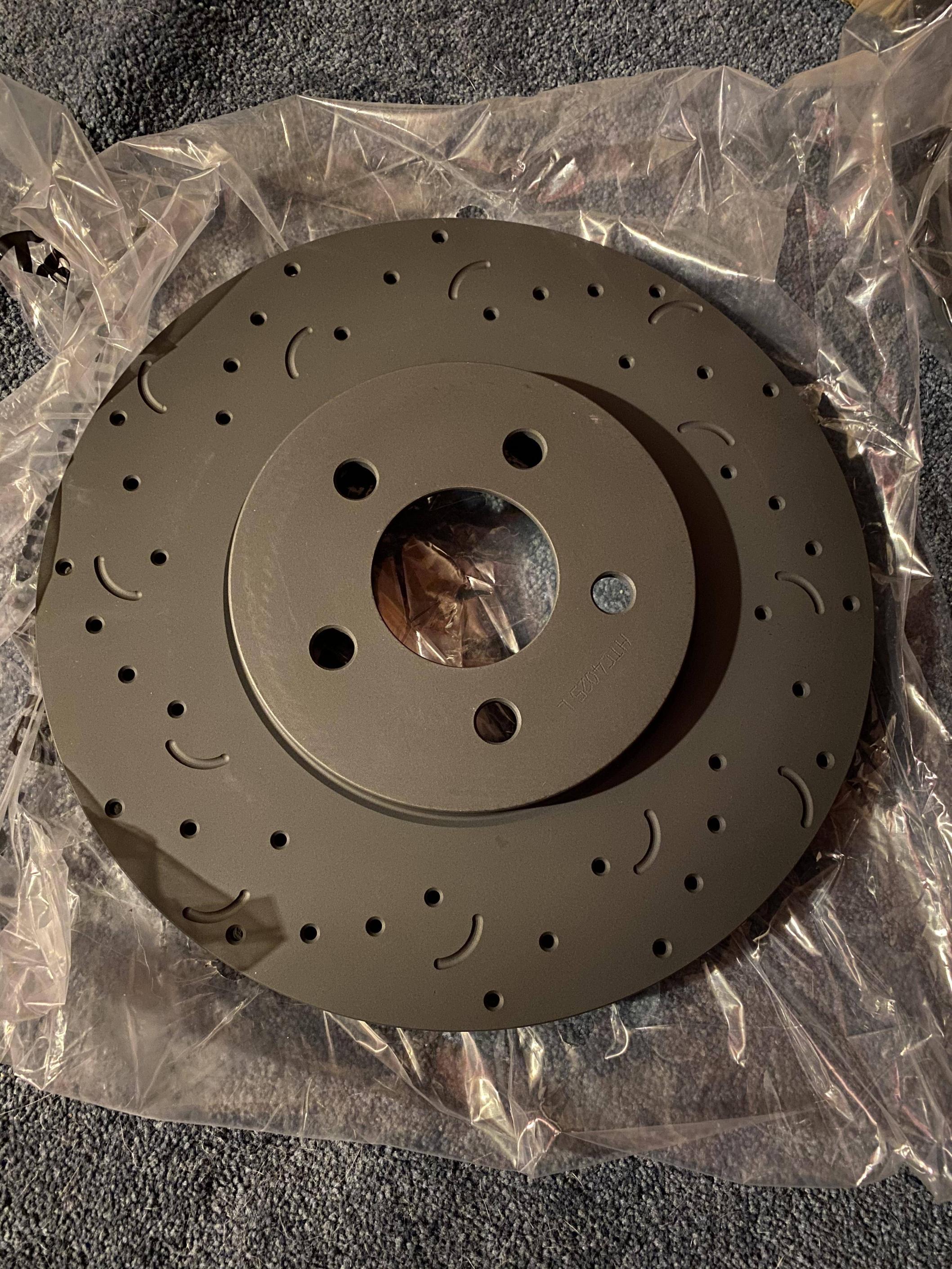

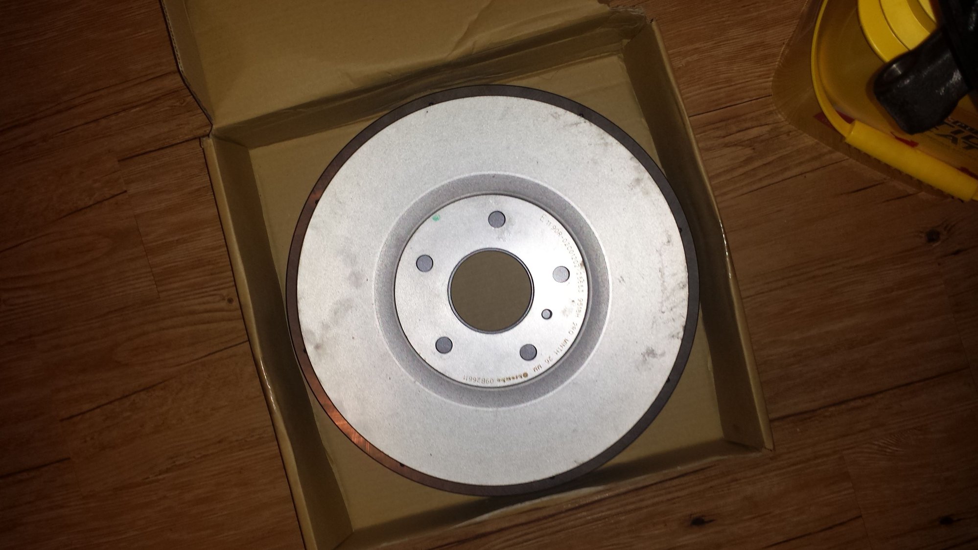

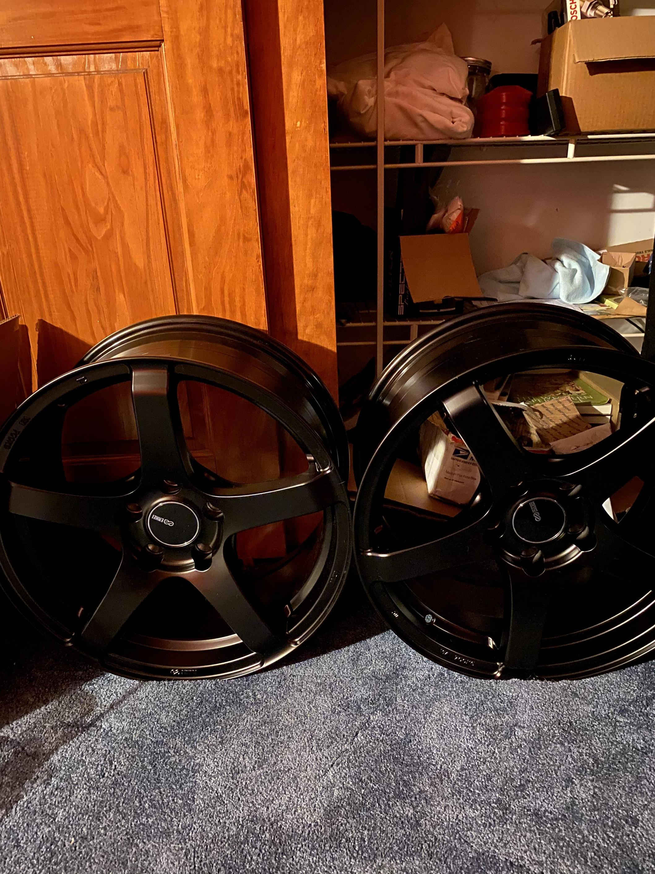

13” Cobra rotors came in the mail today. Ironically, a pair of these ‘fancy’ rotors from Hawk came out to the same price as just one single rotor from the discount brands, since they were on a closeout sale. These rotors are HEAVY. Thankfully all those extra pounds will be negated by the 5lb weight reduction per wheel that Im going to get when I switch from the OEM 17’s to these gorgeous 17x8 Enkei’s:
Enough of my humble bragging though, lol. Im curious what you guys will be doing with brake pads. I have a set of Hawk pads for my Z32 calipers that still have tons of meat on them. As nice as they would pair with the rotors, im actually looking to find pads that are very non-aggressive. The idea is to put crappy pads on the front, and the most aggressive, metal shredding pads known to man on the rear - that way, I wont be messing up the brake bias as drastically. Any suggestions for an aggressive pair of pads to run in the rear? (Edit: so far “EBC Yellow’s” appear to be the most aggressive pads available)

The wheels I got are Enkei Kojins, 17x8 40mm offset and right about 19.5lbs. Im not sure if they would work with the 300zx 13” BBK since I think you need 35mm offset, but since Im running 10mm front / 15mm rear spacers, it wont be an issue for me.

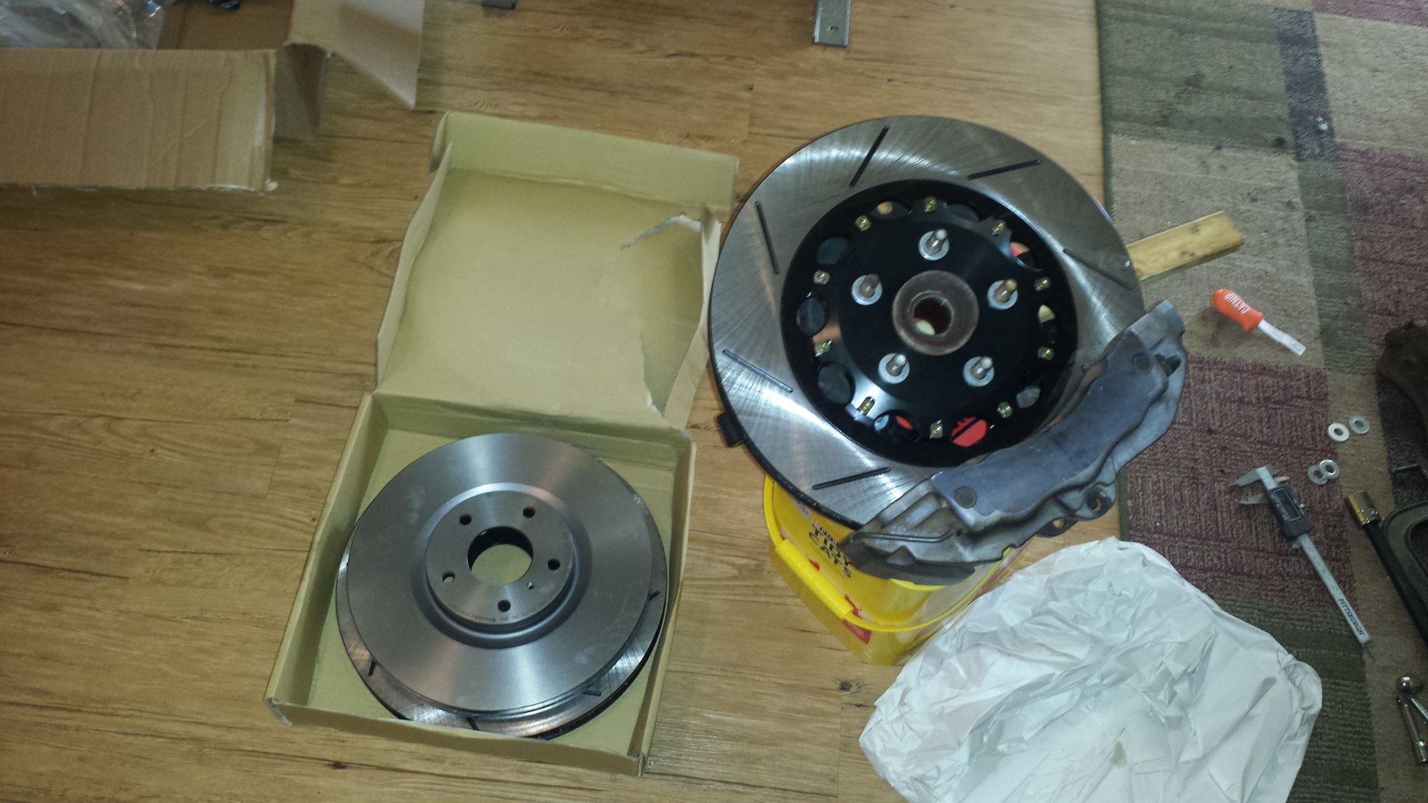

Old Apr 25, 2020 | 05:21 PM
  #99
User1's Avatar
Joined: Jun 2018
Posts: 2,493

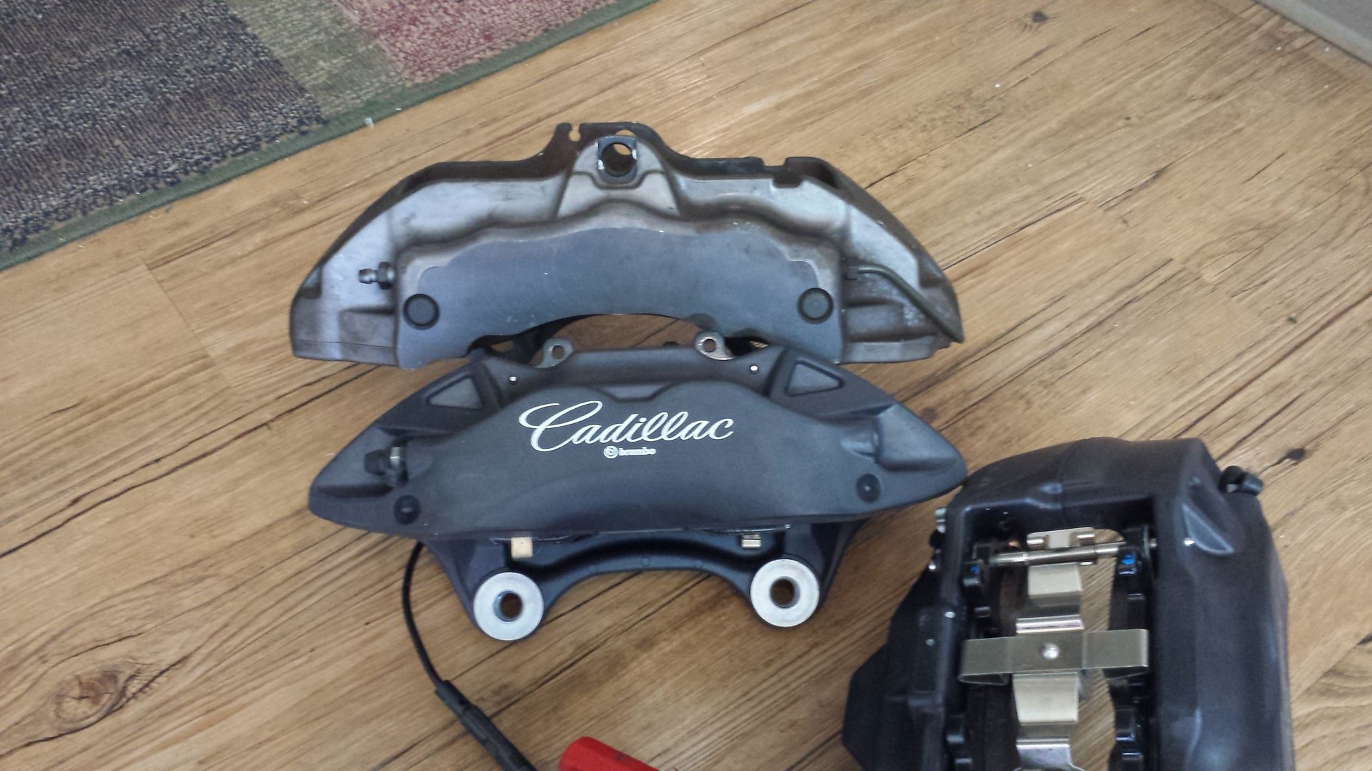

Got some work to do.
Rotors arrived today.
I ordered all the fasteners in the last couple of days. They are slowly starting to filter in. It was really hard to find an M16-1.5 x 50mm bolt for the caliper-to-bracket tabs! 2mm pitch is way more common.

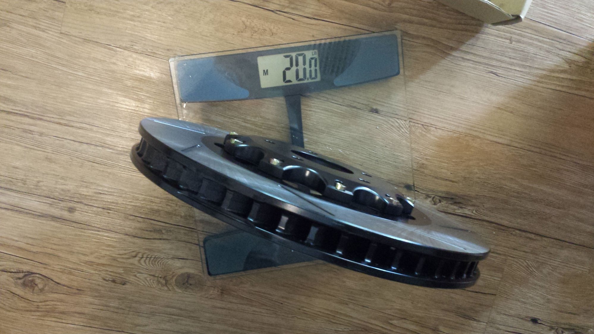

Final weights:
Loaded caliper: 13.5lbs
Tire: 22lbs (235/40R18)
Rotor: 20lbs
Wheel: 20lbs
Total: 75.5lbs
I'll get stock component weights after I get the first side set up.

Picked up some stuff. Decided to grab the blast cabinet and do everything myself rather than take calipers to machine shop guy for sand blasting. New 4 piston rear calipers showed up yesterday. I threw the 14" rotor in and it does indeed fit inside the caliper with 1mm clearance on each side. I may shave the block protrusions a mm or so for peace of mind. All calipers will be refinished the same color. I can go ahead and order the Z1 one-piece 14" front rotor set to run in the rear. It'll work but I'm on my own for caliper brackets. No big deal.

oh, they are cady brembos or someone painted that on there? i liked the dirty sleeper vibe during mock up, i like low key but, ain't no 6 pot fitting fitting in no stock 5th gen 5 spokes.
Old Jun 16, 2020 | 09:16 PM
  #115
User1's Avatar
Joined: Jun 2018
Posts: 2,493
https://www.ebay.com/itm/Cadillac-4-...72.m2749.l2649
