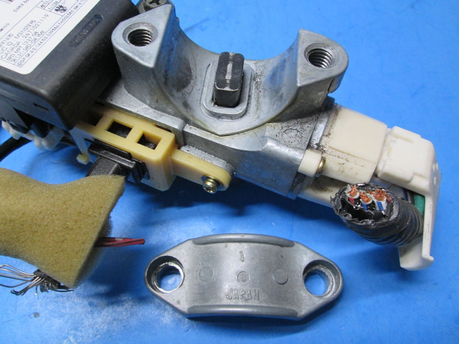

There only two bolts. they need to be drilled out. That is what the punch is for,i use an automatic pressure punch. Because it is IMPOSSIBLE to keep the bit on it without it being punched.
But you Will need to drop the steering wheel ( Very easy like i described in my other post) to get the angle right on the drill.
Once they pop ,the head of the bolt, the yoke comes off and the ignition. Then you just screw the bolts out with your fingers, a 4 year old could then screw them out.
By the way don't go to deep with the bit, 1/4 at most. If you have to go up to the next size bit.
First picture is the whole ignition assembly.Black thing is immobilizer.
Second is the yoke removed bolts out already.
Third is yoke off with ignition in the background.
This is from an I30 same as your part. It will look the same.

Start taking one car apart to get an idea of what i am talking about. Also in addition to the plastic pieces ,take the knee trim off and the metal shield that protects from impacts.
