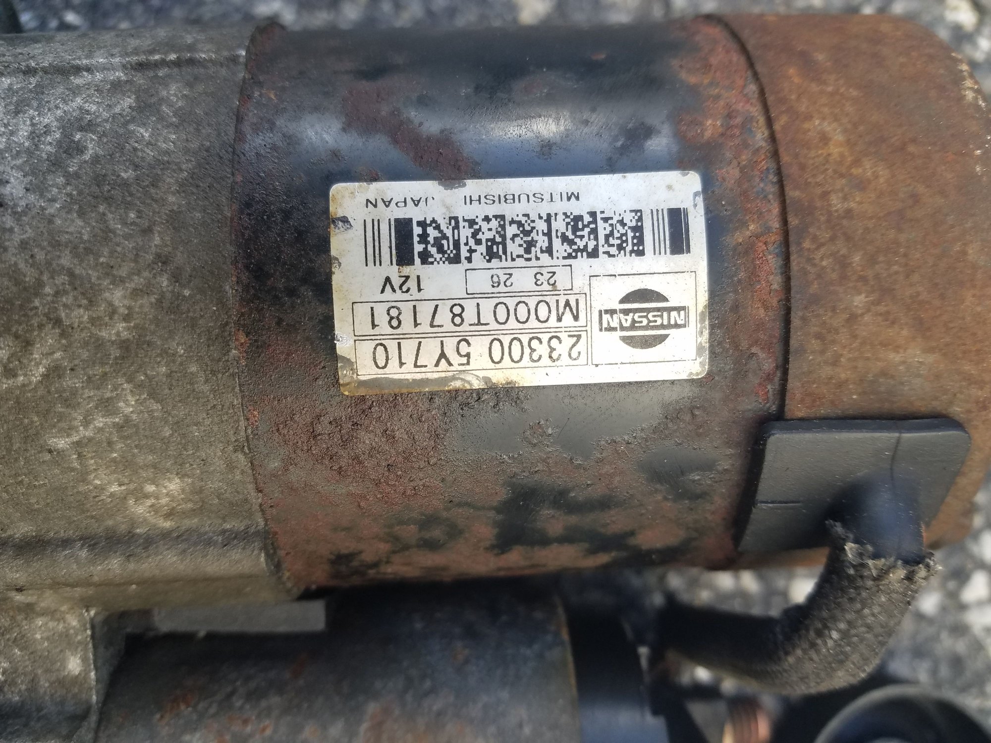

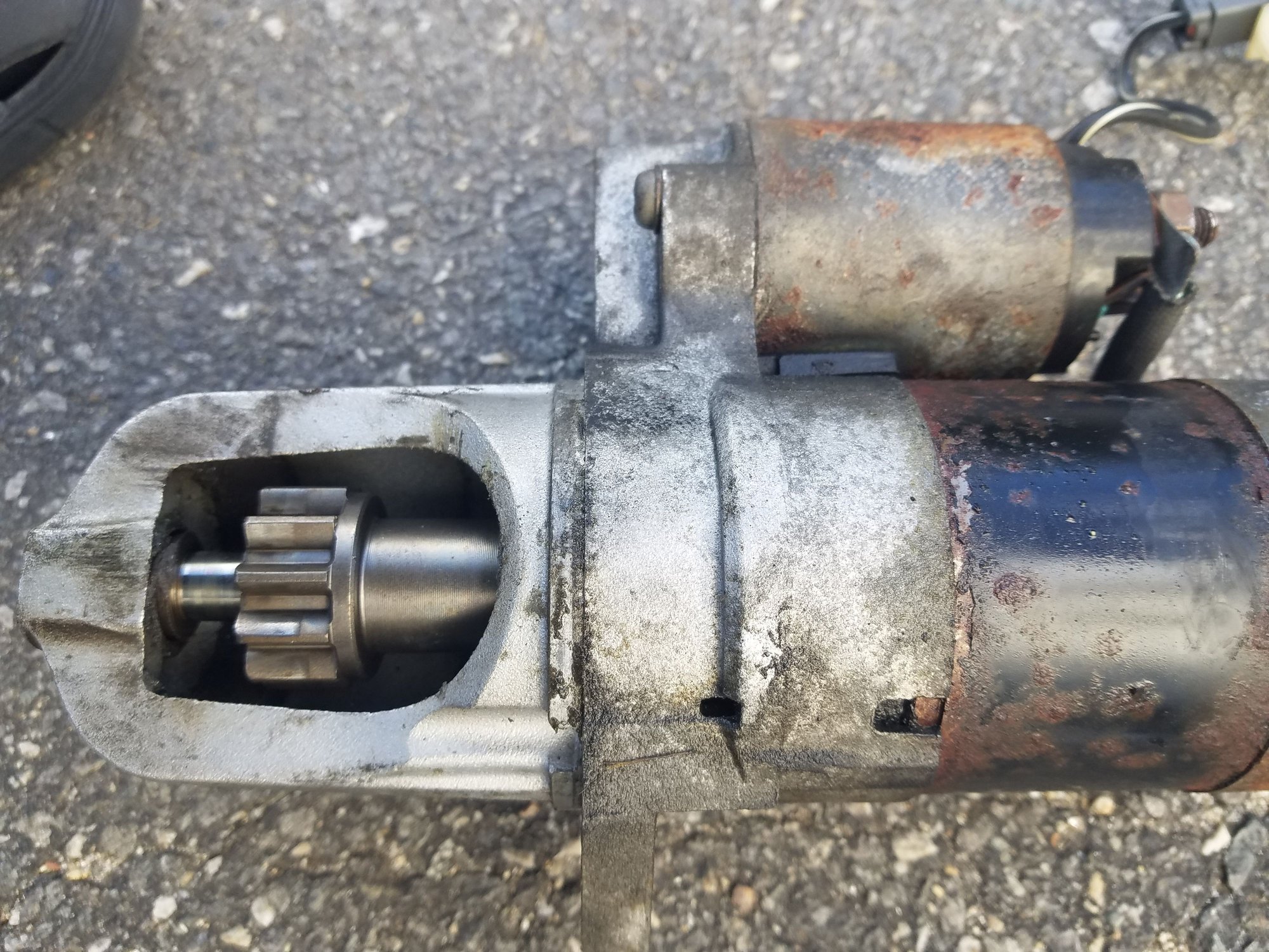

Thanks everyone. It was the starter. Turns over a lot faster too. Looks like it was the original lasted 165k
A look inside.
