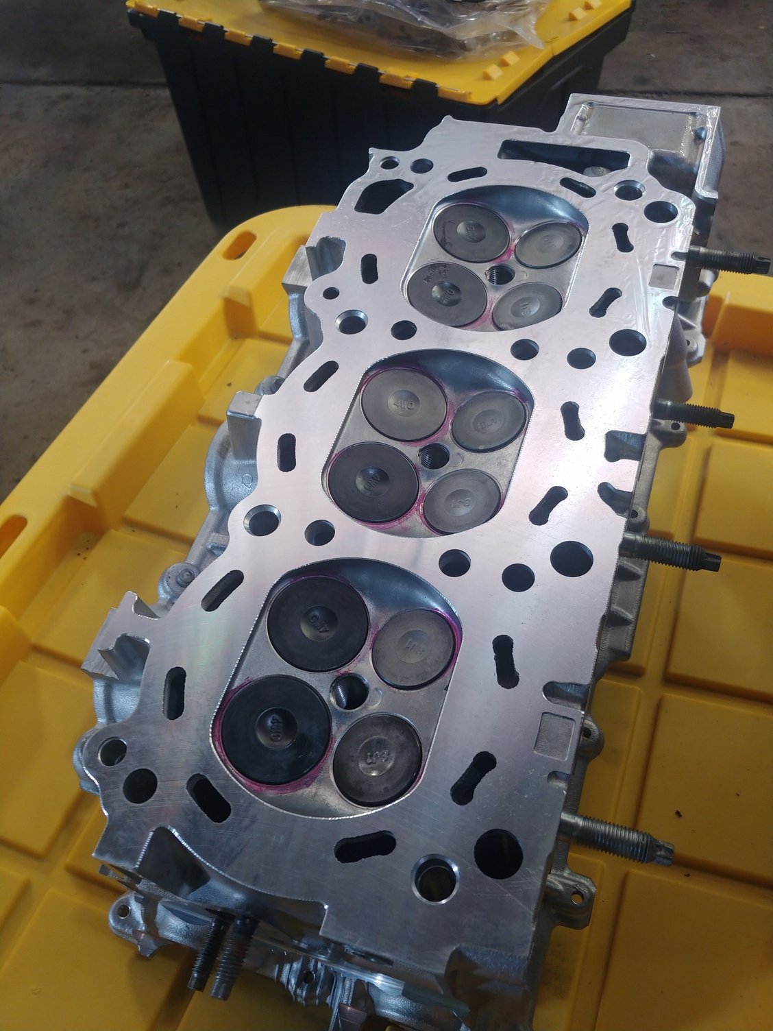

Then to actually add power.....
remove heads and take them to a machine shop and have them....
-Install Cams
-Install Valve springs
-Set valve lash
-Valve job
-Hot tank.
-Extremely light mill just to get a fresh even surface
That should be around 1700, but what's needed to crank out well over 300whp.

Just to have a fresh surface.
​​​​​​10 thou is what i did once before and timing was off by I think a degree between the two intake cams.
Not sure if it was cam related or milling related.
But that motor build caused the internet break and me to get banned from a few fb groups... because someone at a shop somewhere said it was impossible... And well we proved that person wrong 😂
